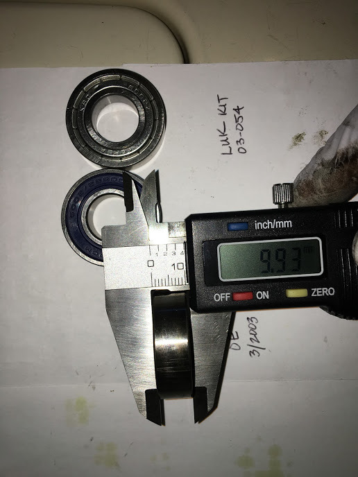

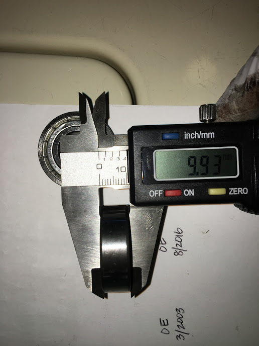

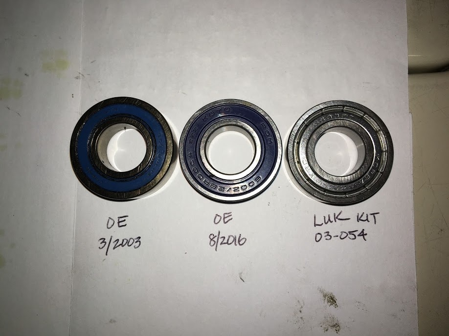

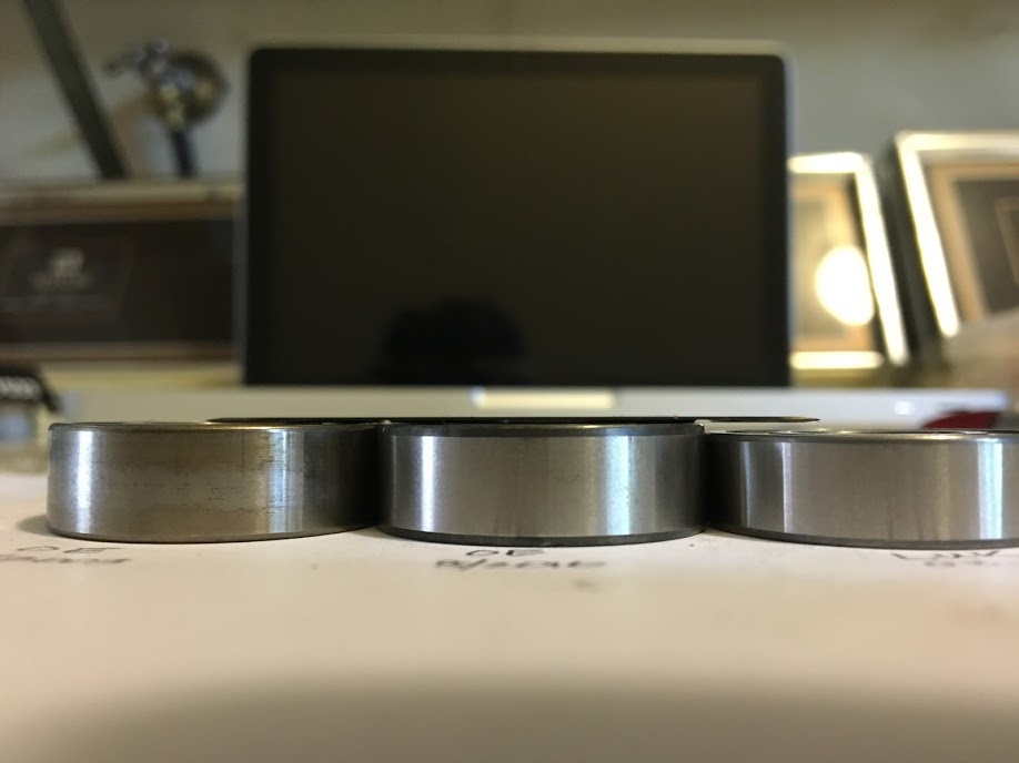

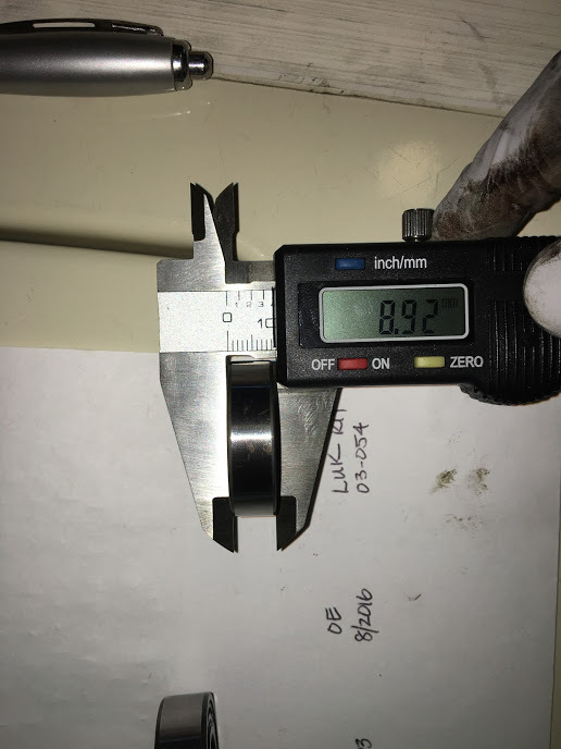

        Since discussion veered towards the pilot bearing, here's some of the findings I had posted on m3f.
        The original OE BMW bearing was from NTN, the OE BMW replacement was from KOYO, the one included in the LUK kit was from KBC.
        Realoem notes the bearing should be 15x32x10 (ID, OD, thickness in mm). The two OE BMW bearings measured approx 10mm thick whereas the KBC was 1mm less.
        Does that 1mm difference matter? I don't know.
        Also, the OE bearings were noticeable smoother. Not that the KBC was not smooth, but the difference was noticeable.
        Again, I went with an OE bearing for peace of mind.

          the thinness is not much of concern, but the actual diameter is the issue. I purchased 3 bearings and all are .001" less than original and slide in perfectly without being pressed in. I looked at NTN today as it is the original, but the one that is not sold by BMW is same messurement as the FAGs and KBC that I have, it is also .001" less in diameter and 1mm thinner. So after a discussion with the bearing master, he said BMW might actually request a special one just for their application. I ordered one for $50 lol and its coming tomorrow morning. We will see

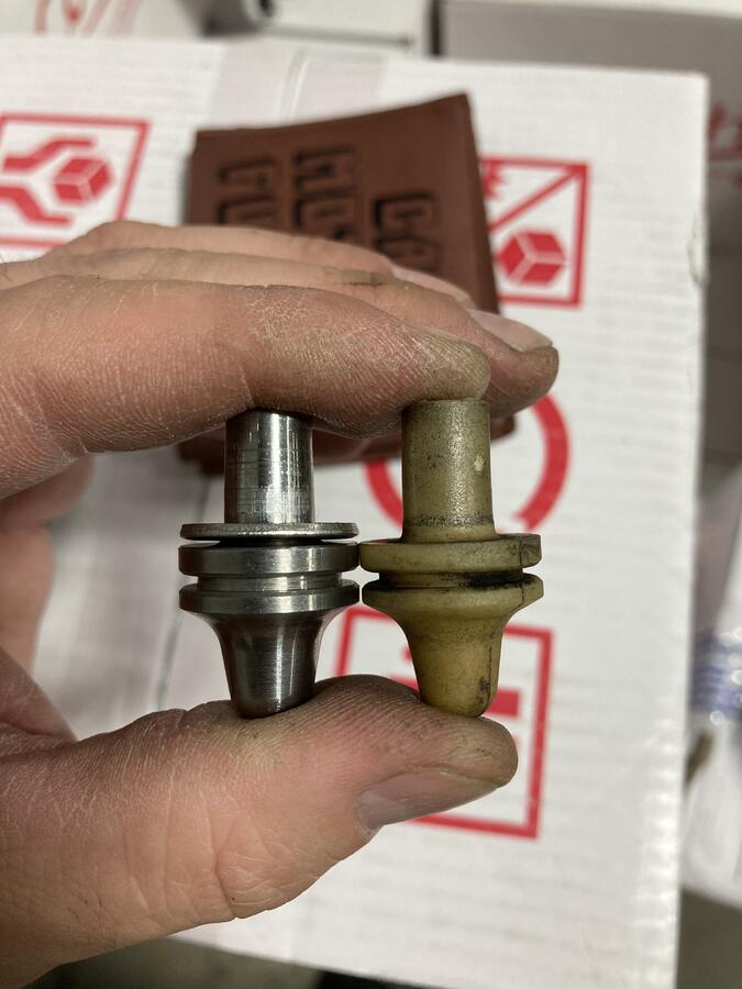

                what do you mean about the PIVOT PIN? i put on the brass one and hammered it in all the way down. is that not correct?

                  You should go with the stainless steel pivot pin instead of brass, I heard brass will wear out with time.
                  You should have measure the pivot pin and put the other one at the same place. It’s not hammer all the way in. Take a look here at my old OEM pivot pin. See there is stain that make a line, it wasn’t hammer all the way down, you can put a washer behind the get the correct spacing. If you hammer it all the way down, you might end up with the clutch slave pin dropping into the bellhousing and oil all over the clutch/bellhousing. Ask me how I know...
                    ahh I see, Ill look at it right now.. thanks for the tip. as for the brass, its a little late for that now, I should have just got the BMW SS from the 850ci they used it in.. the trany is going in asap and from what I see, not too many people complain about the brass. I thought of reusing my old since it was still in great shape, Im sure this brass will be better than OEM anyways.

                      I ended up comparing the brass and OE pin, the brass had a thinker ring so it sat at same height as the OE being pressed in down without a washer. As for the Pilot bearing, BMW sold me KOYO which is different dimension from other "OEM" aka FAG, NTN, KBC... looks like that is BMW only application.
