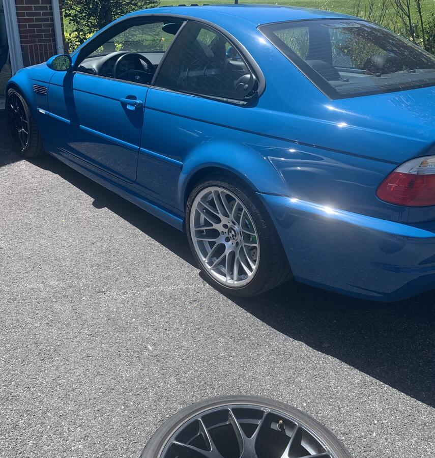

      I got a set of BBS CHRs. Rears are 19x10.5”, the tires I want are Michelin PSS (AS3 no longer available). I think 285s would look nicer than 275s.

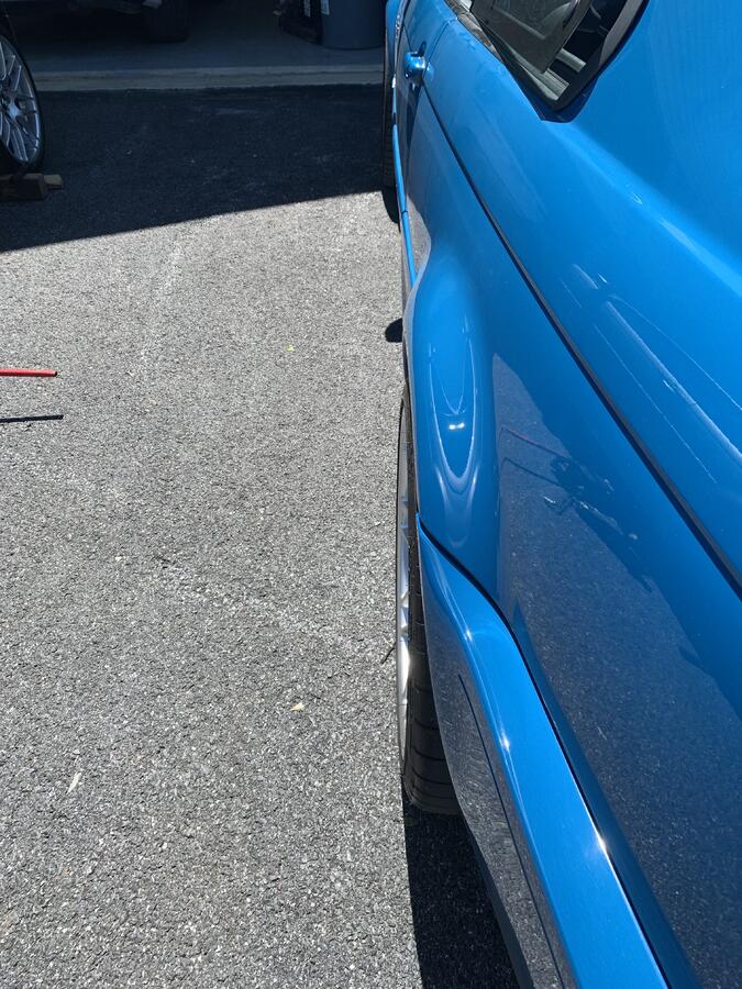

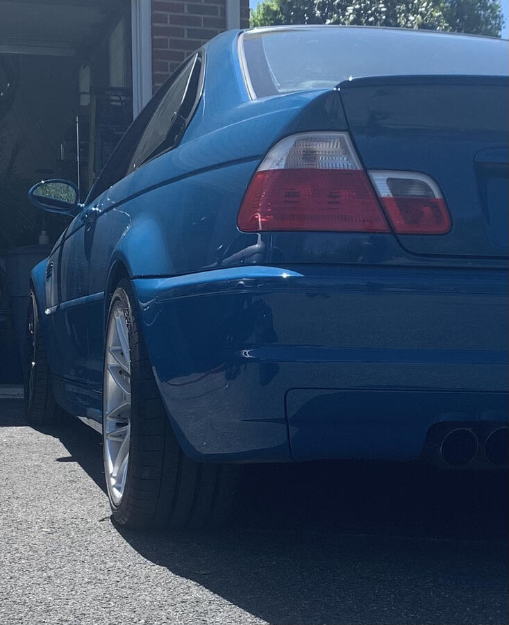

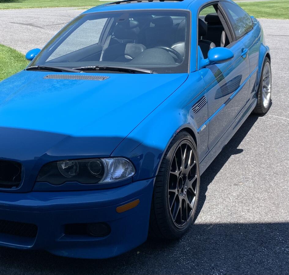

              I have 1.7 degrees now. I test fitted my buddy’s 285s, granted I dialed in the height a bit too much, but they fit just fine. The car is not lowered per se, but my current suspension setup is TCK DA. Wheels in pictures are 19x10 and 25ET. I plan to refinish my BBS in silver.

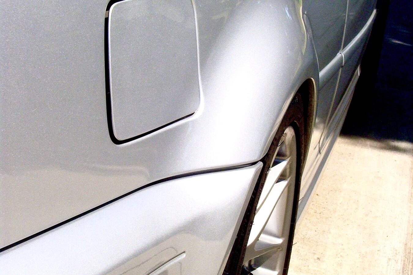

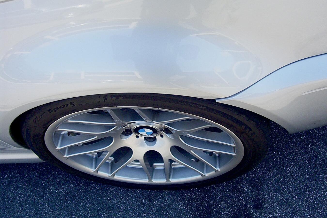

                          Sure. The wheel in picture is 19x10 ET25. Tire is Michelin PSS 285/30/19.
