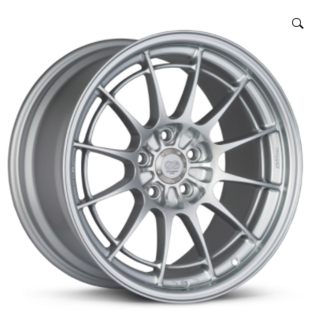

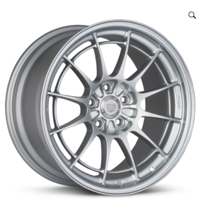

                              Perfect timing for this thread. My wheels arrived today and havent pulled trigged on tires due to not knowing correct sizing going from 19" OEM to 18" aftermarket
                              I bought Enkei NT03+M
                              18x8.5 in front
                              18x10 in rear
                              Looking at Michelin Pilot Sport 4S for this.
                              Sounds like Ill be going the 245/275 route.
