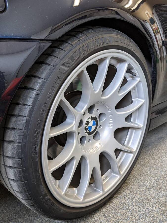

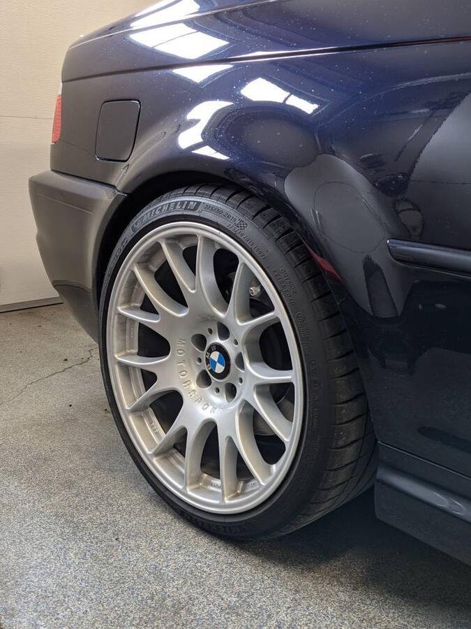

    So here is the setup of my car to give you guys some background info...
    Wheels - BBS-CH
    Front - 19x8.5 ET20 (245/35/19)
    Rear - 19x10 ET20 (275/30/19)
    Michelin PS4's
    Coilovers - TCKline SA

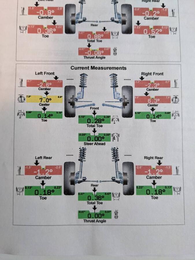

    So the shop that was performing the alignment on my car basically had to set the ride height to stock because the rears are rubbing (right rear particularly). I will post a pic of the alignment specs but I'm not sure now what to do...
    Roll fenders?
    Mill the hubs of the wheels?
    Get new wheels?
    Increase more negative camber slightly? It seems like I could increase it more??
    I don't like the rake look of the car and I love the look of these wheels and don't want to go through the hassle of getting a new set. I don't even want to drive the car because any slight bump and I hear the noise of death back there. If you guys have any suggestions that would be much appreciated! I can post pics of the car too if you guys want.

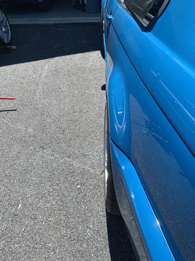

            Where the wheels tucked under fenders? I have TCK DAs, but I prefer a stock-ish height. I tested fitted 285s last weekend and they fit flush on a 19x10 et25 285/30/19. Same rear camber numbers.

                  Thanks everyone for the replies. I talked to my indy mechanic today and he suggested to mill the wheels by 5mm. That would be the cheapest option and then try to increase my rear camber slightly. For some reason my rear camber is apparently maxed out on my stock arms. Even he was shocked and didn't know why. He said I should be able to get to 1.8-2 degrees no problem back there

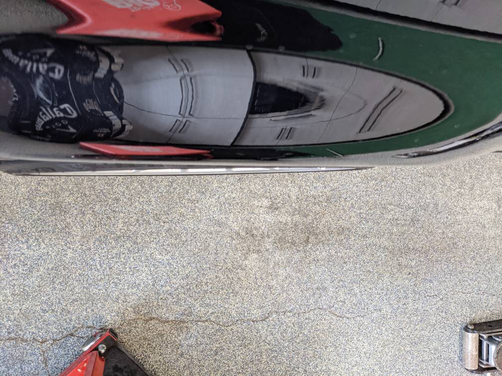

                  Here are some pics if anyone is interested

                      The camber being maxed out at -1.2 doesn't seem right, have you had any rear end work done to the vehicle or subframe reinforcement done recently?
                        No subframe work done. Just recently replaced the rear passenger lower control arm because mine was bent and RTAB
