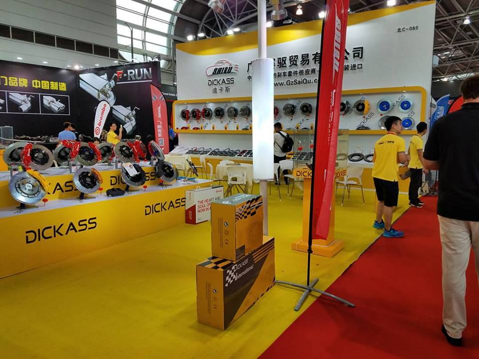

                      There's a company in China called "Dickass" brakes that makes a lot of knockoff Brembo BBKs. I wonder if those rotors are a product of this company

                        I would bet money those calipers are counterfeit Brembos.
                          Them dickass rotors are tight.
                          Just some old shitty cars.
                            After buying that BBK from Dickass, that's exactly what you end up with in the end, a Dickass. No freaking way.
                              They appear to be used Porsche Cayenne calipers (which are legit Brembos) that have been powder coated. If you look at the caliper hardware holding the pads in it has some surface corrosion on them because the seller was too cheap to buy new ones. Still somewhat sketchy as I bet the seller only powder coated them and did not rebuild them
