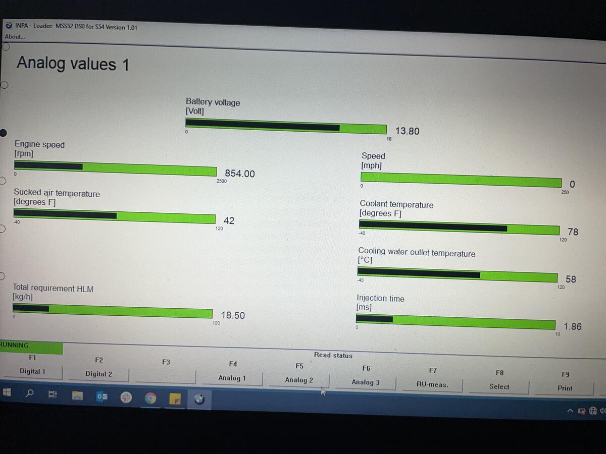

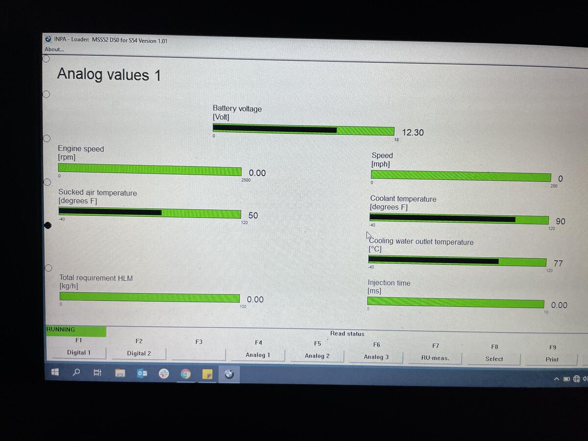

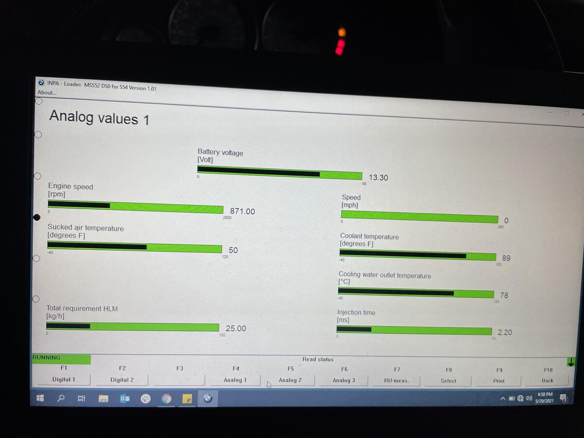

    A couple months ago- the DSC light turned on and wouldnt go back off until i restarted the car. This has since happened several more time in the recent weeks- Along with the car also being completely dead every other time i try to start it (i only drive it about once a week or so). At first i figured it was my 4 year old battery which i have now replaced- and figured that was the obvious cause of my problem. However the car was completely dead today as well. Id figure the next best guess would be the alternator but this was replaced 5 years ago with a bosch part- although i assume i cant rule anything out at this point. Below are my voltage readings (both engine running and off). Any ideas whats causing this?
    13.3v running is low but DME measured could be lower than measured at the battery, and the battery could be discharged too low causing a low charging voltage.
    should have car running for at least 20 minutes, then measure at battery with voltmeter.
    I would charge the battery overnight, the check its voltage after remove the charger and wait 30 minutes.

      Yea the battery was completely dead- i drove around for about 15 min and the readings above are what i got. Ill put a couple more minutes and miles on it tomorrow and see if that changes anything- ill get my hands on a voltmeter and report back- but doubtful i can get a charger

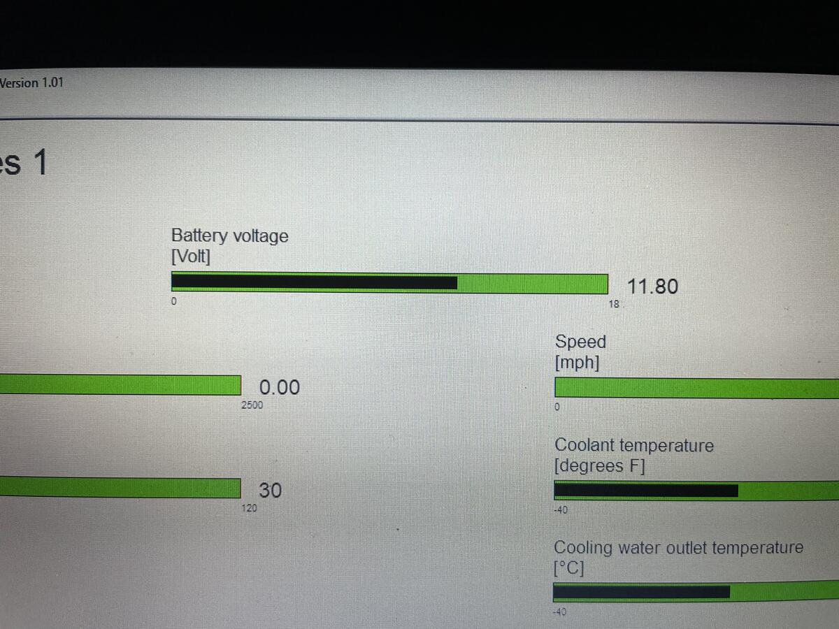

                  Sorry for the late update- below are my readings after driving around for 2+ hours. First pic is before starting, second is with the engine running. A couple anomalies to note that also occurred on the lead up to this issue are that at times in recent months my dash and console lights would flicker if i even just so much as touched the lcm knob, also one day my aftermarket headunit (xtrons) was bugging repeatedly turning itself off and on. This only happened once but i guess the dubious nature of the manufacturer would be enough explanation- i just think its worth mentioning because it happened around the same time my lights were acting up

                      Thanks for catching that- i updated the post with the correct pics
                        The first pic shows 11.8v measured by DME (which means real battery was about 12v), and it was low. You should keep the battery charged up -- 12.6v minimum -- or it will be ruined soon. This also placed a very high load on the alternator when engine first run and charging the low discharged battery, not good for alternator.
                        Second pics with 13.8v which means battery was about 14v. This shows alternator and cable/connector, up to the battery cable but not the battery, are all good. However this doesn't mean the battery was charged at 14v, because the DME only measured the voltage on the cable, regardless if the cable to battery connection was good or not. The sure way is to measure directly on the battery posts using voltmeter.
