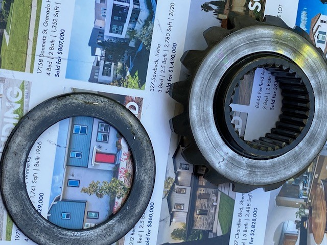

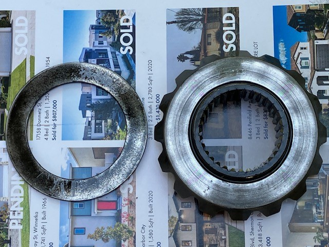

    Here was the cause of my clunk
    Took it all apart and found this surprise

          Shims with excessive wear in just 60km brand new cars?
          Below are the pics of the said shim and the bearing side of the corresponding side-gear from my old Diff to show the wear on the parts is minimal -- barely and not even uniformly over the entire surface of the shim or the side gear.
