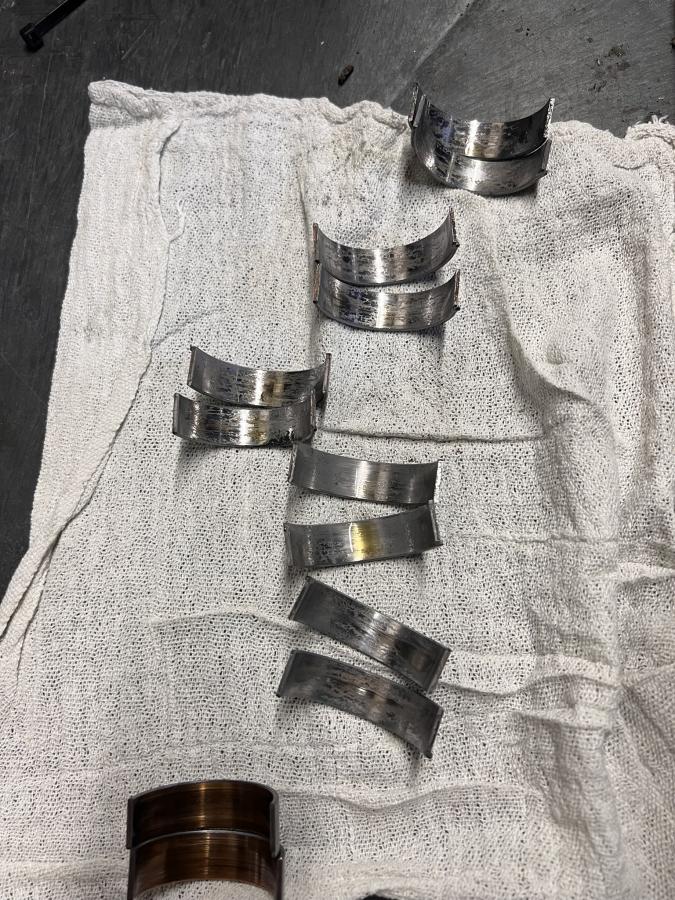

    Originally posted by BRiley View Post
    Funny how this looks exactly like my BE bearings. Such a coincidence. Where did you send them for investigation? BE?
    The shop that replaced them is working with Bimmerworld to determine next steps. The shop's main concern is getting reimbursed, since they warrantied my repair. Bimmerworld will then go back to BE I assume. I have a good relationship with the shop, so i'll message them in a week or so to see what they did.

  • BRiley
    replied
    Here is mine for comparison.

    replied
    Originally posted by Andratch View Post
    !! BIG UPDATE !!
    Click image for larger version Name:	IMG_5821.jpg Views:	8 Size:	124.8 KB ID:	283073
    New WPS bearings going in, and sending the BE's back for investigation.

    I initially changed the bearings because I knew they were original, and was not sure of their condition (52k miles). It was part of the baselining of the car. The original bearings that came out were actually in nice shape, with predictable but relatively minor wear.
    BimmerWorld did not say there was an active recall in place for BE, they just said they were in early stages of investigating a higher than average number of failures from a specific batch. That said, there's no hiding that my new bearings were TRASHED in just a few hundred miles.
    Another potential factor is that the shop that changed my bearings told me that "there is no wear in process" - so after a couple hundred miles of light load driving, I had a HPDE scheduled and I used the car in the HPDE. The WPS bearings that are in it now will get babied for the first 1k miles, all below 5k rpm.
    With that in mind, I suspect the problem in my case was one of these two:
    1) Issue with the bearings themselves, based on BimmerWorld's comment that the specific batch of BE bearings was showing higher than normal warranty returns for spun bearings very shortly after installation
    2) Issue with the installation / torquing sequence of the bolts. The shop that installed them normally uses ARP bolts, not OEM, and may not have followed the proper torquing sequence for OEM bolts. This could be exacerbated by the HPDE.
    I'm not sure which.

    Hey everyone, just wanted to follow up on this after a week of cold starts, driving and listening for the noise.
    The cold start rattle is totally gone. Definitely 100% resolved by addressing the rod bearings. Glad to see some others have been able to save their engines from this too!
