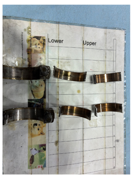

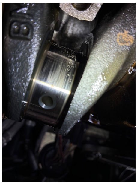

  • sapote
    replied
    Originally posted by r3_galek View Post
    will send an update if the rattle has been fixed.
    #2 bearing just shows copper so I don't think the rod bearings condition is the cause for the rattle noise.
    As about the chain cut on the oil pump intake tube, the engineers did a bad job design the tube as they have been in the business long enough to foreseen this, and reshape the tube away from the oscillating chain.

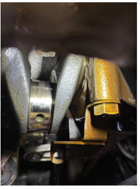

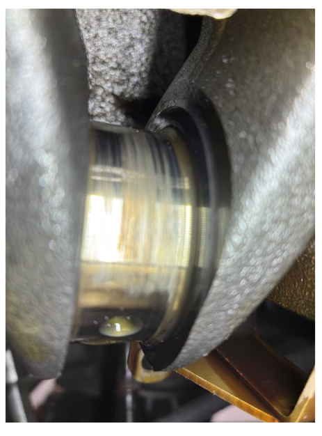

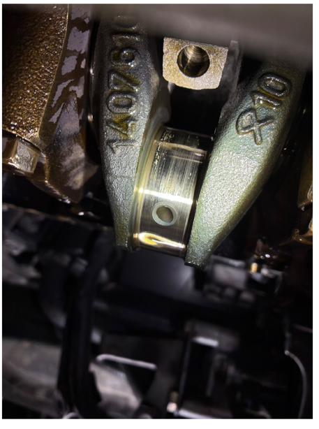

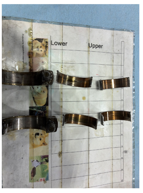

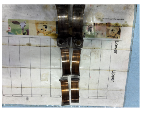

  • r3_galek
    replied
    Hi everyone, I’ve just done my rod bearings and found 2 things that could’ve been the sound. Cylinders 2 was quite worn as also copper was visible on 5, so it could’ve been the bearings knocking on startup potentially? Other thing I noticed was the cut on the oil pump from the oil pump chain, I’ve added an extra leaf spring from a new tensioner as don’t fancy taking the engine apart yet to replace the tensioner and likely stretched chain.
    Crank also seems fine, measured with plastiguage and all within spec.
    I’ve not started the engine up yet as I’m waiting on a few bits I found whilst taking it apart like, wishbone that was finished, water pump had a little play etc. So hopefully can get it running this weekend so will send an update if the rattle has been fixed.
    Leave a comment:
  • sapote
    replied
    Originally posted by Josep_BP View Post
    . The noise was like two pieces of metal rubbing together.
    This is no good for the crank journals -- no damages on them?
    Leave a comment:
