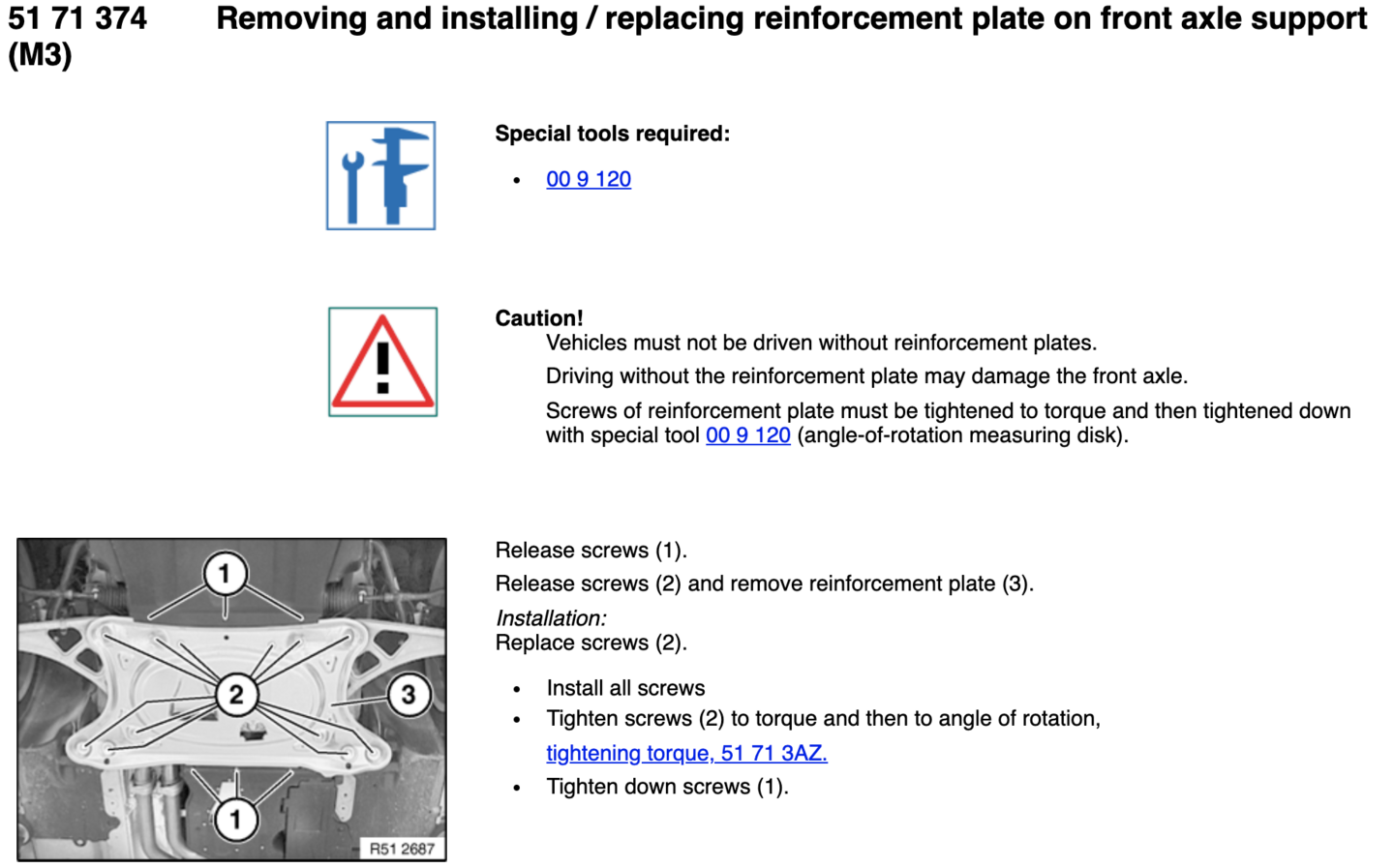

          I don’t see it explicitly stated in TIS. Only thing it seems to mention is not to drive without the brace. I’ve always installed it with the suspension unloaded. The other stuff you mention being different (though in the case of rtabs and inner bushings, if you replace with a ball joint, it doesn’t matter)
            I don't see it in TIS either.

            None of the bolt holes are slotted, so if there was any significant movement in the chassis/subframe/control arms/FCABs with the suspension unloaded, then the plate would be really hard to refit, no?
              This was my first thought. Everything lines up perfectly whether loaded/unloaded.
                Hmm. I swear I saw it in the TIS, but that’s pretty irrefutable.
