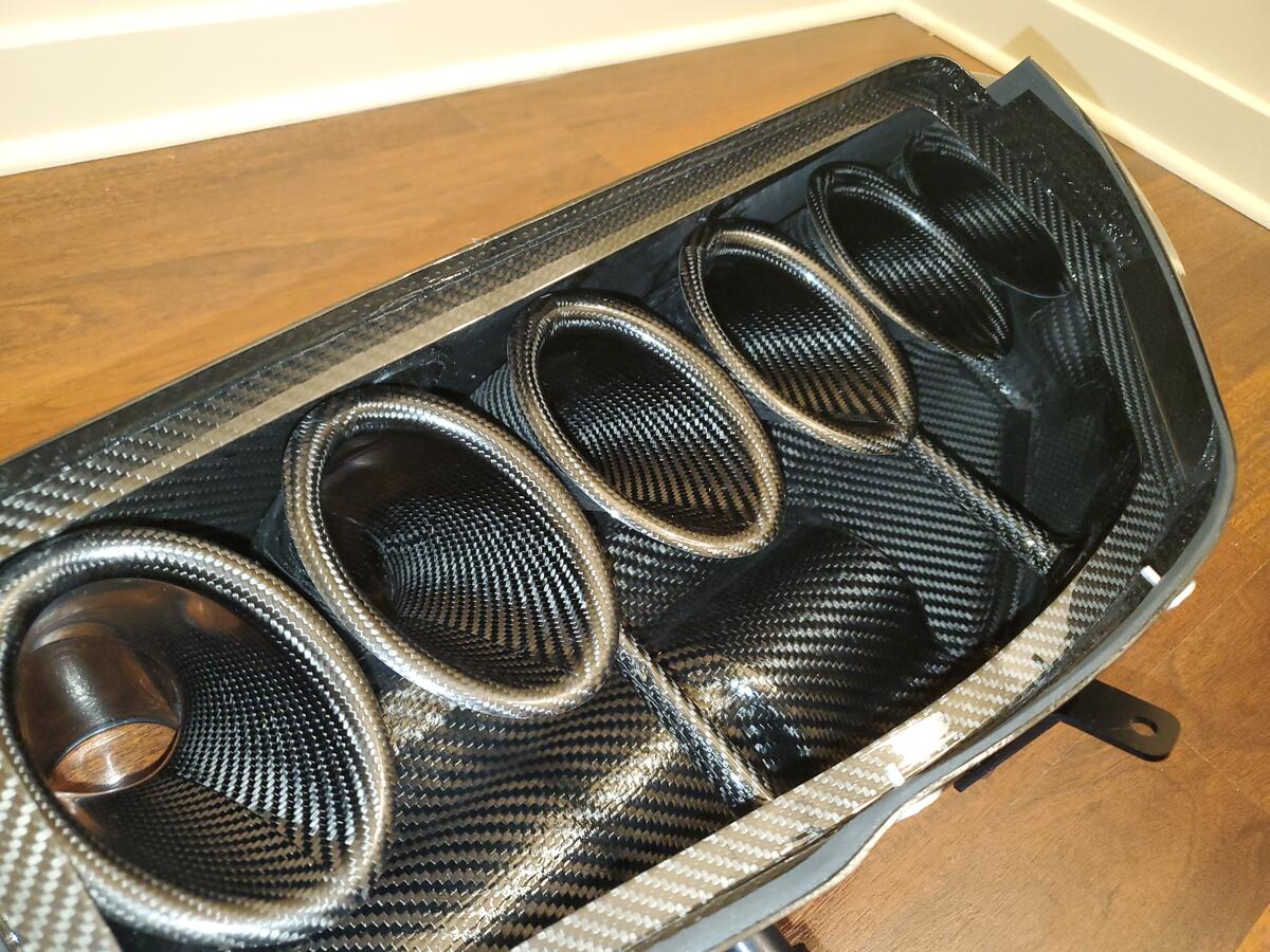

            Looking at photos from ECS, it looks like the Race Airbox only has 4 trumpets:
            Also, it does look like it has a snorkel attachment to the CSL bumper.
              The other two trumpets are hidden behind the cf from that angle:
