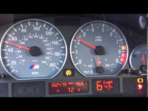

                    It's almost always a tuning issue. With the PCS CSL tune, you can floor it in fourth gear at 2000 rpm and the motor will pull smoothly all the way to redline. Having that bucking issue is unacceptable and drivability should be the same as with the stock airbox. If the car in stock form did not have the bucking issue, it should not have it with the CSL setup. If it did that even slightly, there is a hardware issue.
                    Here is a car with a CSL airbox, 288/280 cams being floored in 6th gear at 1800 rpm:
