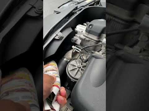

                    3) At 97C, roll up some paper use it to stop the clutch fan blades by touching it on the rear side. Take a video.

                            3. Rolled up newspaper could not stop the mechanical fan with coolant temp at 97C. It started to shred the end. Video attached
                              Video seemed to have issues uploading. Here it is on YouTube: https://youtu.be/ITb3pH_bXHg
