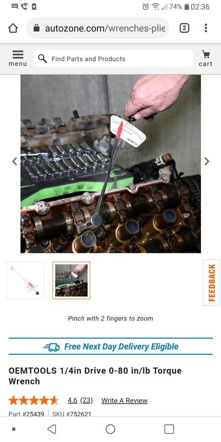

        Basically, I followed the Racing Diffs video as a reference just to make sure everything looked right but not really to the detail. I don't like some of the things they did. I did have to beat one of the output flanges in though. One thing I relied on was my own knowledge of rebuilding diffs and even then I had a panic moment. Your friend needs one of these. The AutoZone pic has an S54 😀
        Click image for larger version  Name:	Screenshot_2021-07-24-02-36-10.png Views:	0 Size:	359.1 KB ID:	116728
        For turning torque, not static torque.
