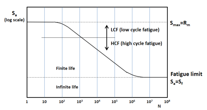

                It has nothing to do with abuse, and everything to do with resonance. You will hear about guys saying "I thrash the hell out of my car and my tabs were fine with 200k track miles!". Well the resonance on this engine is right around 2500-3000RPM, which is where the engine sits at highway speeds or gentle city driving speeds. That's where the rattle is the worst. If you constantly vary the RPM or run at high RPM's, the tabs probably last forever because it doesn't spend a lot of time banging back and forth. Every time the tab smacks the oil pump disk you get a sudden spike of force due to the rapid deceleration. This is a classic high cycle fatigue failure.
                This is further substantiated by the S50 using the same oil pump drive design but smaller holes from the factory. No history of failures.
                By reducing the stress on the tabs we can bring the hub into the "infinite life" portion of the S-N curve.

                    Infinite life. Let me vibrate at that rate and have infinite life. Better yet, let me shake my Pringles can at that rate also, maybe I'll have infinite Pringles.
                      Well I guess there we have it, cobra has singlehandedly solved this riddle.
                      Mods, lock the thread.
                      I'm convinced. Graphs never lie.
