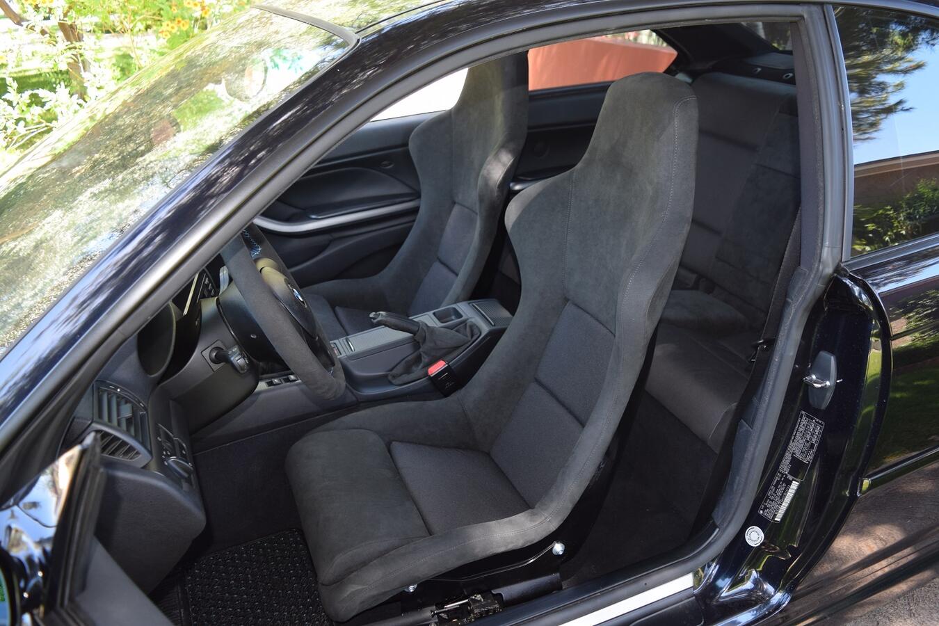

              FWIW I had a set of Cobra Nogaro streets re-covered to use a similar material to the OE.. They're close enough for me.

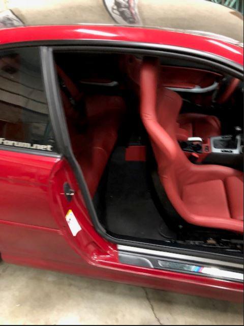

                  I had a set of the CSL mounts briefly. The back seat access gain is not that significant compared to my current setup (nogaro on stock sliders), because the CSL seats still can't bend at the middle. If you tilt a tilt stock M3 seat forward without using the bend portion of the function, you'll see what I mean-- the roof rapidly becomes a restriction. Then, on the flip side, those mounts cause the seats to be mounted much higher (which is why I didn't end up using them).
                  Current setup, without the tilt forward:
                  Click image for larger version  Name:	1556273147_unadjustednonraw_thumb_20953_mmthumb.jpg Views:	0 Size:	36.1 KB ID:	119078
                    The back seat access gain is not that significant compared to my current setup (nogaro on stock sliders), because the CSL seats still can't bend at the middle.]
                    tbh i don't consider either setup or any one piece passenger seat to be a particularly functional choice for a vehicle where you want to use the back seat. but at least the CSL seat with the tilt function means you could load something like a clothes hamper in there without having to rotate it at a funny angle.

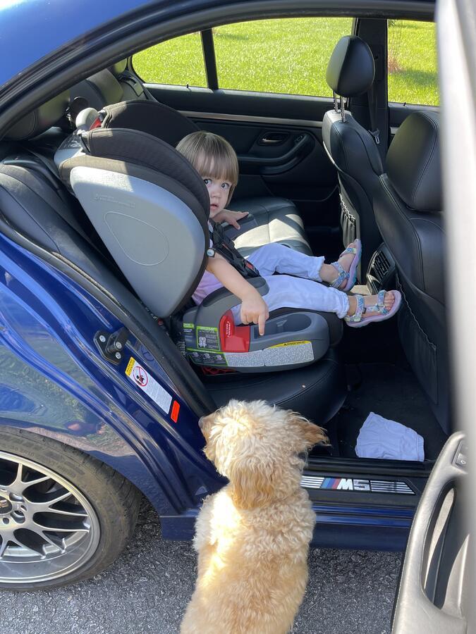

                      I just need enough back seat access for her to be able to get in, once she can buckle herself.
                      which, since my wife can do it if not wearing a skirt, should be fine for years to come.
                        Nice, they look really good without all the busy stitching

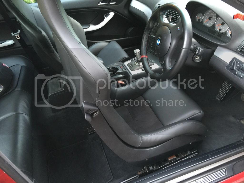

                          Just got posted in another thread, but relevant here...
                          Here's how much space the fold forward of the CSL buckets adds:

                              you can also see in the CSL bucket how much flatter the shoulder bolstering is compared to most aftermarket buckets
