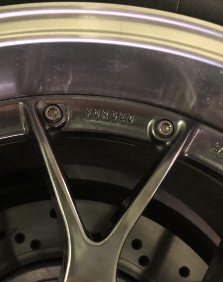

        Apex’s are nowhere near as strong as BBS’s.
        Even there forged wheels?
          #64
          Forged wheels where?
          All forging is not the same.
            #65
            Yes, even their forged wheels.

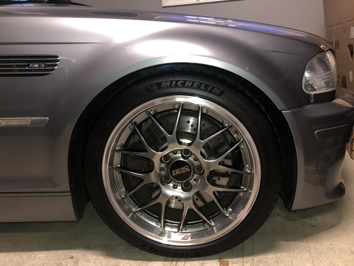

              I went from 19” csl reps to 18” BBS RS-GT, which are forged and use titanium hardware. I couldn’t believe the weight difference when I was switching them out. These are 8.5” ET38 and 9.5” ET22, so they fit nice without spacers. I wouldn’t mind few more millimeters offset, especially up front with the free camber mod tucking them a little extra.
              Frankly, I was also expecting a big change in ride stiffness/comfort changing to 18s but it was not very dramatic, I guess due to the ps4s stiffness.
              On the looks, sure the CSLs rule but the period correct, motorsports look of these has grown on me. Only problem is the clear coat on the brushed barrels is starting to peel so I need to decide between polishing or trying to restore the brushed look

                  I'm not very good at this, but I think 8.5'' +38 is the same fit regarding fender 'flushness' as my 9'' +31?
                  and my 10'' +25 would actually have a little more room than your 9.5'' +22?
                  The more I look into the BBS option, the more I don't like size options. The GT4s seem to need a hub ring so that's a no-go. These RS-GTs might get the offset right, and look the part, but I really like the fit of my 255/275 on 9'' and 10'' wheels.
                    #69
                    Opposite. A 9et31 would be a half inch further out at the fender than an 8.5et38.
                    You'd put a 5-10mm spacer on an 8.5et38 wheel to get it to look similar to a 9" et31.
                    There's a 6.35mm or 1/4" difference at the fender between 8.5 and 9" wheels (or any 1/2" diff wheelset). BUT, you do have to take the tire into consideration. If it's the same tire, it'll be stretched a little more and clear a little easier on the wider wheel. Also, a wider wheel will come into the well more and possibly touch the springs, esp progressive springs (tho that's not an issue on 9" but 9.5 et22 and greater I believe)
