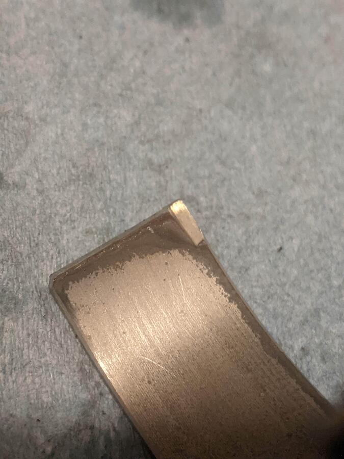

    The outermost layer is a dry lubricant that can practically rub off on your fingers. It's to add additional lubrication on that initial start-up to prevent wearing out the layers beneath. I think it's a dusting of molybdenum disulfide or something.
    The way these are made and transported on conveyors they get little marks like you're seeing and it's normal. I bet even the plastic bag can cause some weird looking marks.
    Dents/nick/scratched you can FEEL with your fingernail are NOT acceptable. In all likelihood they will get flattened out immediately into the soft underlayer, but you paid good money for these they shouldn't have gouges.
    Based on your pics I only see 1 worth returning. In reality I bet they would all work just fine.
    FWIW I purchased all my bearings on their own separate order so that they would be shipped in their own box. I had 2 shipments now from FCP with damaged items because they were banging around loosely in the box. They put some big heavy things in the same box as some delicate things. Kind of a PITA, but they will replace them and ship them quickly too. Good luck.
    Appreciate that insight. Yep, these were in a box with front control arms. Went back through and I've got 5 that are suspect, one of which is the worst. The other 4 have nicks more on the outer edge than anything else, but I can still catch a nail on. I'll reach out to FCP and see if they can make this right. One thing that's odd, is that the BMW boxes themselves weren't damaged on the bearings that have these nicks, so I'm not sure if this is an FCP issue or a BMW issue...

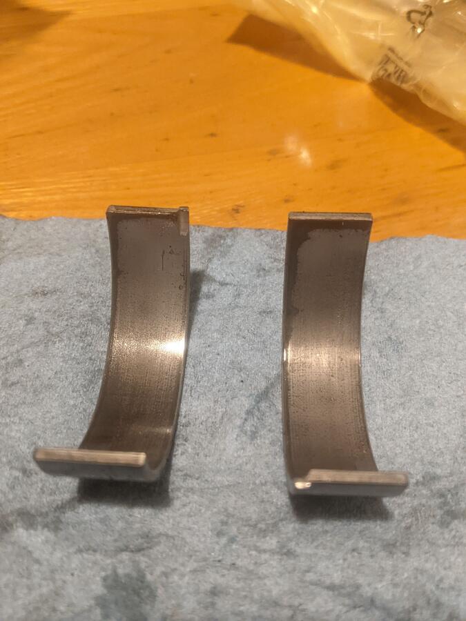

      Another "is this hecked" question, I'm surprised to see what looks like pretty uneven wear on the outside and upper part of some bearing surfaces. Shouldn't the majority of the wear be at the bottom of the "half-pipe"? Not sure what to make of this

        That is a bit odd but I don't know if I'd read into it too much. Does the crank journal look good?
        All you gotta do is make sure the new bearings are installed properly and clean the backsides (and insides of the rod and cap) well, and hope for the best!

          The bearings look like new.
            #65
            ^^^ i was going to say that… those bearings look fresh, not even broken in
