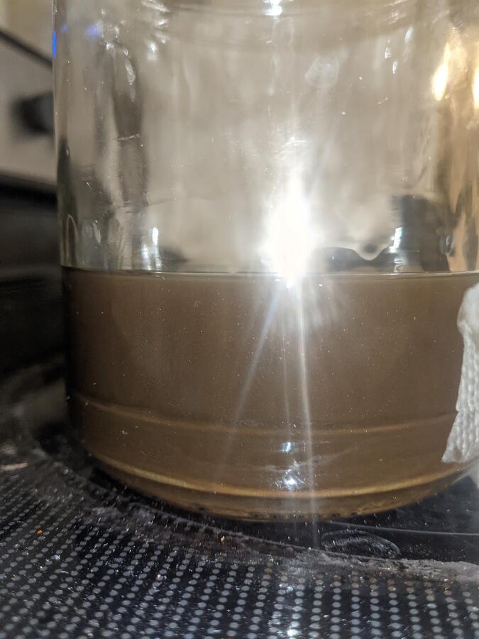

    I changed the oil as soon as I bought the car and honestly wasn't shining a light directly on the oil so I didn't notice anything strange. It wasn't until now, ~300 miles later, that I was replacing the o-rings on the oil cooler and noticed the sparkliness of the oil, visible with a light shining directly on it.
    (yep, that's my stove, was trying to see if maybe they were just little air bubbles by heating the oil a little, they're not)
    It's easiest to observe in this video:
    I took a large magnet to the side of my drain pan and can definitely see some movement in the fluid, but it honestly just looks like a shadow moving, it doesn't appear that all of the glitter moves with the magnet. It's all so fine, it's pretty challenging to really see.

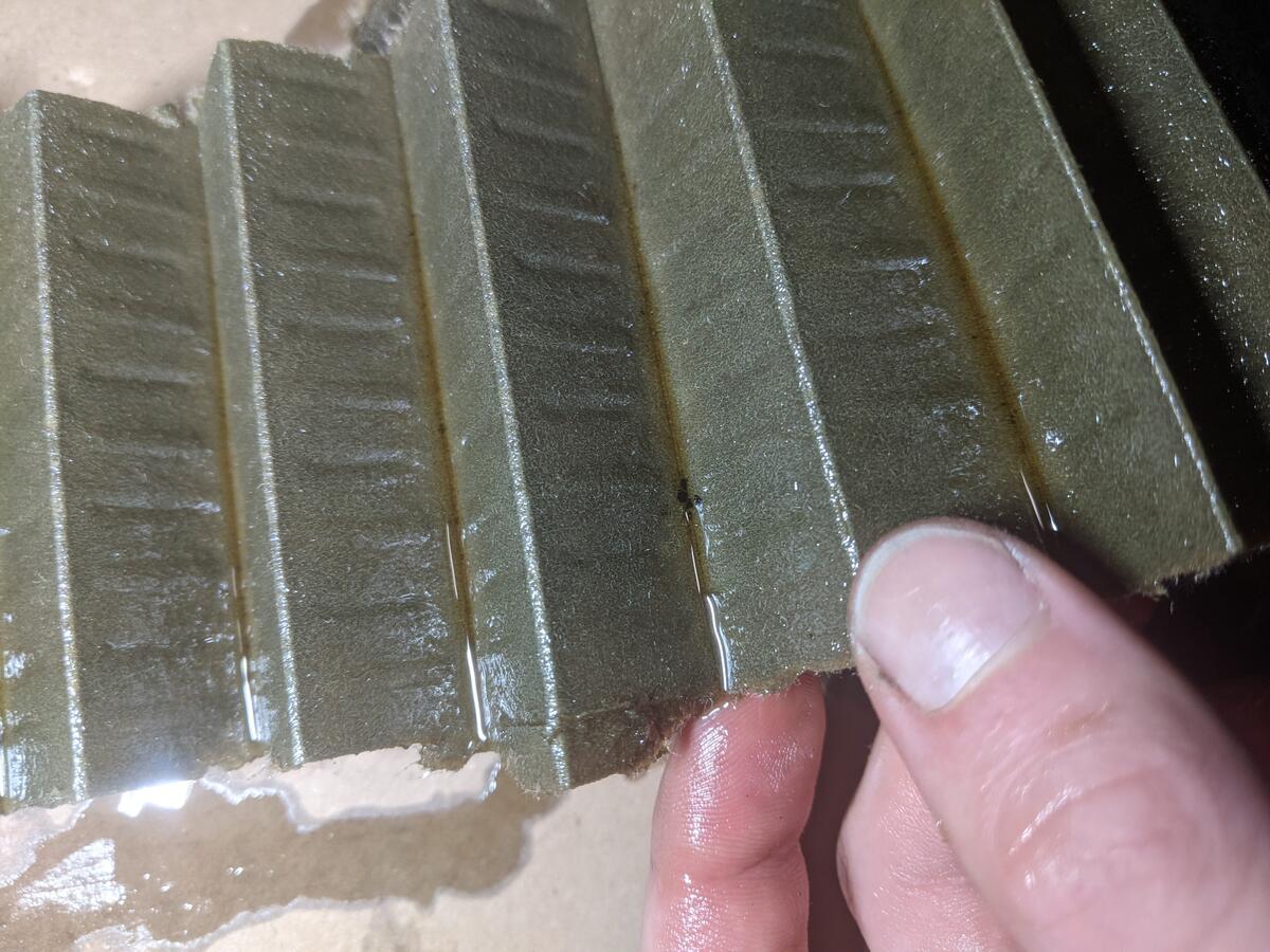

    I also chopped up the oil filter and checked the pleats. I found some black non-ferrous flecks like this:
    Not sure if that's carbon? I did also manage to find 2 small metal slivers that danced with my magnet. So small I didn't even see them until I waved my magnet underneath the filter and saw it move.

                The cut out filter doesn't look bad at all. This is a good news.

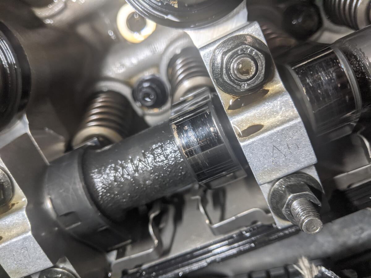

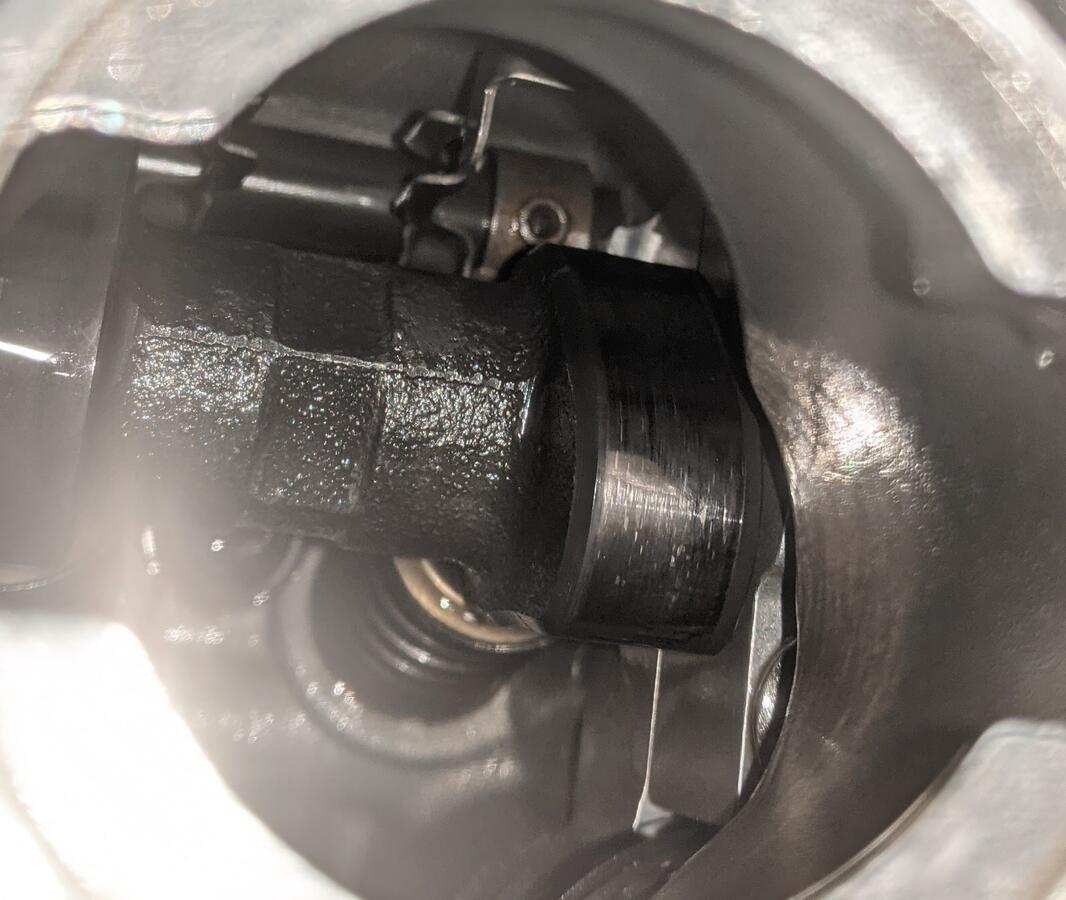

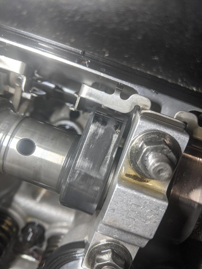

                              Pulled the valve cover today. Cam lobes don't look too hot, still not clear what would cause the wear I'm seeing on them. Here's the worst one:
                              Click image for larger version  Name:	PXL_20210815_213014407.jpg Views:	0 Size:	125.6 KB ID:	120974
                              I can feel the gold (?) pits with my fingernail, anyone know what I'm looking at? I thought the cams were steel all the way through. Cam followers look similarly worn and almost...rusty? Could just be the coloring of some stuff that didn't come off when this head was last cleaned, as it clearly has been in recent mileage.
                              Click image for larger version  Name:	PXL_20210815_213331730.jpg Views:	0 Size:	97.1 KB ID:	120975
                              Click image for larger version  Name:	PXL_20210815_210659037.jpg Views:	0 Size:	121.7 KB ID:	120976

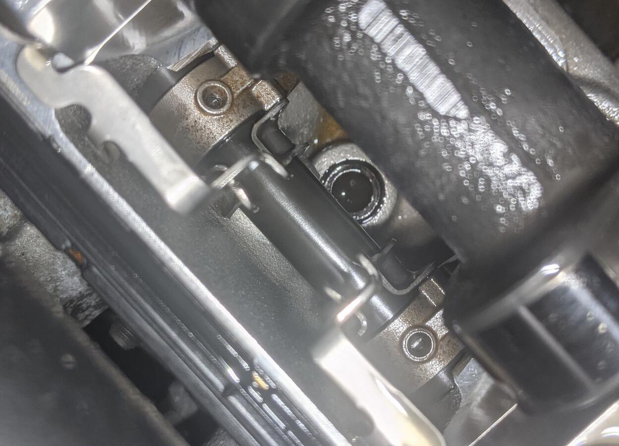

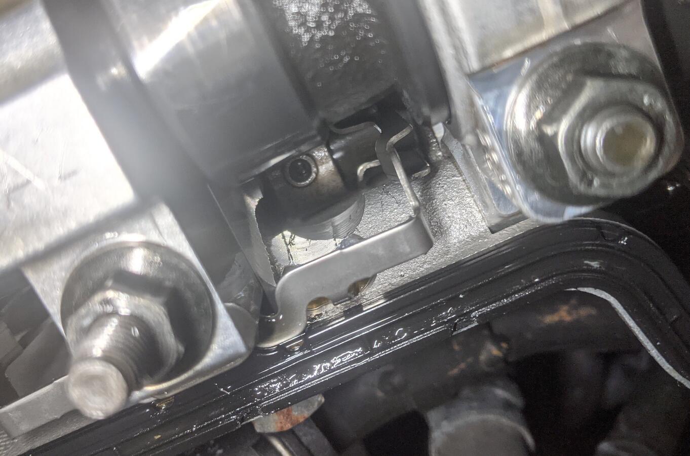

                              The little pools of oil in the head seem to have a higher concentration of metal in them than the oil I pulled out of the pan. When sticking a magnet in these pools, I can pick up a fair amount of metal powder, but not all. Note the "sludge" on top of the cam caps in the earlier picture isn't actually sludge, it's metal 😦. (Hello apparent ARP head studs)
                              Click image for larger version  Name:	PXL_20210815_210611244.jpg Views:	0 Size:	167.0 KB ID:	120977
                              Is there any risk of pulling off just one of the cam caps as long as the lobes near it aren't loaded up? Curious to check the journals here, but these are long cams and I know they can be brittle.
                              Because the metal found in the oil in the head is more obviously magnetic, that makes me wonder if this is in fact the cams that are throwing this metal. They don't seem _that_ bad to me, but I'm wondering if they're worn far enough that they're through their hardened layer and are shedding their softer metal now. I checked clearance on a few of the valves, something the PO allegedly did, and they were within spec, so this doesn't appear to be the immediate issue.

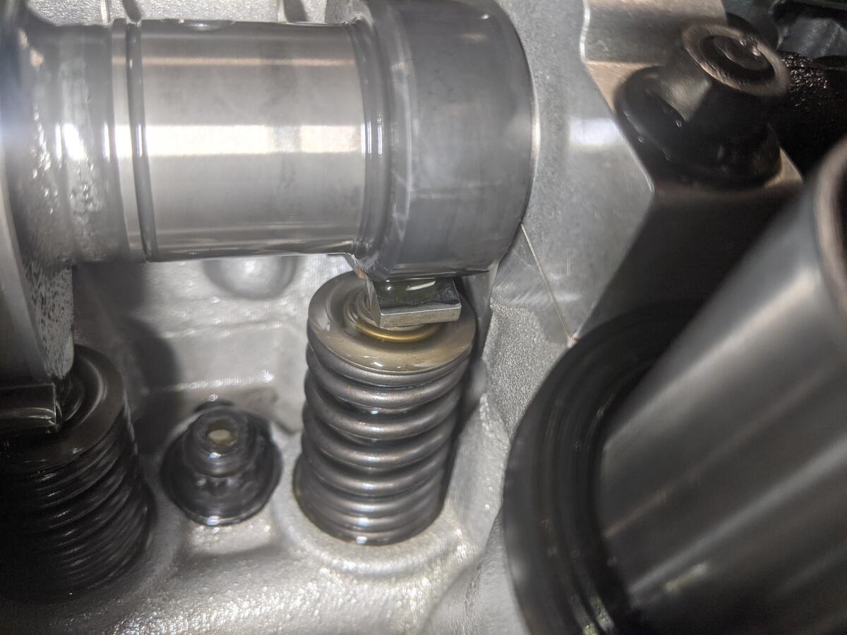

                              Also this is the cylinder 1 exhaust cam follower area, is the casting on the head really that rough from factory? It looks like someone scratched it up a little more with a screwdriver or something, presumably to remove the cam follower retainer, but the moon-shaped cutout looks odd to me, as well as the jaggedness to the left of it, below the cam cap.
                              Click image for larger version  Name:	PXL_20210815_210628251.jpg Views:	0 Size:	132.0 KB ID:	120978

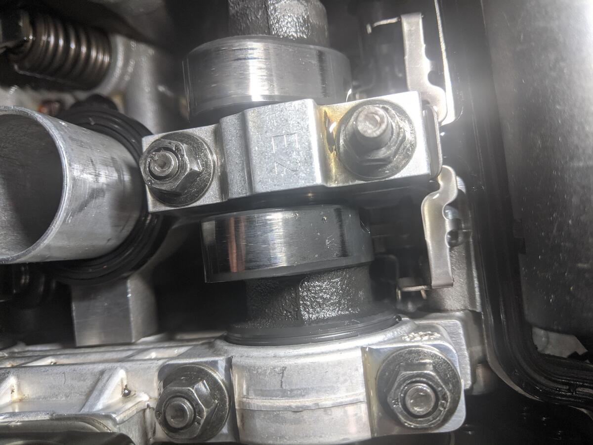

                              Attached some additional lobe photos for good measure
