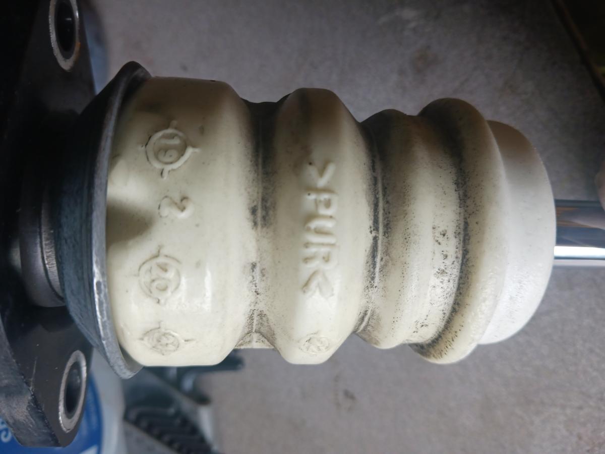

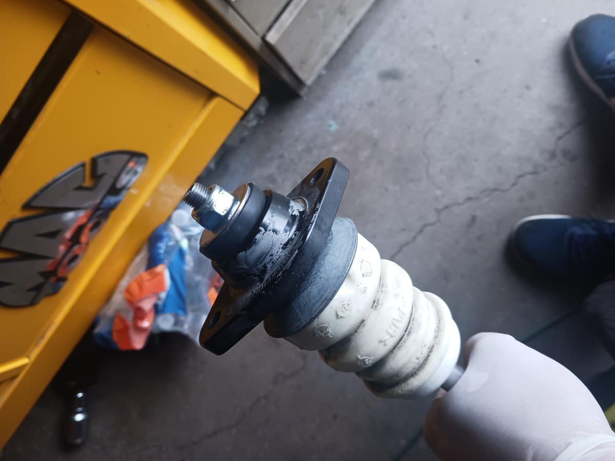

    Hey y’all, I hit a nice pothole the other day and blew the rubber though the original driver side rear shock mount. No big deal, could have been worse. I replaced the shock mount with an identical Lemforder mount… and 10 miles later the rubber pops out of the mount again. At this point I have to ask, is something else causing this or are these OE units really that poorly designed and I’ve just had a very unlikely coincidence. Any similar experiences before tackling it again?
    Is your shock seized up? That would be my first check. Tbh, I've never had an OE mount fail, but I do like how much more substantial the rogue engineering mounts are, that's always my choice for replacement.
      I did order the RE replacements for this next go around. The shocks are one year old Bilstein B6, but possible siezed or warped from that pothole. Although it looked ok when I had it off for the first shock mount replacement
        Try compressing it by hand, should be doable if everything's working correctly.
          The first time was from an impact. That’s not uncommon to bust it.
          The second was a premature failure. That is very often from not installing the bottom washer.
          Other than that make sure you got the M3 RSM and not the weaker basic RSM.

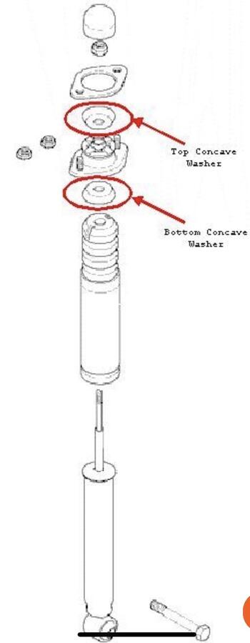

            Here’s the bottom concave washer orientation.

              old///MFanatic thanks for the insight! I can’t remember now if I missed the bottom washer or not (entirely possible)- I replaced them with the Rogue mounts. All seems good now.

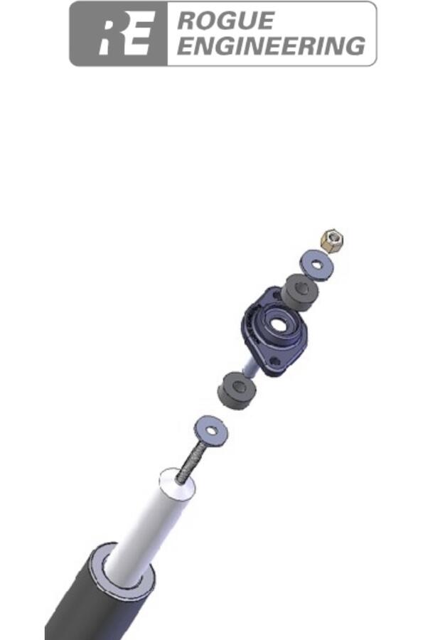

                Just so you know even with RE you need a bottom washer. But they supply it in their kit. Click image for larger version

                  Do you need the top and bottom cupped washers for the RE RSM? Rogue has a video where they use the stock cupped washer above the bump stop AND their washer. They don't show the top-side BMW cupped washer but I have seen forum posts suggesting you need it.
                    The factory washer cups over the factory bump stop - more surface area for the bump stop to contact. If the washer is smaller than the diameter/shape of the bump stop, the bump stop can fail prematurely.
                      Makes perfect sense to me, although probably a PITA to get a socket on the nuts with that in place. Any thought on the top nut? Ben doesn't show the stock washer in this old video.

                        That's right, I forgot about the clearance issue. That's probably why BMW used studs on the RSM and had the fasteners on the top, plus the hardware won't corrode if it is in the trunk.
                          Well RE does include a top reinforcement ring, which BMW doesn’t use standard. So they welded the studs to that, so could be utilized facing down. Allowing an easier removal of the rear shocks after without need to delve deep into the trunk liner.
                            Is this correct with the rogue rsms?
                              Looks correct to me, at least on the bottom side. Do we still need the top cupped washer in addition to the Rogue-supplied washer? He doesn't use it in his video, though.
