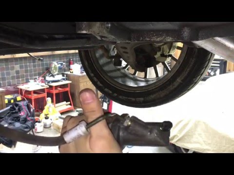

              If you've already power bled then you could probably firm it up with the method in this video, similar to what jbfrancis suggested but doesn't require a second person to work the pedal.

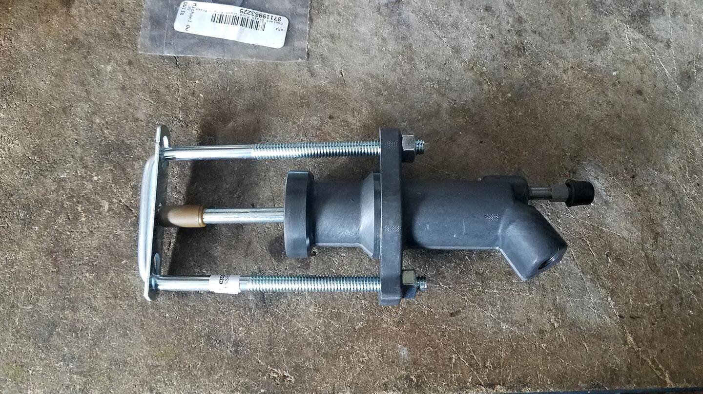

                  For install

                            Sure feels like there are bubbles in there. I have the power bleeder and will go to hardware store and make the tool Tbonem3 depicted.

                            If I use the tool to hold the rod in the cylinder do I want to have it pushed in as far as it will go as to not leave room for air?
