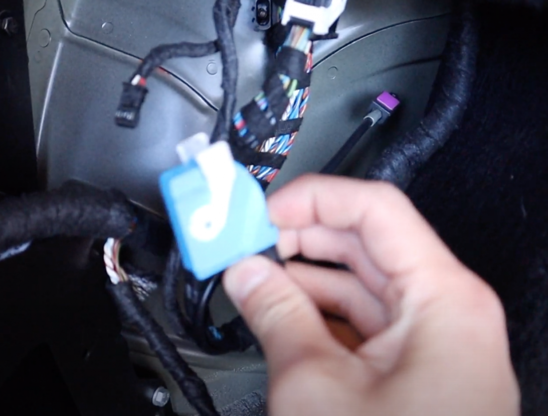

  • t3ddftw
    replied
    Originally posted by Grke46m3 View Post
    Hey Ted!
    This is what my harness looks like in my m3 what adapter would I need?
    Howdy!
    You can either do the 54-pin or the SES since you have both. The choice is yours
    -Ted
