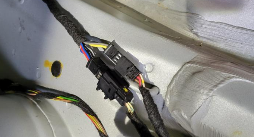

    I just installed it in my M3 CSL.
    Since my car is not pre-wired for a CD-changer in the boot, I installed it behind the radio, putting the BlueBus module in the glovebox.
    I am really happy with it.
    Thanks again to Ted for his support and his patience.

    Originally posted by Flow View Post
    I installed it the same way as you in the beginning but modified it to put it where the 6CD changer was.
    The issue with where you mounted it is for updates it is a major PITA as you have to remove the carpet.
    If you mount it where you have that tray, you just have to open the flap in the trunk, connect a USB cable, and update. Much more convenient.
    Originally posted by Rekpoint View Post
    I installed it the same way, but I plugged in a USB and fed it between the DVD and tray. Stashed the rest of the USB in the tray. For updates. Plugin, run the update then forget.
    I like the TCU tray installation method; I would recommend a right angled USB Micro-B cable, or just install it with the USB port facing the front of the car, while in that tray
