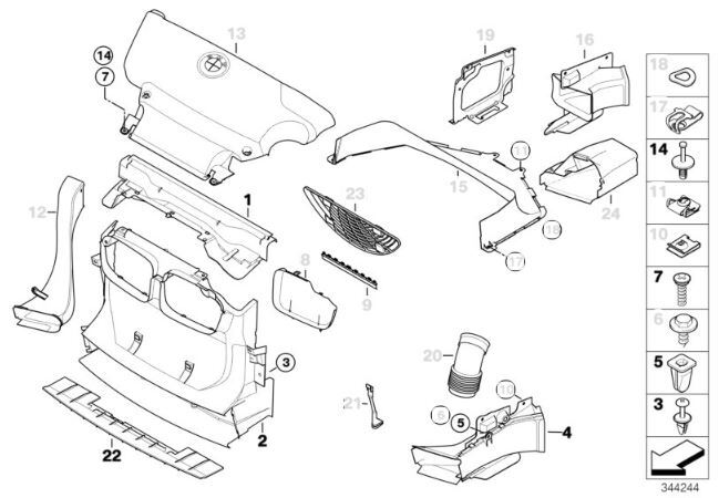

          You could run "9,10,15" in this scenario, which I believe is meant to draw air from below the car/outside engine bay when the flap is closed.
          As said above - for main snorkel intake, could run an Eventuri scoop or piece of ducting to connect with the hole in the top of the brake duct.
            Click image for larger version  Name:	Screen Shot 2020-04-16 at 7.47.30 AM.png Views:	0 Size:	354.4 KB ID:	12565
            So would parts 9/10/15 mount up to a US spec car?
            I was totally mistaken in my understanding of the ducting. I thought the parts 9/10/15 (behind the flap ducting) went to the hole in the bumper, but its the snorkel part #8 that goes to the bumper hole.
              I'm running a flapless snorkel, and chose not to bother with the secondary ducting (looks like a PITA to run lol)
              From what I've seen you should have no issues getting that stuff to work, as it doesn't interact with the bumper.
                Yeah 9,10 and 15 just sort of point down into the belly pan once assembled. I have them lying around in my closet but haven’t been bothered enough about it to actually install. You might need to drill a hole in one of those thin sheet metal mount things behind the bumper but not a big deal. The bendy insulated tube wraps around the front snorkel tube so it might be awkward or unstable without the front tube, not totally sure.

                          The flap acts as another throttle; its not just about noise control. Frank at TTFS knows a good bit about the function and design.
                          There is an easy way to connect everything in a functional manner:
                          The driver's side brake duct (#4) serves as the intake for the factory system. That's the starting point.
                          In the diagram, #20 tube gets cut down by an inch or two. Orient the tube so it fits back in the duct hole by 180 degrees from factory (its cut on an angle, you want to install with the long end towards rear of the car so as to catch the air). I think you'll need to grind down a plastic locating key.
                          Squeeze the upper portion in your hand to fit over the triangular portion of the snorkel. The bottom portion fits back in the hole of the duct.
                          On the duct, there is a bulbous protrusion designed to direct clean air into the factory system. Its not visible in the diagram. Cut the end of the bulb off you have another side duct, essentially.
                          Get 3" neoprene air duct (single layer) from Pegasus Racing meant for brake cooling. 3 ft length is needed. Connect air duct to your newly formed "side duct," and the other end to the intake of the CSL airbox, the intake downstream from the flap. You'll want to cut away the wire of the air duct for a good seal. 2.75" air duct would be perfect but I didn't find any in that size.
                          With the factory powersteering lines, you aren't going to have much room to run that 3" duct so be prepared to smush it, tie it away, etc. Interference with the alternator pulley is likely. I did away with the factory lines so it fits well.
                          For those to whom its applies: some vehicles have blanking plates on the rear of the factory brake ducts (visible from the wheel wells). My driver's side came with a partially closed blank and passenger side with a full blank (nothing can pass through). You can swap plates to direct maximum air into the driver's duct which feeds your airbox.
                              Click image for larger version Name:	Capture.JPG Views:	0 Size:	43.0 KB ID:	12730
                              Excellent post. This is exactly what I was thinking about doing, but without the extra side duct. When I talked to Matt Coyne (Coyne/Kassel Performance) he said that anyone running an oversized alternator pulley will want to be careful as it can make contact with the OEM CSL ducting (I believe #9 in the diagram from post #5). Dafoe (M3F) had issues with his setup for that reason.
