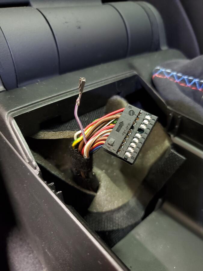

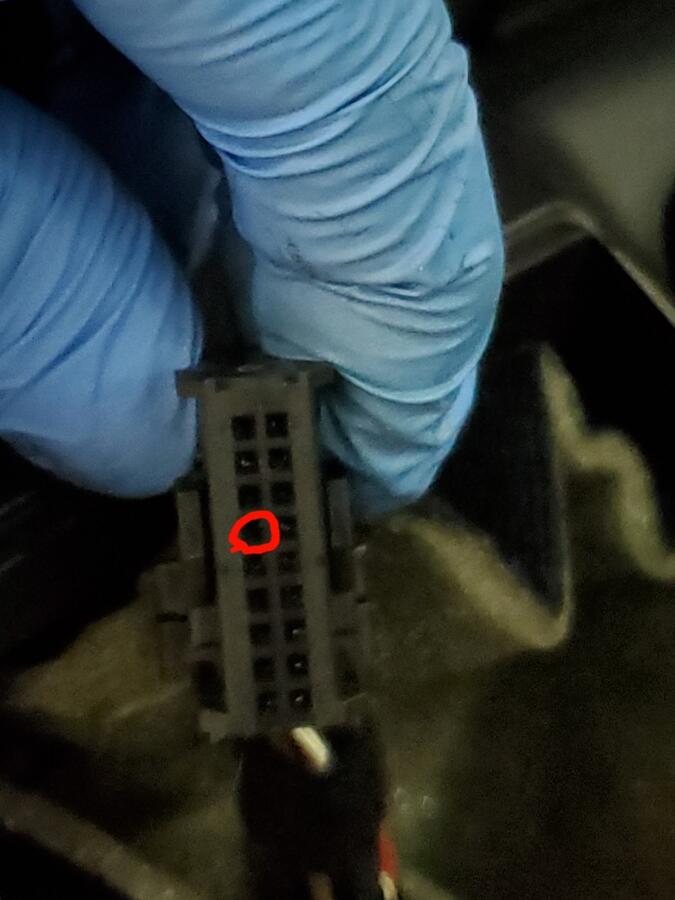

      I found pin #6 is indeed switched power on the telephone connector fwiw.
      Click image for larger version  Name:	20210911_191448.jpg Views:	3 Size:	51.2 KB ID:	126111
      Purple/White wire:

          I had planned on simply grabbing switched power from the DME box and ground from the factory jump point also in the engine bay however I felt I wanted to do something a bit cleaner and not have even more extra wires in the engine bay, although with some routing it likely would have been fine.

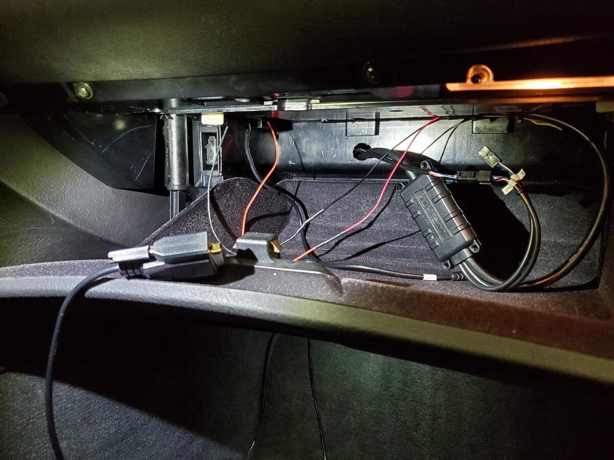

          I tapped into the telephone connector, depinned a switched 12v and ground and cut the terminals off and soldered wire to them that runs from the center console to the glove box where the "brain" of the LC2 resides. I have the pigtails with factory terminals should I ever want to return it to factory...and use the telephone connector.

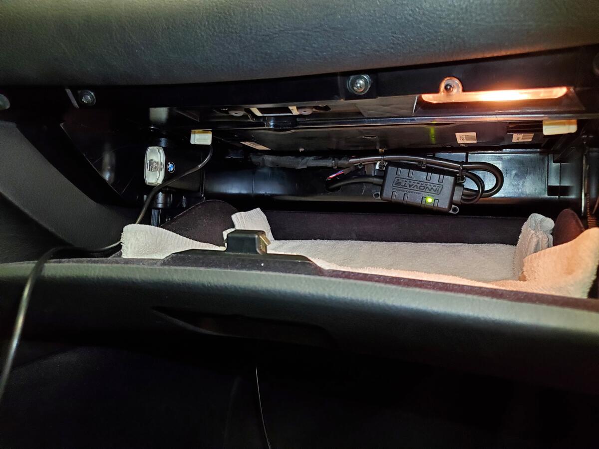

          I have some tidying up to do, I think some strong double-sided tape should be good to affix the LC2 module in the glove box without sacrificing too much space.
          One good thing using the telephone power/ground is it is already fused, currently at 5A, I would never run wires into the cabin unless they are fused.
          Now to see if all this work pulling wires turns into an AFR figure on the screen of my laptop!
