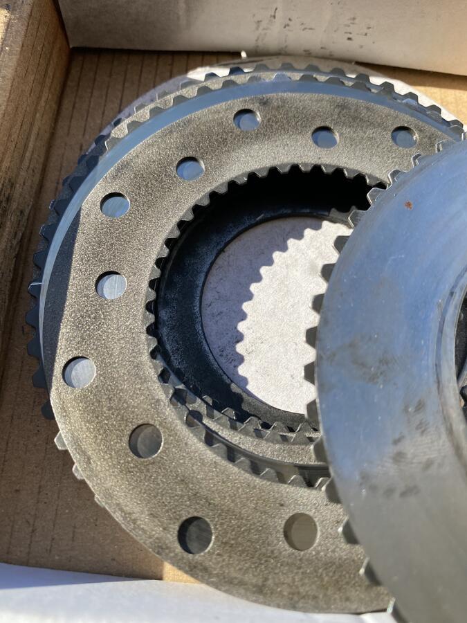

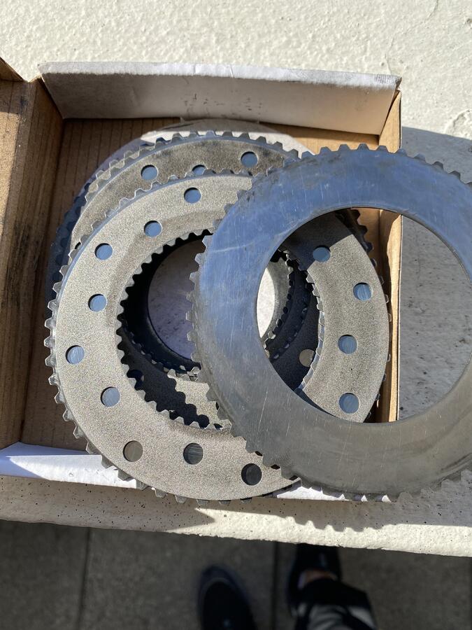

When I got the RACP reinforced I also took the time to service the diff. It had the usual play and I went for this https://racingdiffs.com/products/bmw...d-clutch-plate, the shim did somewhat cure the free play issue but not 100%. But what we saw is that the clutches were in relatively good shape (car has probably over 300k km or 200k miles), so I'm not sure what wears quickly.
The diff made noise at low speeds on tight corners, like parking garages, and it still does with the new clutches. I'm using Liqui Moly 75w140 LSD fluid at the moment, unsure what the car had in it before the "rebuild".
Attached pictures of the old clutches.
