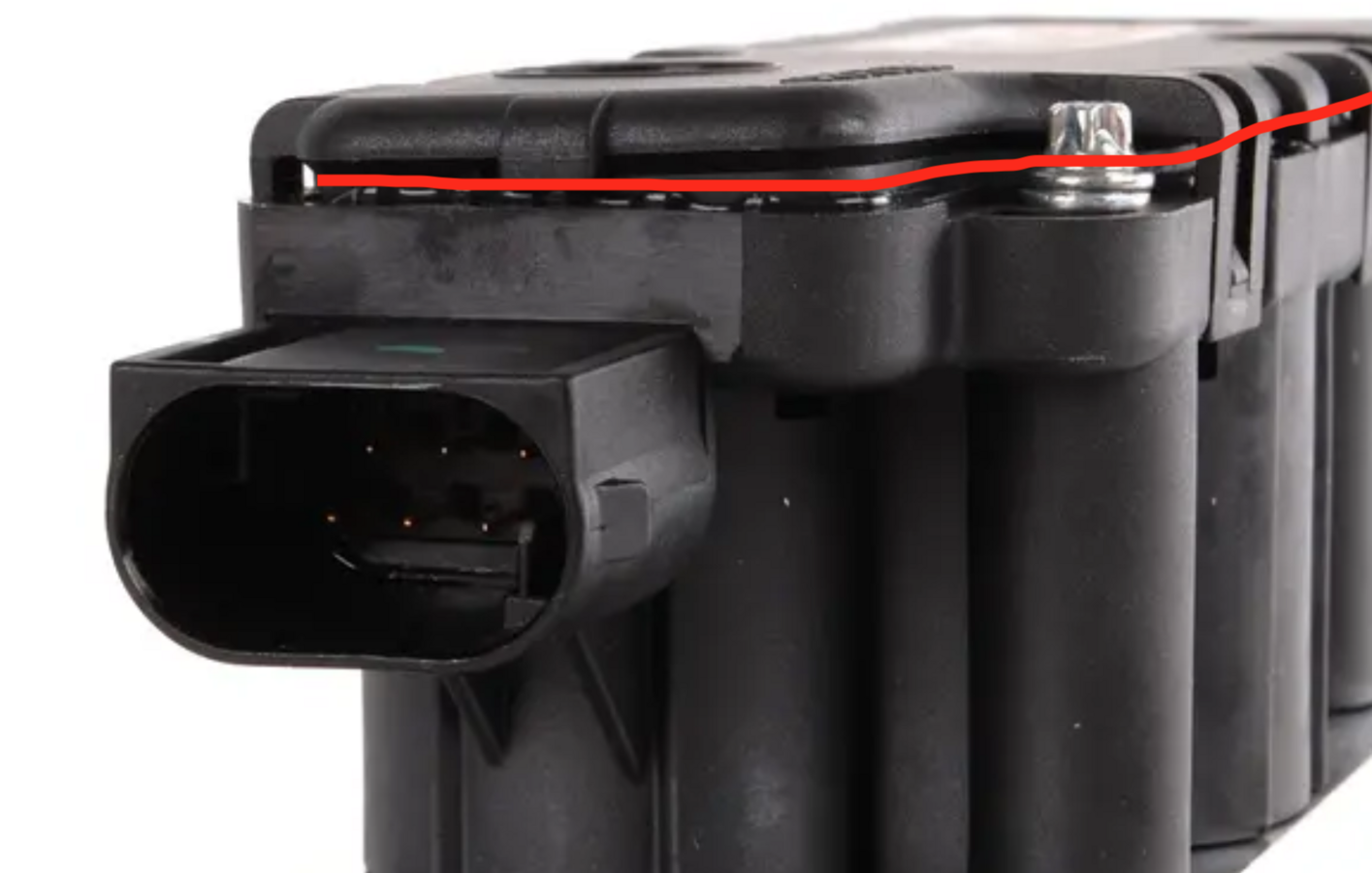

However, Beisan seems to cut it off (as is evident in pictures and in their description of the solenoid refurbishment), so I elected to do that instead. Seeing how brittle the tabs were made me worry that I would snap the lid if I tried to pry it off.
You want to cut around the perimeter of the lid, along the red line:
Don't need to cut too deep, the wall you're cutting is only about 1-2mm thick. Make sure to cut all the way into the two holes in the lid for the e torx bolts, or else the lid will stay attached. Once you've cut all around it, the lid should fall right off. If it doesn't, you missed a spot.

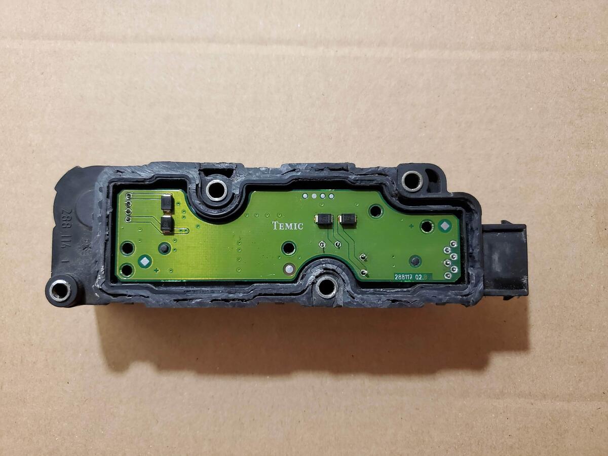

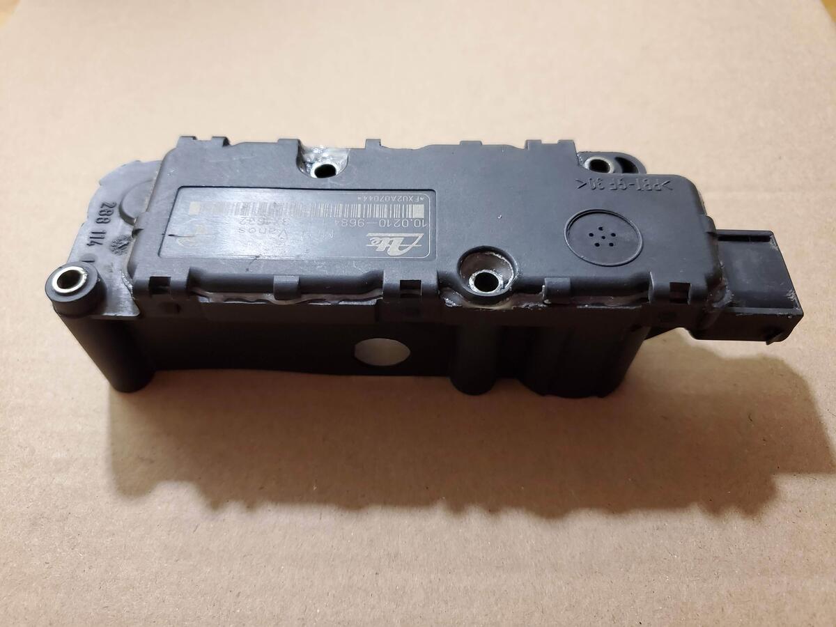

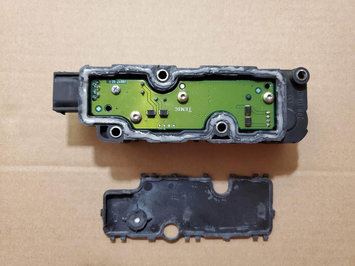

Here's my pack after the cut:

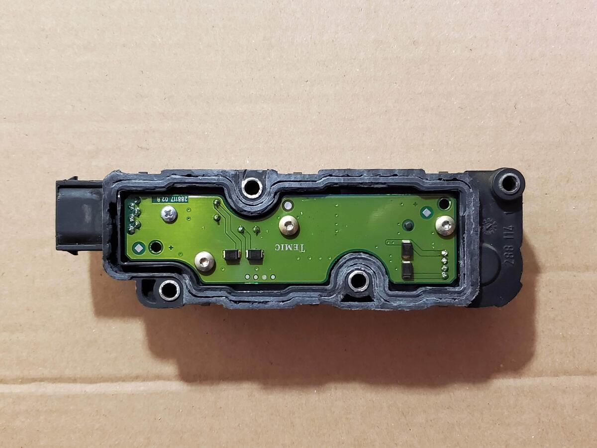

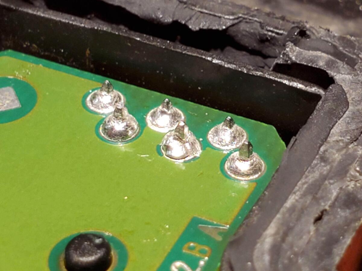

Step 3: Inspect the solder joints to see if there's any failures. Mine were fine, but some cracking had started around some of the solder joints, mainly the middle front one:

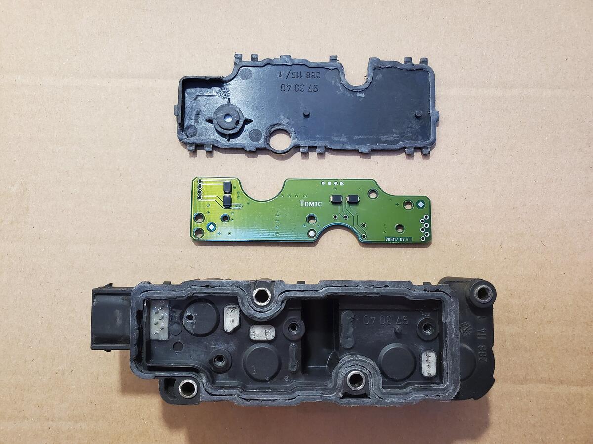

Step 4: Get the PCB out.
The PCB is held in by a few torx (T10?) screws, the solder joints and a few dabs of adhesive on the bottom. First thing to do is to remove all the old solder. I heated up the pads with a soldering iron and used a solder sucker to get all of it out. Fortunately the solder points on the PCB are full vias and not just pads on the top, so it's hard to overheat and damage them with the iron.
The solenoids are attached to the PCB with some thin wires, so be very careful with those, as you don't want to snap them. I ended up basically pushing some of them through (from top to bottom) with the soldering iron, as it was super hard to get all the solder out.
Once all the solder has been removed, you can lift up the board. You'll need to pry up on it with a good amount of force because of the adhesive used, but it'll eventually come out.

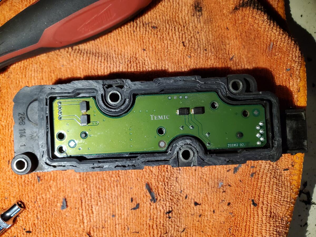

Solder removed:
PCB removed:
It's a good idea to measure the resistance of all four solenoids before continuing, to make sure that none were damaged during the removal of the board. If any were, there's no sense in doing any of the following steps. All four of my solenoids measured in at 6.8 Ω.

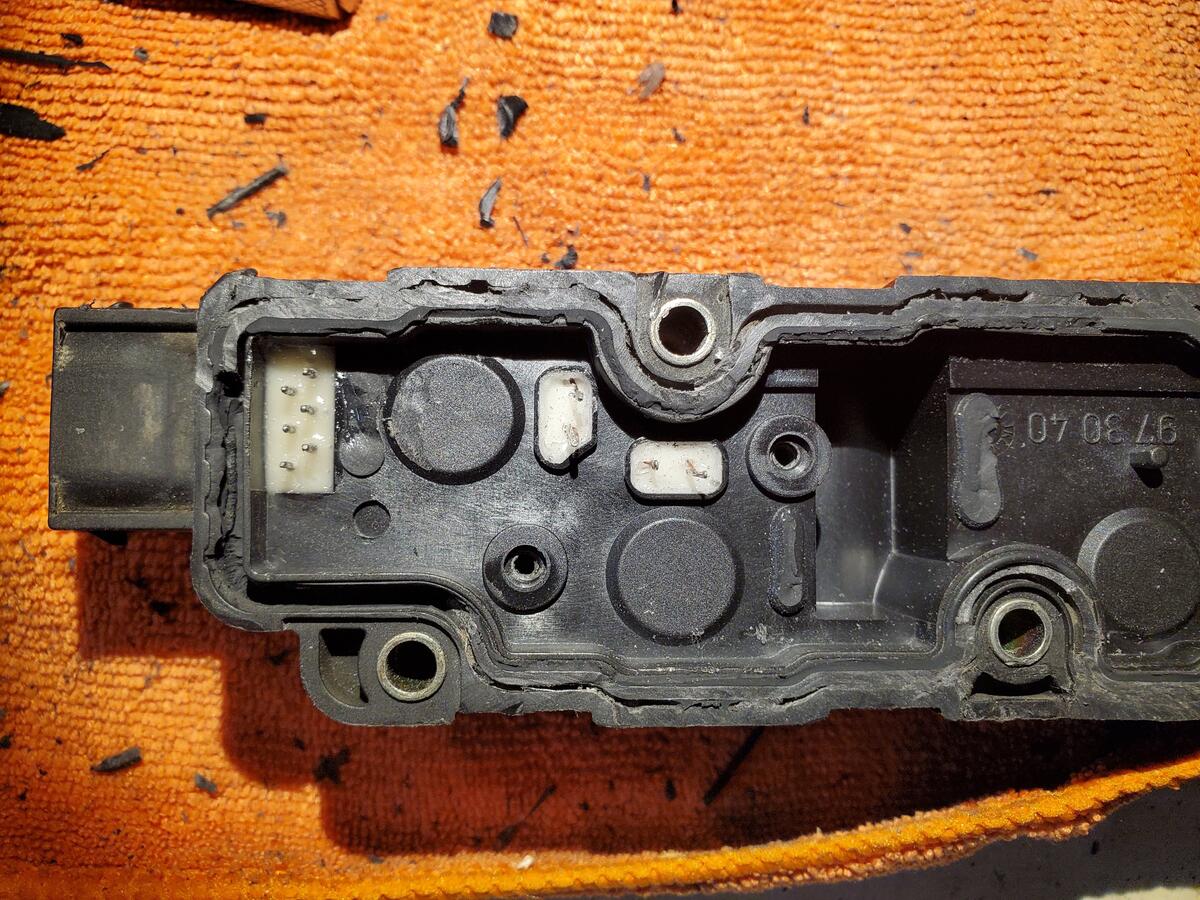

Step 5: Fill in the space between the connector leads with some sort of adhesive.
I used JB Weld Plastic Bonder mostly because I wanted to try it out. Any electrically insulating adhesive should work though. Pour it into the cavity and make sure not to get too much on the pins. If you do get some on them, wait for it to dry and scrape it off later.
Also, be sure that all the pins are still where they should be or else you'll permanently glue them in incorrect positions.

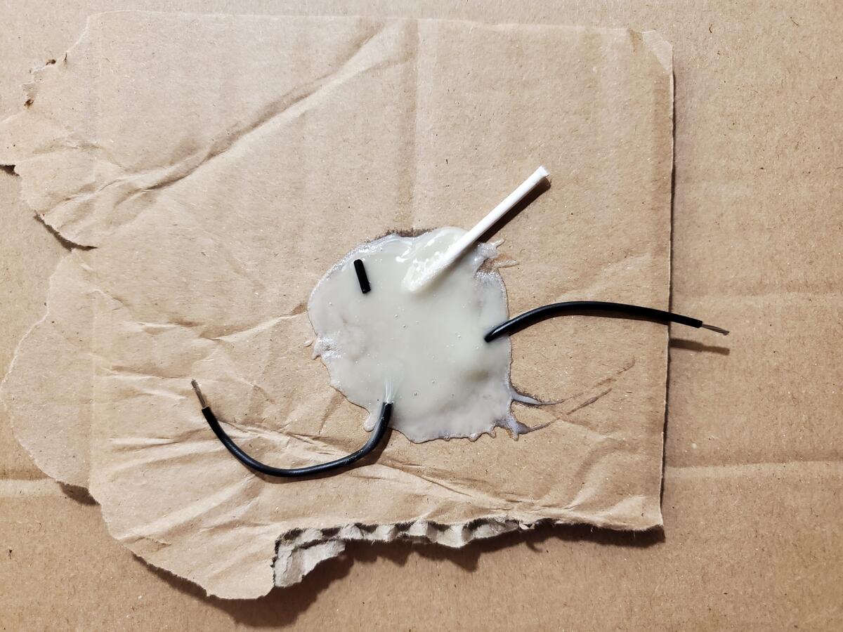

Before using the JB Weld stuff, I did a few tests with it. First, I wanted to make sure it wasn't conductive, so I stuck a couple wires into some of it and let it dry:
It is indeed non-conductive.

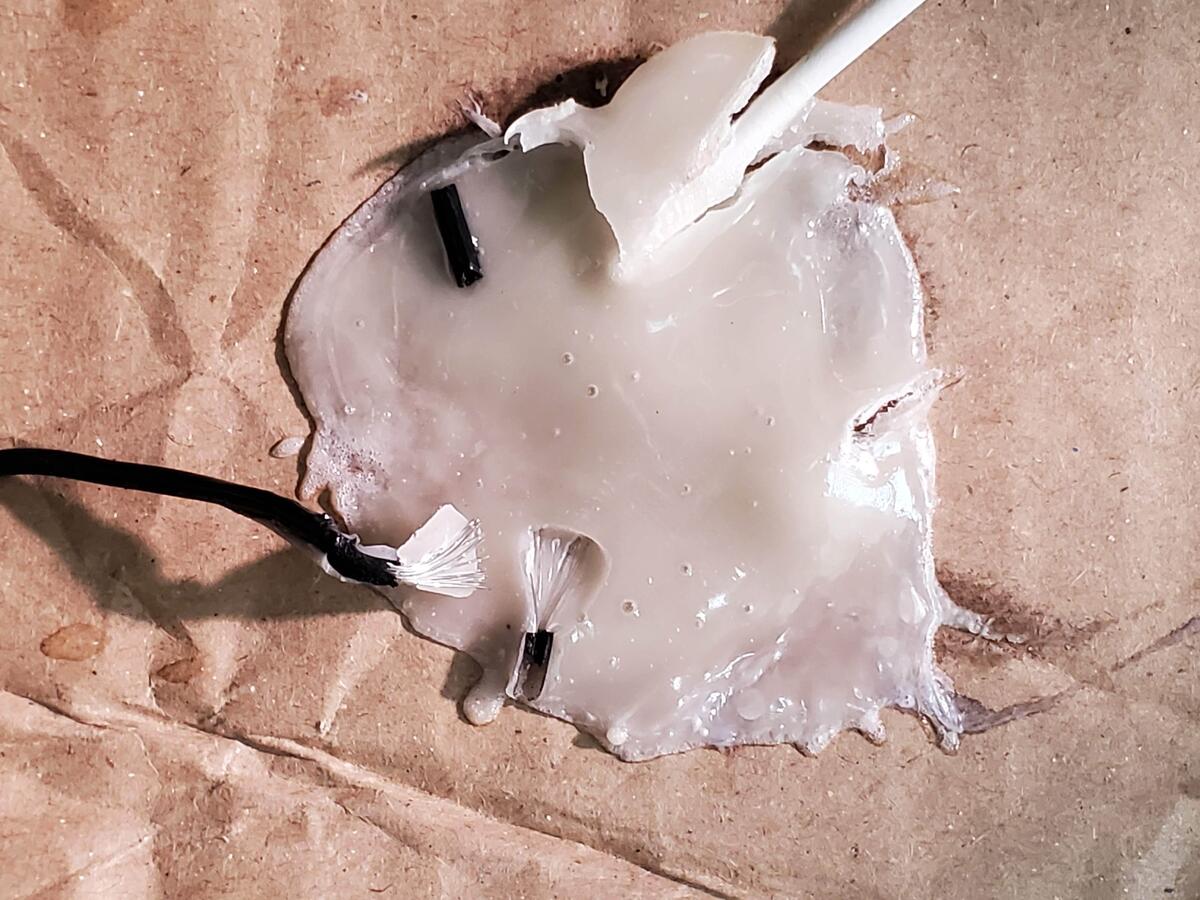

I also wanted to see how it would react to heat. Fastenal says it can withstand up to 350ºF, so should be fine, but I still tested it out. I pointed a heat gun at it for maybe thirty seconds and then tried to pull one of the wires out. The epoxy became very brittle with the heat from the heat gun and I was able to break it off easily:
However, if I let it cool back down, it seemed to regain its strength, which is great. Even if the temperature in the pack were to somehow exceed 350ºF, the epoxy will be fine once it cools back down.

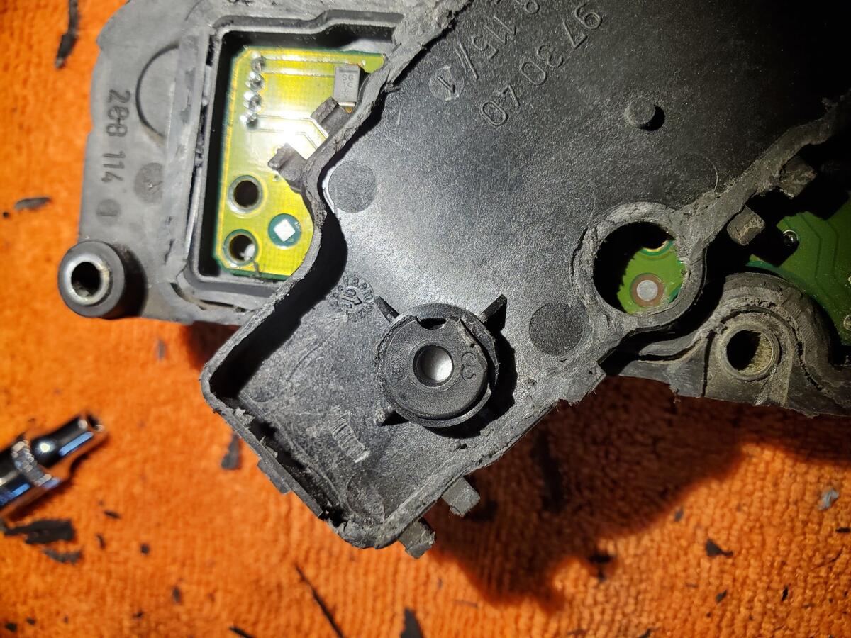

I drilled out the PCB slightly to an 1/8" diameter hole and then removed the alignment stud in the casing:

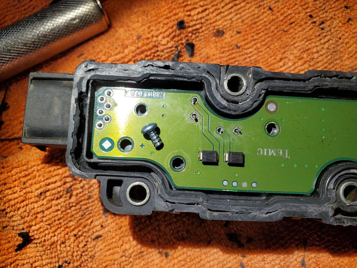

(yes that's the same pic as before, but it was the only one I had where you can see the stud is missing.)
Now it's time to drill the pilot hole for the screw where the stud used to be. Be very careful when doing this as one of the solenoids is directly beneath that point. There's ~5mm of plastic, then a bit of white silicone and then the solenoid. If you reach the white silicone when you're drilling, stop immediately. The solenoid starts ~10mm below the plastic surface, so there's a little bit of wiggle room, but it's best to not risk it.
I drilled a 1/16" pilot hole for the screws I bought and I cut the threaded portion of the screw down to ~6mm (just to be extra sure I didn't hit a solenoid):

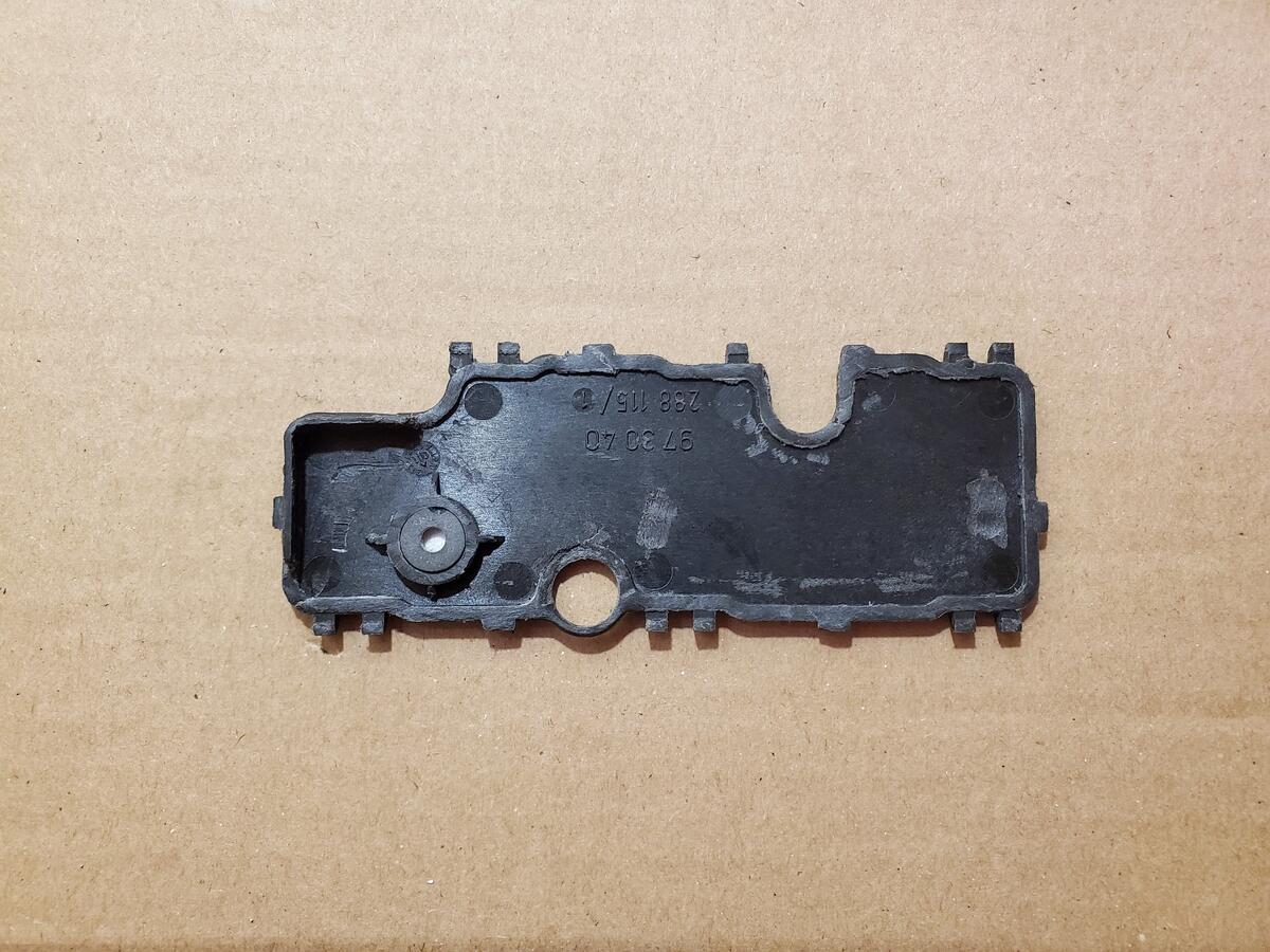

Step 7: Clearance the lid.
Since I cut the lid off, I lost a couple mm of clearance between the lid and PCB, so I needed to make some more space. There are three main things on the lid that interfered.
First up is what looks like a vent with a water barrier.

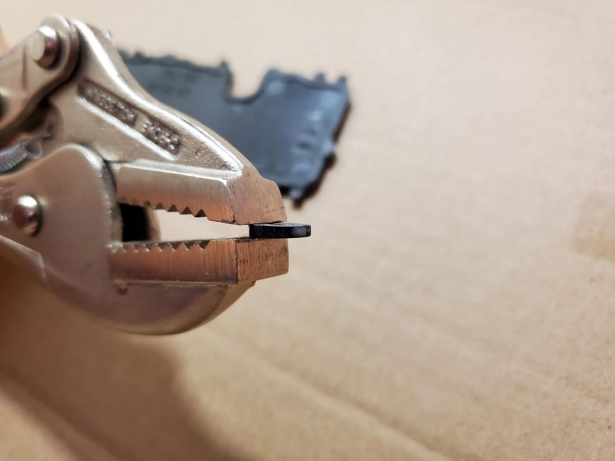

I started off by cutting it down with a dremel and a cutoff wheel:
Once I got to that point, I was able to pop the center section off. I removed it and kept grinding it down until I had made enough clearance to clear the PCB. After that, I sanded down the center section so that it was flush with the edges. I also used a dremel to remove the two plastic standoff in the lid (middle and right in the picture below):

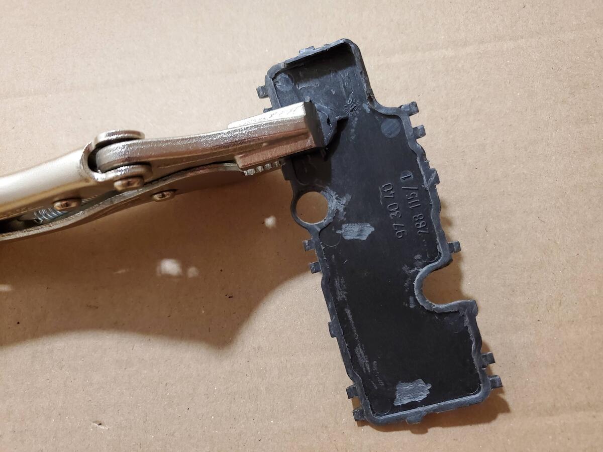

I added a small dab of the JB PlasticWeld to the center section just so that it would stay in place:
I then inserted it back in and held it in place with vice grips while it dried:

Here's everything laid out after the surfaces were cleaned up and ready to be reassembled:
Solder removed:
PCB removed:
