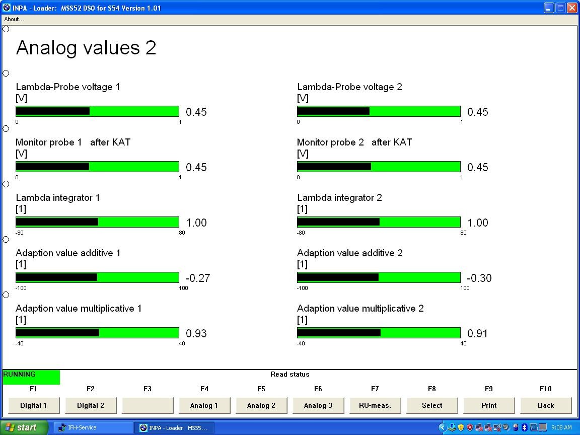

    LTFTs both sit about -7 to -9% when read via typical OBD apps or 0.93 to 0.91 in INPA or the ECUworx DME tool. I reset the adaptations and within about 20-30 minutes of driving they're back to where they were. e.g. after a clear then drive just now:
    Click image for larger version  Name:	2021-09-20 17_00_10-INPA - Loader_  MSS52 DS0 for S54 Version 1.01.png Views:	0 Size:	135.5 KB ID:	127570

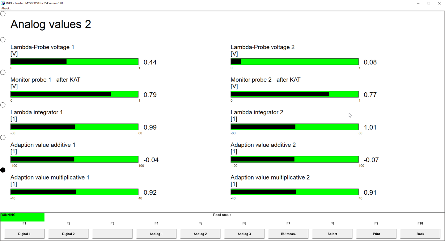

                              Click image for larger version  Name:	AdpationsCam.jpg Views:	0 Size:	92.0 KB ID:	329971 Click image for larger version  Name:	LTFT.jpg Views:	0 Size:	148.6 KB ID:	329972
                              Any Updates ? i wouldn't mind seeing mine close to .98 .99 as well
