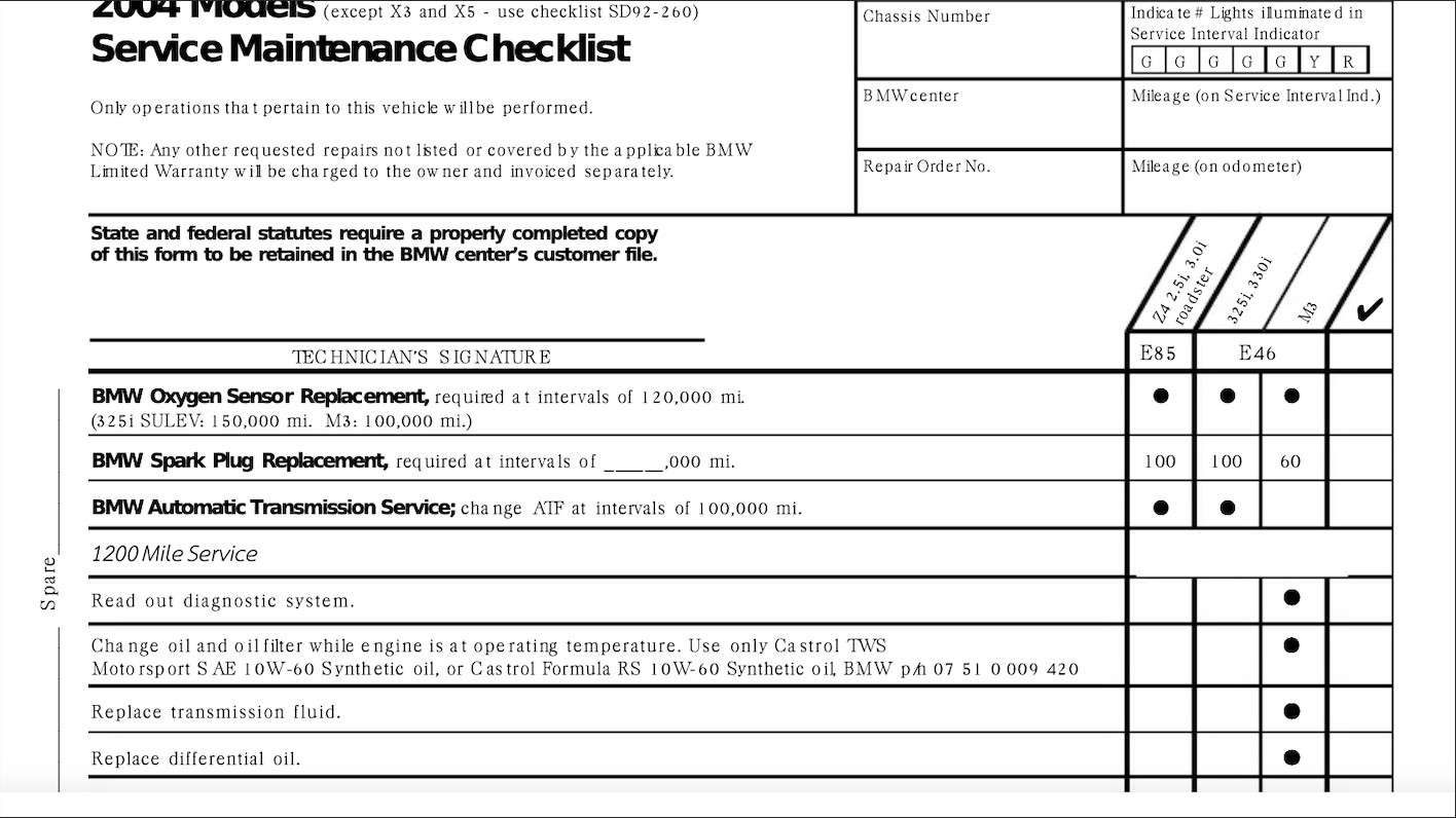

      BMW does suggest 100k mile service interval for O2 sensors.
      Click image for larger version  Name:	Service.jpg Views:	0 Size:	227.9 KB ID:	330198

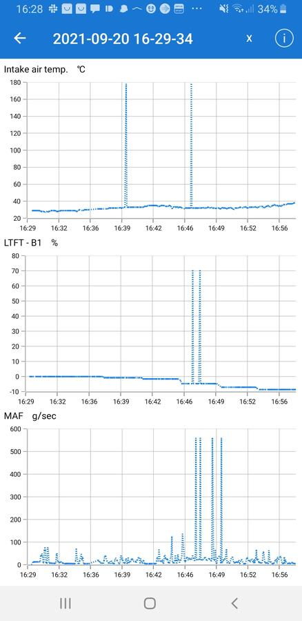

              The MAF graph below looks so wrong with very high value in g/s at idle. I like to see the MAF data at hot idle, should be less than 5g/s
                  This was a long time ago. It wasn't all idle. There's no way you can read the g/s at idle because of the graph scaling.
                  From memory it is high 4.xx g/sec at warmed up idle.
