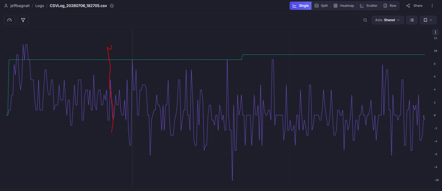

                #37
                Your LTFT at idle = 8.6 which is on the high side, and DME needed to add more fuel, meaning it's running on the lean side, not enough to trigger lean code yet. What interesting is that this LTFT trended upward at higher load. Usually for small vac leak, it should trend down at wider throttle. I think maybe the MAF can be a suspect: your MAF is slightly under report, 4.6 lbs/min at idle, should be around 4.8. You might want to swap with a good known MAF and see if the LTFT going down to around 3.5 at idle.
                Under-report MAF causes DME to inject not enough fuel, then precat sensors tell DME to add more fuel, hence higher LTFT.
                Cats still have a lots of lives in them. They stay solid high at idle, and switch a few cycles during the drive which is normal.
                All 4 O2 sensors look healthy switching rail to rail [over 0.8 to less than 0.1]
                The STFT swing around zero, so it's normal and so I only focus on the LTFT.
