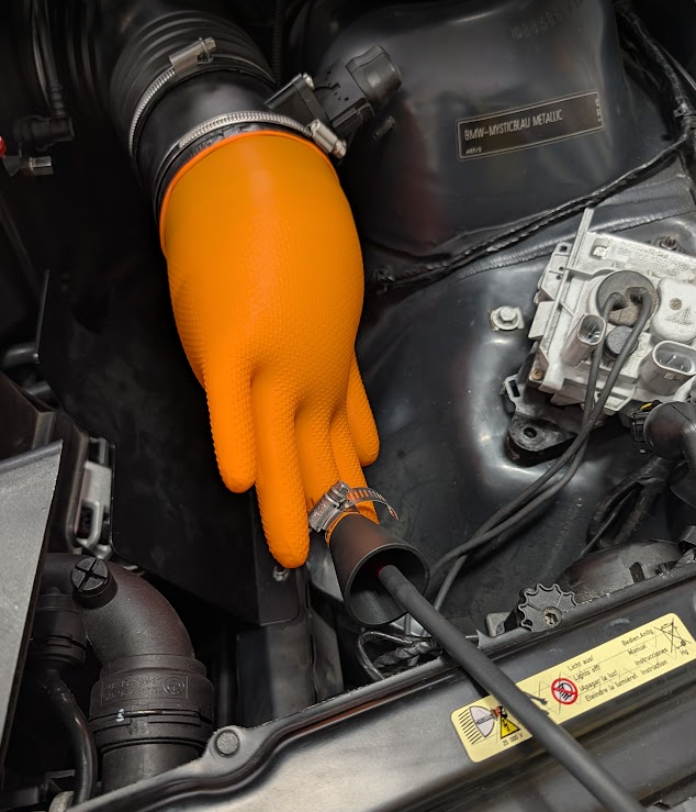

              Tried smoke testing again, but I can never get my smoke "nozzle" to not leak from the rubber glove. So there is always some smoke coming out of it that makes it annoying to try and track anything down. If anyone knows a good set of couplers / covers to cover the intake book and/or eventuri coupling (seems to be about a 3.5" diameter) -- I'd love to know!

                post pics of your State of the art rubber glove adapter? Do you cut part of the pinky finger from the glove to have a snug fit to the pump feeding hose then tie rubber bands over?
                  #53
                  This was my first attempt. My second one ditched the cone and I wrapped the crap out of it with electric tape. Didn't snag a picture of it.

                    hose clamp on rubber glove over the cone is no good: cut into the glove and also slide off the cone.
                    on the straight hose with ditched cone, use rubber bands instead of e-tape for a better seal.
