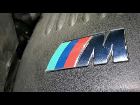

    My car is making this noise just off idle. It's a grinding noise that I can hear and feel - feels like it's coming from the front/vanos area. I have all the VANOS fixes installed.
    - Only audible coming off idle, goes away at ~1100RPM
    - Not heard at idle
    - Not heard at any engine speed higher than ~1100RPM
    - No codes or issues, engine runs smooth
    I have tried searching online and found other videos that exhibit the same noise.
    This video at 0:10
    Kinda similar noise to this, but mine is not present at idle like his.

        I would appreciate if anyone could share videos of their engines:
        -Fully warmed up
        -Gently modulate throttle to move between 800 and 1200RPM.
        -Video at vanos unit
