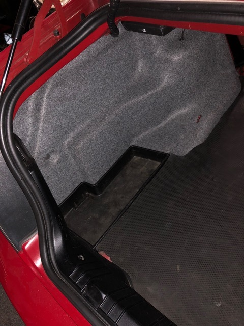

        Equally exciting for me, this project also made my trunk bigger. On the left side BMW sold trunk liner for cars with nothing there:

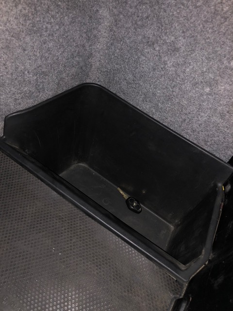

        And on the right side I relocated the battery to under the hood, as with the light weight it was no longer doing anything meaningful for distro, and the battery cable that runs to the trunk is 8 lbs. Happily, BMW made a bin that expands the usefulness of that space, as 4 cylinder e46 coupes had the battery under the hood stock:
        Combined these made my trunk bigger than my M5 trunk, with factory fit and finish.
