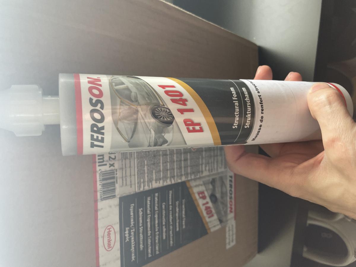

          Thanks for the great writeup and the pdf, very useful. The foam is hard to source, where did you get it? It also has a very short shelf life, did you use one past its expiration date? I wonder why the shelf life is so short on these products.
              Unfortunately, it appears to be discontinued, at least in its BMW branded incarnation
              TEROSON EP 1401 appears to be the equivalent (or more likely the BMW stuff was this product rebranded):
              But I do not know how easy it is to source that.

                  I found some Teroson Terocore 1401 (BMW rebranded this product as their structural foam, but that's the original stuff BMW used to distribute) online on Klium.com and I was able to get it delivered to Canada using forward2me.com
                  I will be doing the structural foam reinforcement soon.
