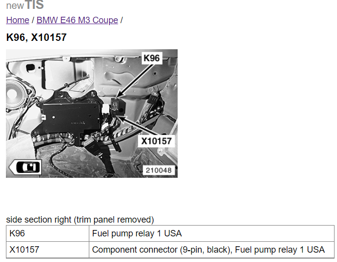

                                I can't decide if you are trolling or not... the EKPS and FP relay are both located inside the passenger compartment
                                BMW Tis says US relay is in the trunk and not passenger compartment. I'm interested to know more about PWM controlled fuel pump as you said. Could you provide the source of your information? Also, how does the DME control the European M3 mechanical pump relay with PWM, as I don't think a mechanical relay could respond to the 100 Hz PWM, and it would make a lot of clicking noise too? Unless the PWM pump speed control is only for US cars, then why such a wonderful feature was left out for EU cars?

                                Tis didn't say anything about PWM controlled fuel pump:
