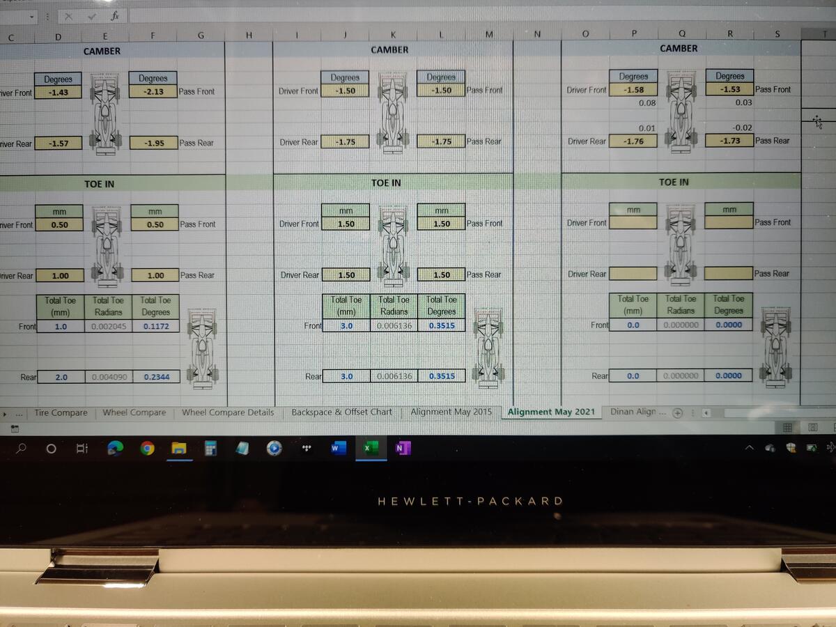

                    Not sure how you drive, but I agree this sounds like a classic case of too much toe out combined with too much negative camber.
                    Here is my setup. I have the starting measurements on left, target in middle (what I wanted to get the car as close to as possible) and then actual measured end result on right. I don't have all of the end results plugged in on the pic, but you get the idea. I can upload the full file if you want at some point. The target is what I ended up running this time and so far, I like it a lot. This works well for my car and suspension.
                    I pulled a bit of negative camber out (more positive) and added toe-in. This is a street car that I will drive "spirited" but it's still a street car. This is WAY more toe-in than others will run, but so far (1,000 miles) I really like the setup for a compromise alignment. That is, it's not a dedicated track car that needs a knife's edge turn in. It still turns in fantastic, but isn't super twitchy. Use my setup as a reference only.
                    It's too early to tell for sure about wear, but I'm getting extremely even wear and extremely even tire temps across the face of the tire - within 5 degrees F.

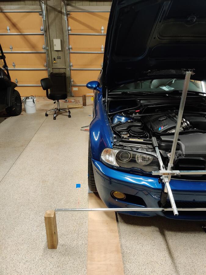

                      Nice setup! What is good way to check if the ground is level for a string alinement? Is it possible to accurately check toe, within 0.5mm, if it is not perfectly level? I know it needs to be perfectly level to check camber.
                        Get a really long level. You can also use straight piece of metal stock with a small level. Also get some cheap vinyl floor tiles.
                        Mark on the garage floor where you will be aligning your car. Mark out where the tires contact your garage floor.
                        Stack the floor tiles so all four spots are level to each other. Bonus points if you grease the tiles so they can slip around without binding.
                        For future reference, mark the tiles so you know how many go in each stack.
                          Slideways I will reply more later but elbert is spot on. I use a laser level and carpenter's square like in this article. Vinyl floor tiles from Home Depot or wherever are a great way to shim under a given wheel in about 1/8" increments. So long as my delta across 4 tires (the platform they rest on during alignment) is less than 0.125", I call it good enough. IMHO for alignments, it's more important to get side-to-side more accurate than it is front-to-rear, UNLESS you are also corner weighting.
