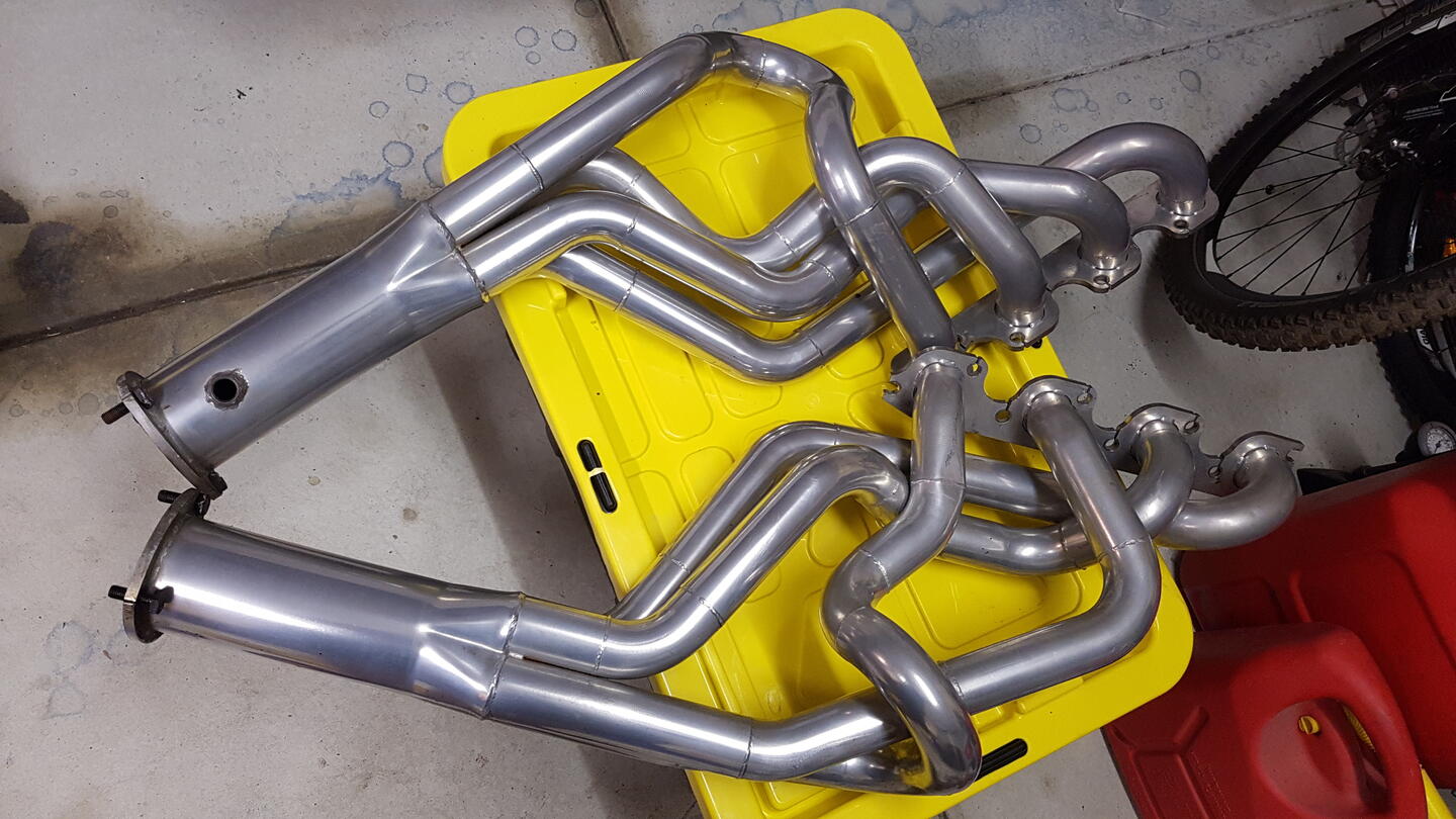

ID:	135761 These are the pipes I had coated. Substantial heat reduction in engine bay. It is an old NA v8. But power is power!
