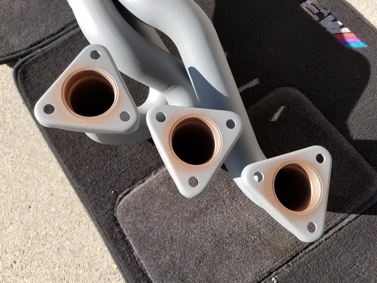

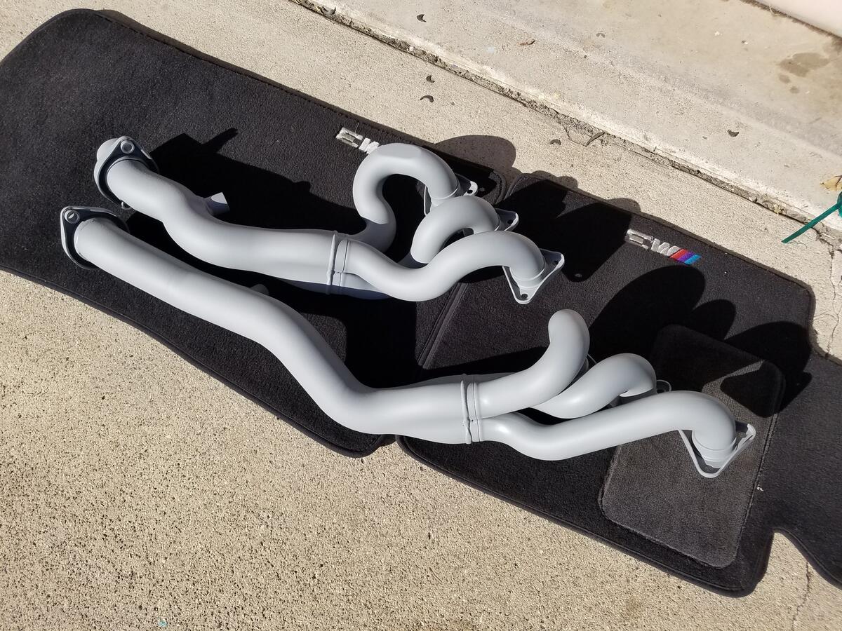

                            I had my Euro headers ceramic coated. Definitely better than header wrap which will eventually fall apart.
