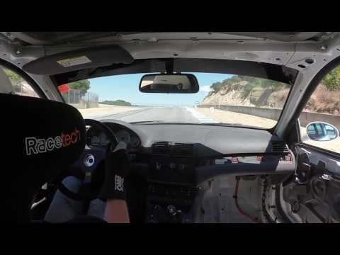

          me, in the iconic cork screw 😜

            You will be fine with your current setup and you will not need to short shift between turn 5 and 6.
            My previous exhaust setup was catless headers, resonated section1, stock section2, Dinan muffler, and an intake and this setup passed sound on 90db days. I did a sound check when they first announced the switch from the standard 92db days to 90db days as I wanted to make sure I would still pass sound and with the aforementioned setup it was ~88.8db. Despite the exhaust being a bit heavy this was actually the reason for keeping my exhaust setup the same for so many years as it would pass sound at Laguna.
            Full throttle through that section on a 90db day.
