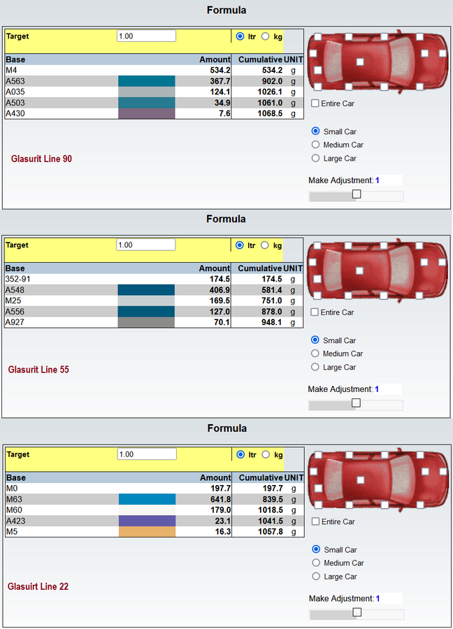

    As some may have seen, I'm planning a respray of my car to Voodoo Blue. Body shops seems to prefer domestic PPG paint to German-made Glasurit. The issue I'm running into is getting the right cross referenced formulation of BMW paint code P7L (Voodoo) to the equivalent formulation in PPG.
    To further complicate, there are 3 different lines of Glasurit paint where P7L shows up on their Colors Online tool - Line 22, 55 and 90 - all with what appear to be different formulations. See attached screenshots.
    To this layman, it seems like an x-ref would be somewhat readily available. I can see the "trade secret Coca-cola formulation" angle, but are body shops really shoehorned into using a particular brand of paint if a certain car lands in their body shop for repair? I guess that answer could be yes.
    Should I request the shop to go outside their comfort zone and use Glasurit paint? But is that sorta like telling the chef what ingredients to use when you walk into their restaurant?
    Any guidance is of course appreciated.
    Click image for larger version  Name:	Glasurit - BMW P7L Voodoo Blue.png Views:	0 Size:	277.2 KB ID:	138233

    Found this info on another site - http://forums.pelicanparts.com/porsc...it-line.html
    22 Line is single stage
    55 line is solvent basecoat
    90 Line is waterborne basecoat
    Glasurit 90 is what was recommended by a local shop for paint matching a CSL bootlid to the factory 18 year old paint. They only use PPG unless there is a special request. Unlike the PPG paint, the Glasurit paint out of the can did not need any adjusting and it was a 95-99% match. A pint of the stuff costs $150-200 though, and it was more than 3hr round trip to get it since only one shop in the area carries BASF and can mix it. I elected to not get the Glasuirt clearcoat as it was only sold in larger quantities and way more than required for the bootlid. I'm not sure if it's a compatibility issue between the Glasuirt basecoat and PPG clearcoat, but the PPG clearcoat is much softer than the hard OE clearcoat even after a few years of curing. FWIW, EAG uses Glasurit to restore their cars.
    Since you are painting the whole car, it is probably easier and less costly to go with what the shop is familiar with (PPG) and equipped to use. That way they can easily respray something in the future if you need.
