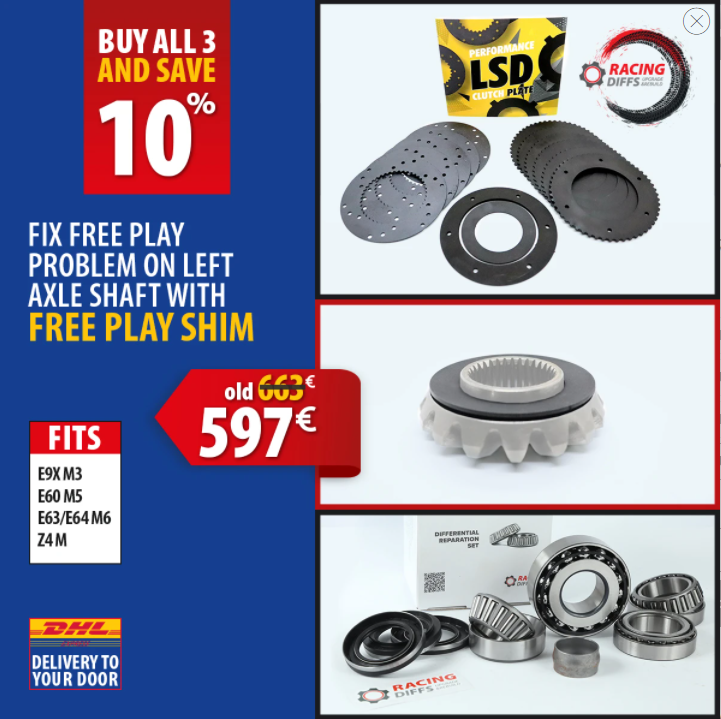

                    To reduce the play I would need to use something like https://racingdiffs.com/products/bmw...34105144672391 this right? The advanced v2 kit.
                    You said it had more plays on the right side flange, which means it is V1 diff and not V2 which will not work for yours.
                    The top pic is the clutch stack
                    The middle is shows a cup spring shim on the side-gear. I prefer to use flat shims (McMaster Carr) instead of the convenience single cup spring shim as the latter might not keep its shape long.
                    The bottom are bearings for the pinion (you might not need to do) and two carrier bearings.

                      Now things are starting to make sense! So I will need the v1 kit. And specifically that middle part?
