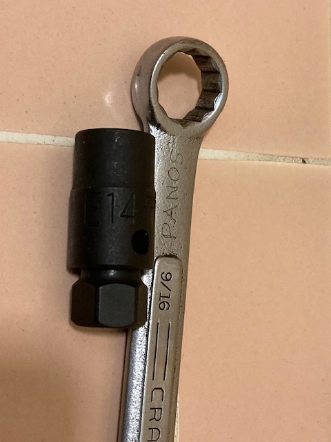

              I used a 3/8" x 9/16" adapter on the E14 socket, and a closed end 9/16 wrench and extension tube for this to break it loose. Don't back the bolt out too far or the socket/adapter will be trapped by the trunk.

                This is exactly what I did. Didn’t have enough leverage with the 9/16 tho. Double wrenched it, socket slipped and almost ruined the head.
                    keeping the socket square on the bolt is the key.
