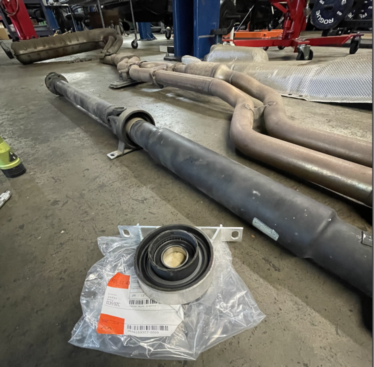

          Drive shaft support and bearing. Replace that. It solved my clunk

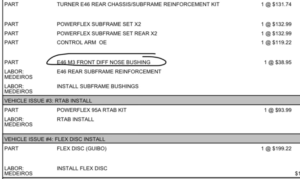

            Its a brand new front BMW diff bushing but the rears are original as they didn't look bad on inspection. Car is 2002 with 112k miles.

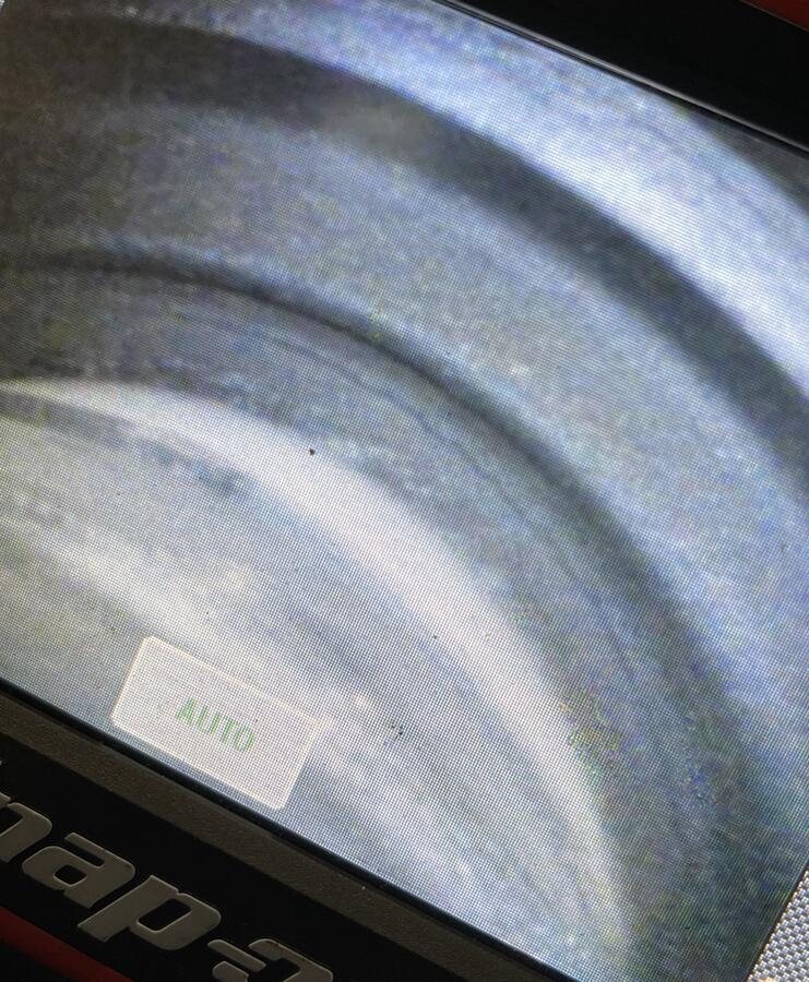

              lvm3sm46 We took a camera and it looks like there might be a crack around flex disc. Will replace and report back:
                    Click image for larger version  Name:	Screen Shot 2021-12-14 at 2.21.33 PM.jpg Views:	15 Size:	133.6 KB ID:	141759
                    You sure that’s the flex disc? Almost looks more like top side of a motor mount.

                          So we replaced the center bearing with factory part...UNFORTUNATELY, the thunk is still there. Any other ideas? Again it only happens during initial acceleration.

                              Here's the bushing setup in the rear. Diff bushings are all BMW (BRAND NEW NOSE and ORIGINAL REARS). We have video evidence that the DIFF is NOT moving under load.
