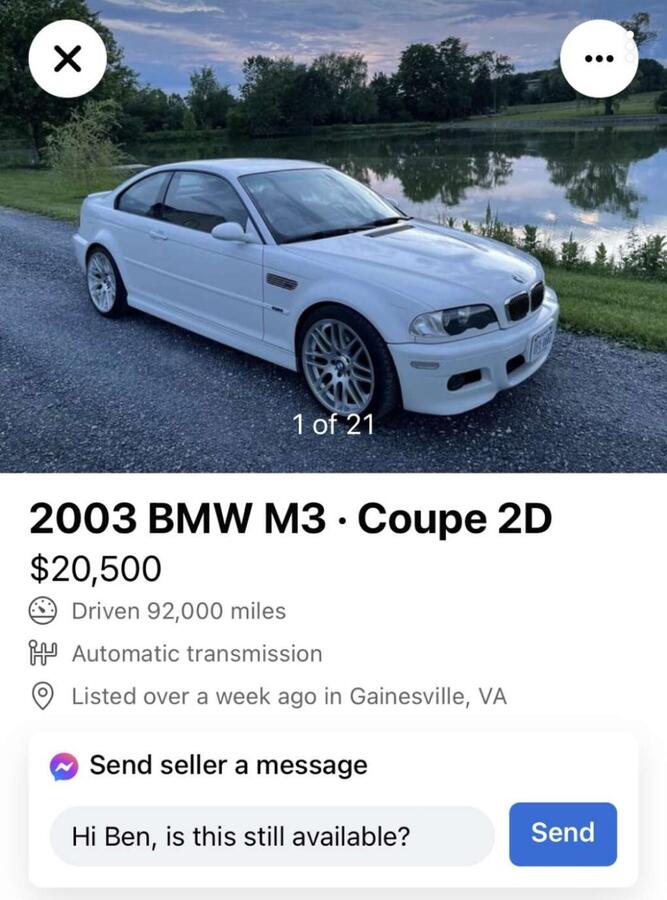

    About 2 weeks after the accident, I decided to go to Virgina to take a look at a slicktop Alpine white 03.5 that was pulled off of bring a trailer. Despite the warnings in the comments, I took the 8-hour trip there just to find a crack the size of the grand canyon in the subframe with 0 heads up at all. So if you see this car, run the other way.
    Click image for larger version  Name:	Screenshot_20210913-195044_2.jpg Views:	178 Size:	81.6 KB ID:	127626

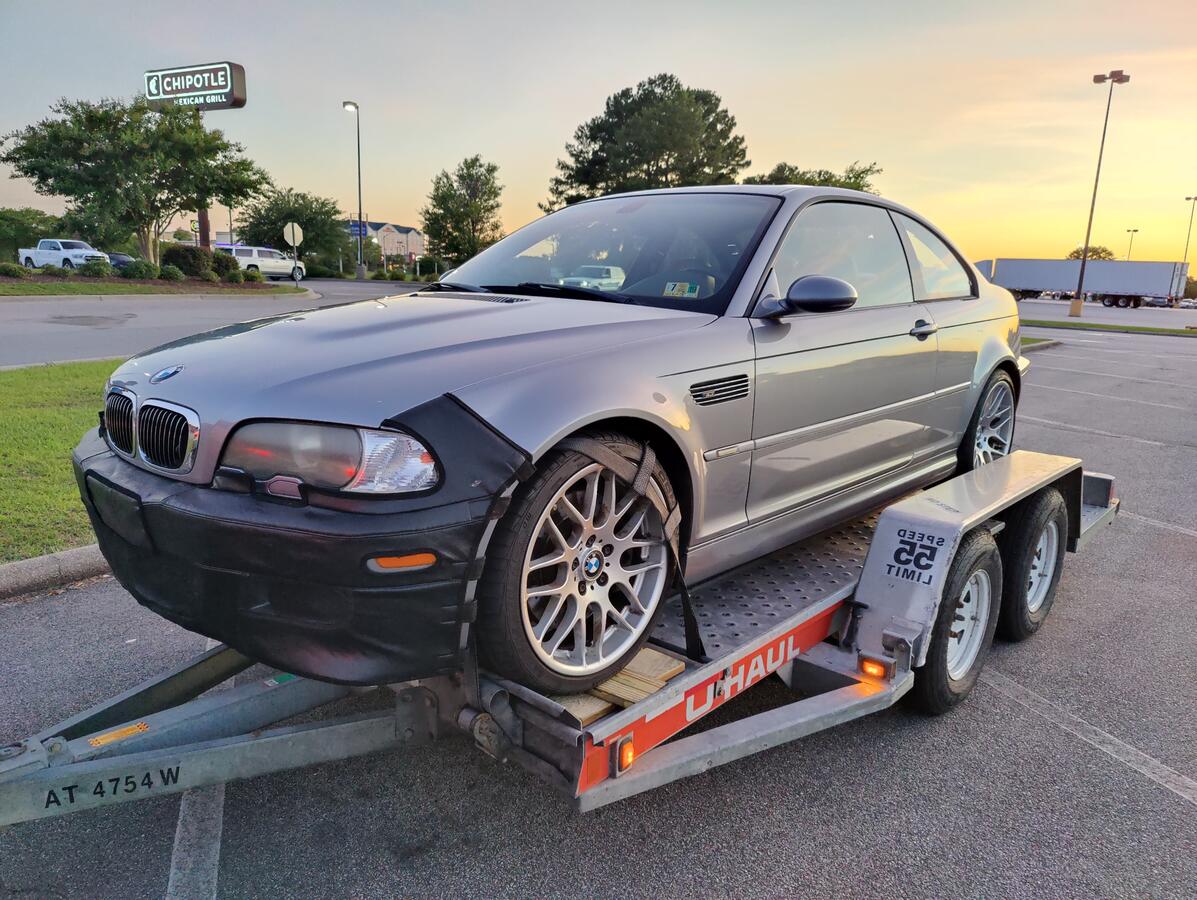

    Another week later my friend , LSBNick , sent me a 03.5 Silver Grey on Facebook Marketplace. Owner was very polite, upfront, and responsive so I decide to make the 6 hour drive to North Carolina. Car checked out (no Grand Canyon-sized cracks) and trailered it back to Georgia.
    Click image for larger version  Name:	image_25751.jpg Views:	41 Size:	184.4 KB ID:	116531

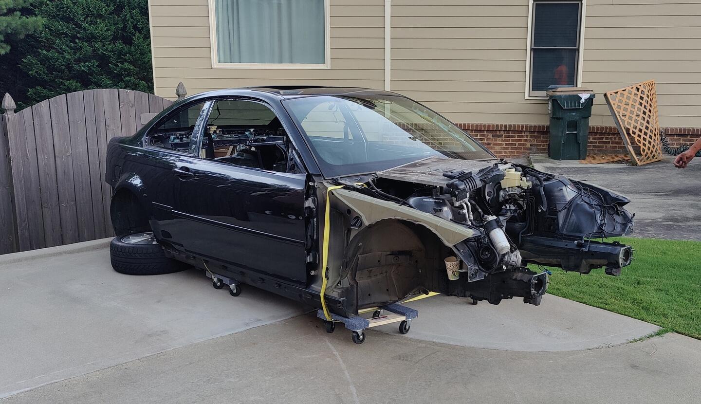

    The first course of action; part out the Carbon Black.
    Click image for larger version  Name:	IMG_20210628_212023.jpg Views:	30 Size:	172.2 KB ID:	116534
    Click image for larger version  Name:	IMG_20210630_191208_2 (1).jpg Views:	30 Size:	190.9 KB ID:	116535

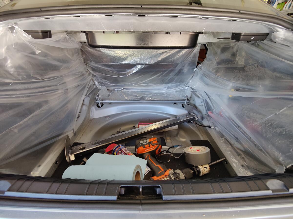

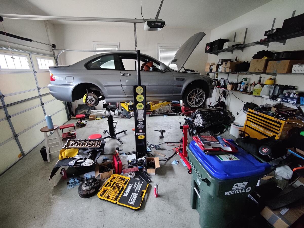

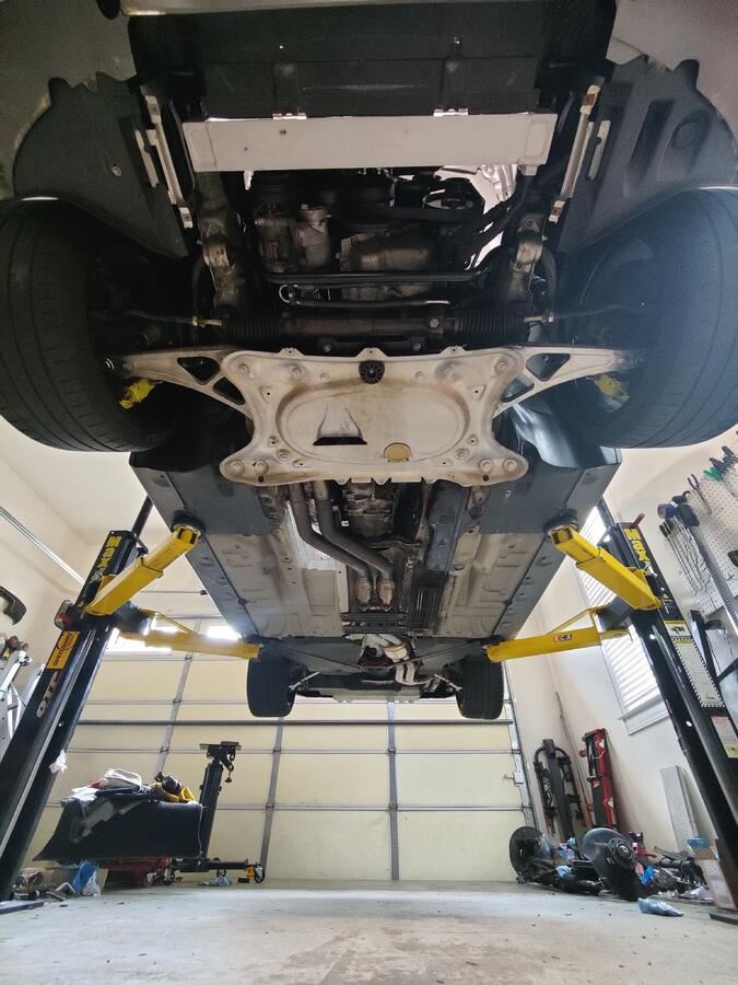

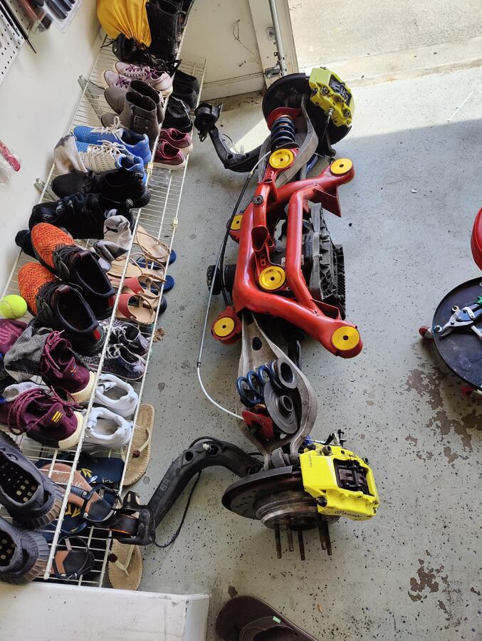

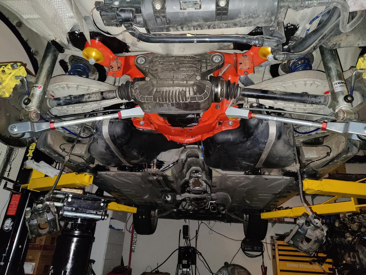

    Once the CB was torn apart, my garage/house was a complete mess and I was running out of space so I decided to sell the subframe out of the silver-grey as soon as I could to free up some space and swap in my previous subframe with all my parts already attached. Also Installed a Vince bar while I was at it.
    Click image for larger version  Name:	IMG_20210701_150624.jpg Views:	30 Size:	130.8 KB ID:	116536
    Click image for larger version  Name:	IMG_20210705_194728.jpg Views:	29 Size:	109.7 KB ID:	116537

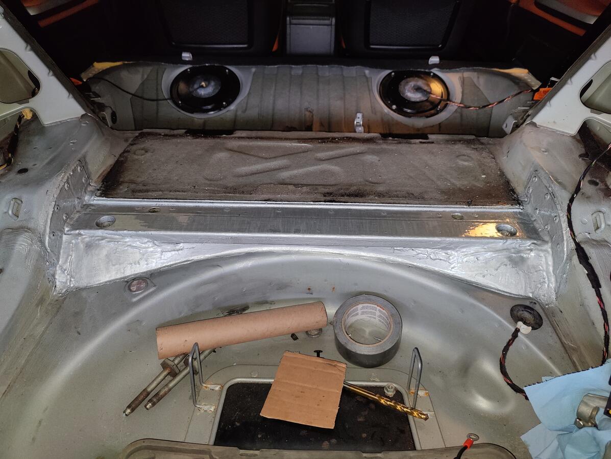

    Ignore the mismatched tails, the other amber got destroyed in the accident. Got a brand new set once all the cutting and messy stuff is complete.
    Click image for larger version  Name:	IMG_20210708_163948.jpg Views:	30 Size:	135.6 KB ID:	116538 Click image for larger version  Name:	IMG_20210712_212329.jpg Views:	30 Size:	141.4 KB ID:	116539
    Click image for larger version  Name:	IMG_20210717_221949.jpg Views:	30 Size:	215.7 KB ID:	116540

    Still an absolute mess, but definitely better than 2 weeks ago.
    Click image for larger version  Name:	IMG_20210720_145905.jpg Views:	31 Size:	184.3 KB ID:	116542

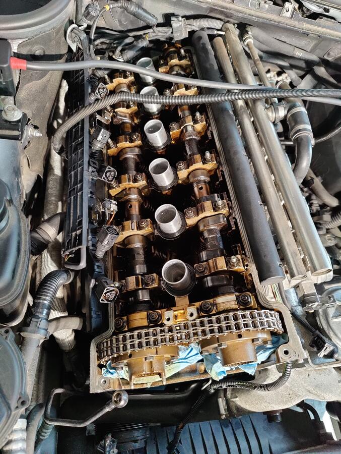

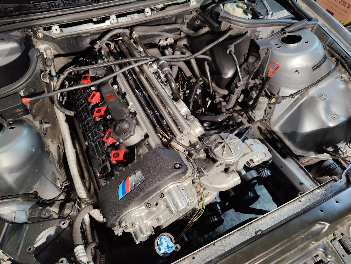

        Starting to come back together up top.
        Click image for larger version  Name:	IMG_20210725_142054.jpg Views:	59 Size:	209.1 KB ID:	117039

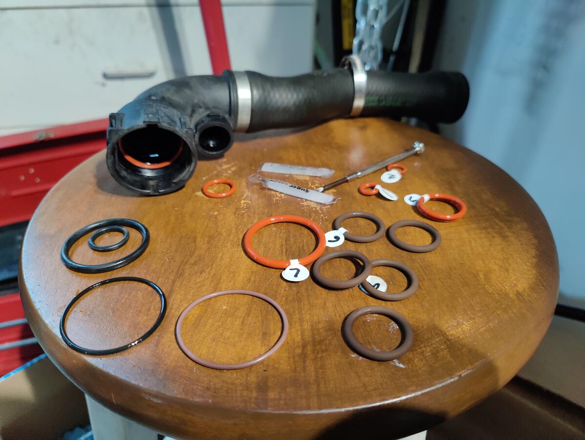

        Thanks WOLFN8TR for putting together a great O-ring kit!
        Click image for larger version  Name:	IMG_20210725_142108.jpg Views:	53 Size:	113.7 KB ID:	117040

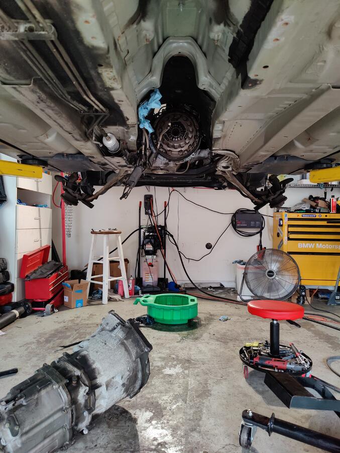

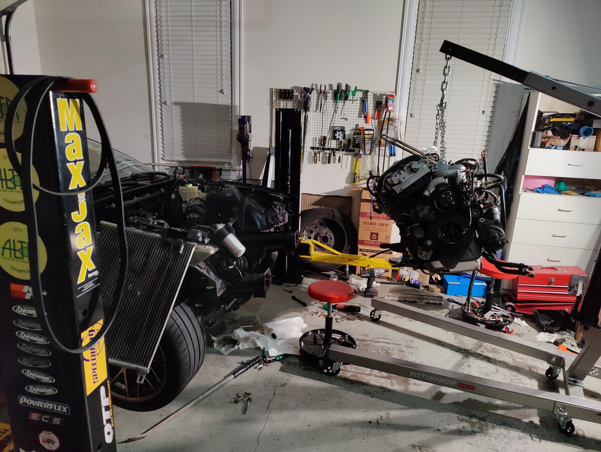

        Decided to swap in a new clutch and flywheel as well.
        Click image for larger version  Name:	IMG_20210725_193753.jpg Views:	54 Size:	111.6 KB ID:	117041

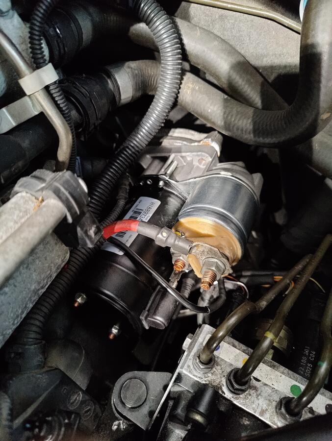

        New starter once the trans was back in.
        Click image for larger version  Name:	IMG_20210729_194821.jpg Views:	1434 Size:	97.4 KB ID:	117778

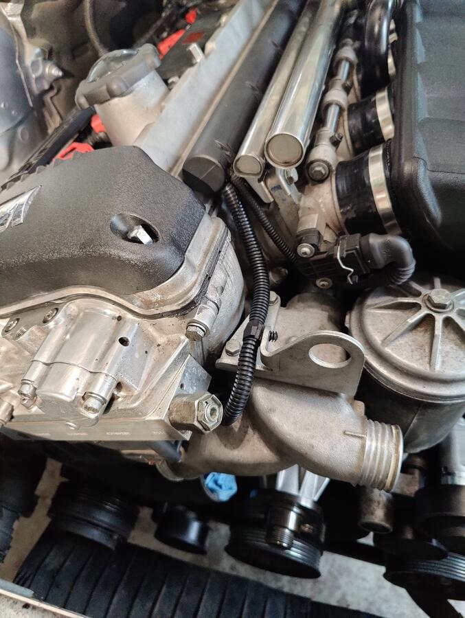

          Bought some 10mm corrugated tubing off Amazon and managed to replace the old brittle BMW tubing.
          For anyone that's interested---- https://www.amazon.com/gp/product/B0...?ie=UTF8&psc=1

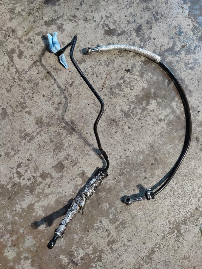

          Replaced the crusty original VANOS line with a Rouge Engineering one.

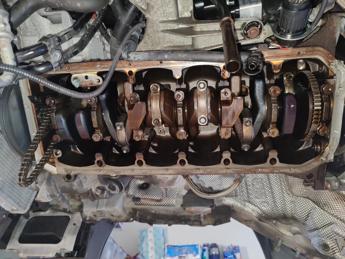

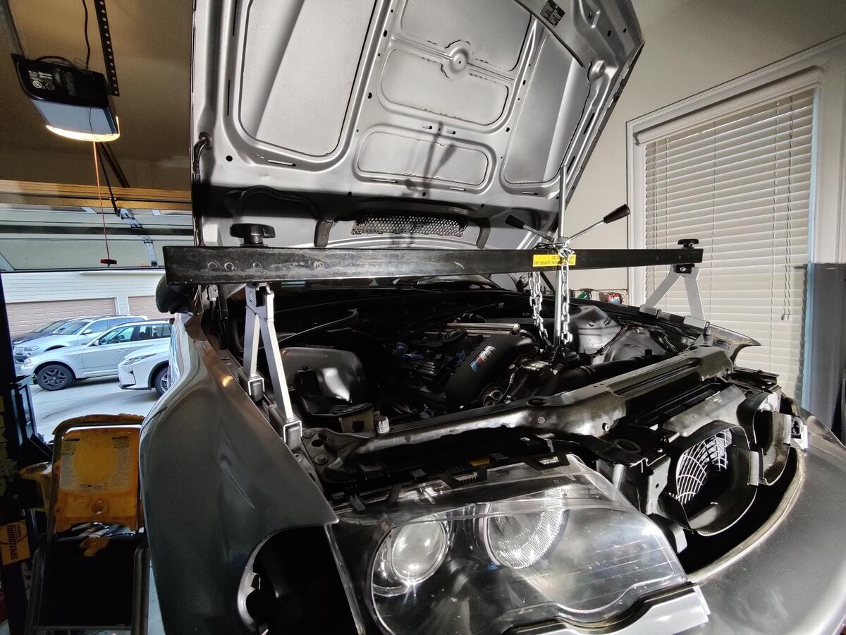

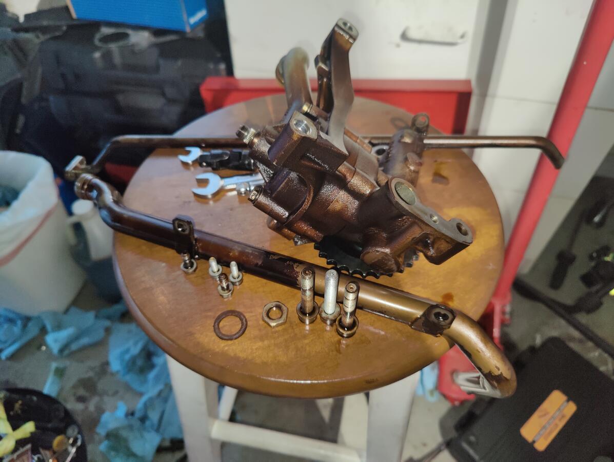

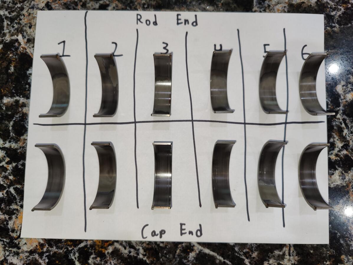

            Started changing out the rod bearings today; got half of them done. The 2003.5+ torque procedure is definitely a pain.
            Click image for larger version  Name:	IMG_20210801_202427.jpg Views:	0 Size:	106.5 KB ID:	118312
            Click image for larger version  Name:	IMG_20210801_202456.jpg Views:	9 Size:	171.1 KB ID:	118314
            Click image for larger version  Name:	image_26106.jpg Views:	1247 Size:	176.9 KB ID:	118313

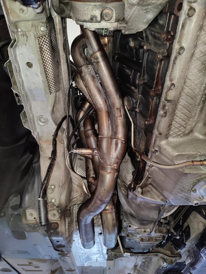

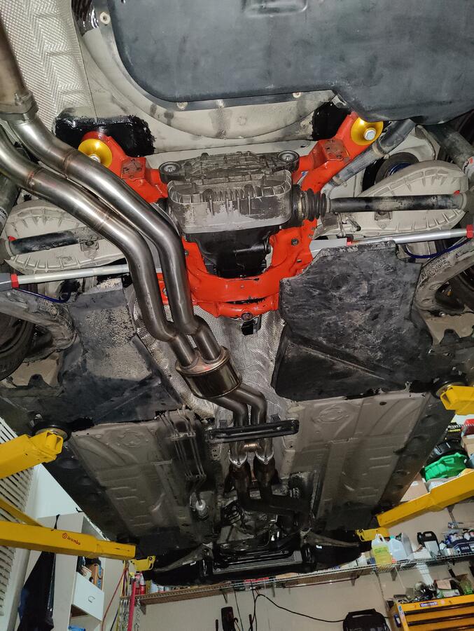

            Perfect time to install new header studs and headers while the subframe is out.
            Click image for larger version  Name:	image_26149.jpg Views:	1228 Size:	233.0 KB ID:	118531

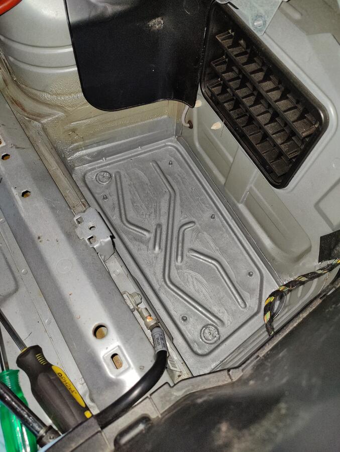

              Got rid of the surface rust in the battery tray and painted it in silver POR15.

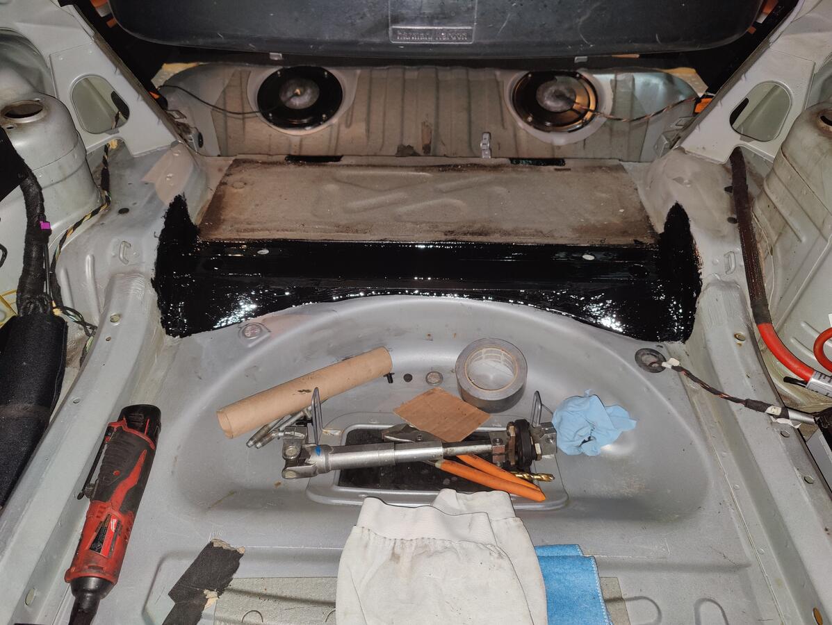

              Painted the Vince Bar in the same stuff to match the surrounding a bit better.

                      Rod bearings were in good shape, probably didn't even need to change them.

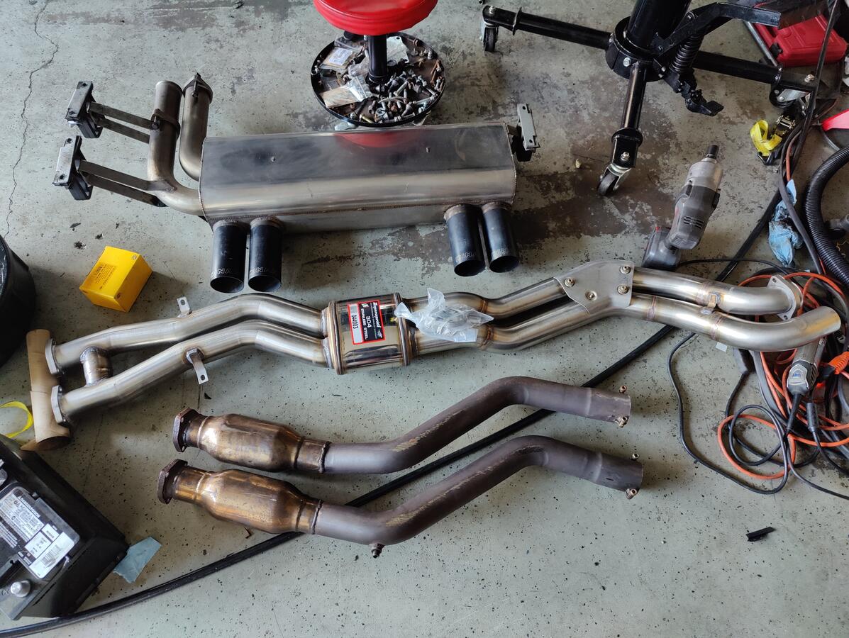

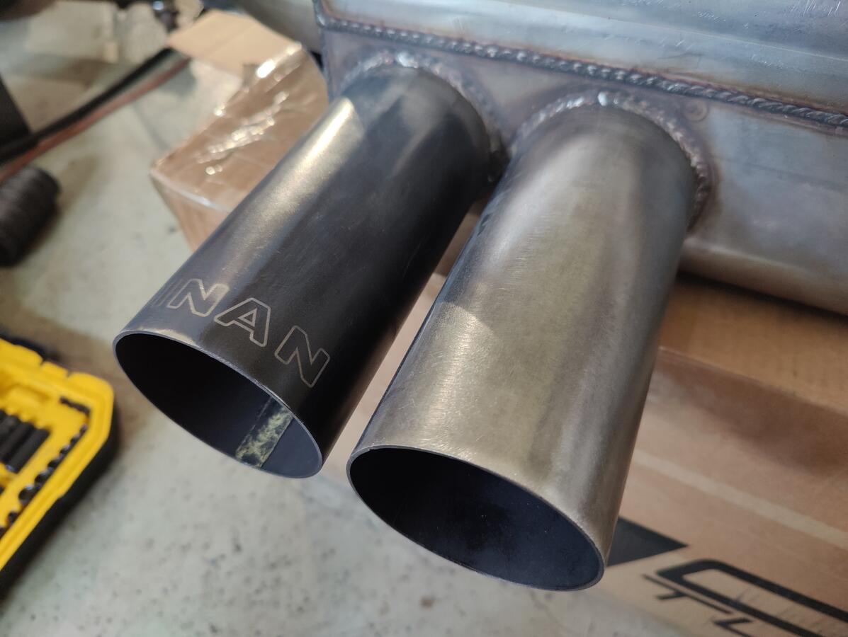

                        Personally not a fan of the Black Dinan tips so decided to sand off the paint and polish them (not polished in this pic). I don't know what Dinan used to paint these tips but it took HOURS to get the paint off.
                        Click image for larger version  Name:	IMG_20210806_142536.jpg Views:	0 Size:	80.5 KB ID:	119414
                        Got the exhaust in including the SS section 2 from the group buy (Thanks Epoustouflant ). I was a bit worried about the fitment since my SSV1s weren't perfect but the section 2 has perfect fitment.
                        Click image for larger version  Name:	IMG_20210806_220932.jpg Views:	0 Size:	119.2 KB ID:	119416
                        Took some notes from Obioban and used the Inconel bolts from the OE headers to join the section 1 and 2.
                        Click image for larger version  Name:	IMG_20210806_232527.jpg Views:	0 Size:	72.9 KB ID:	119417

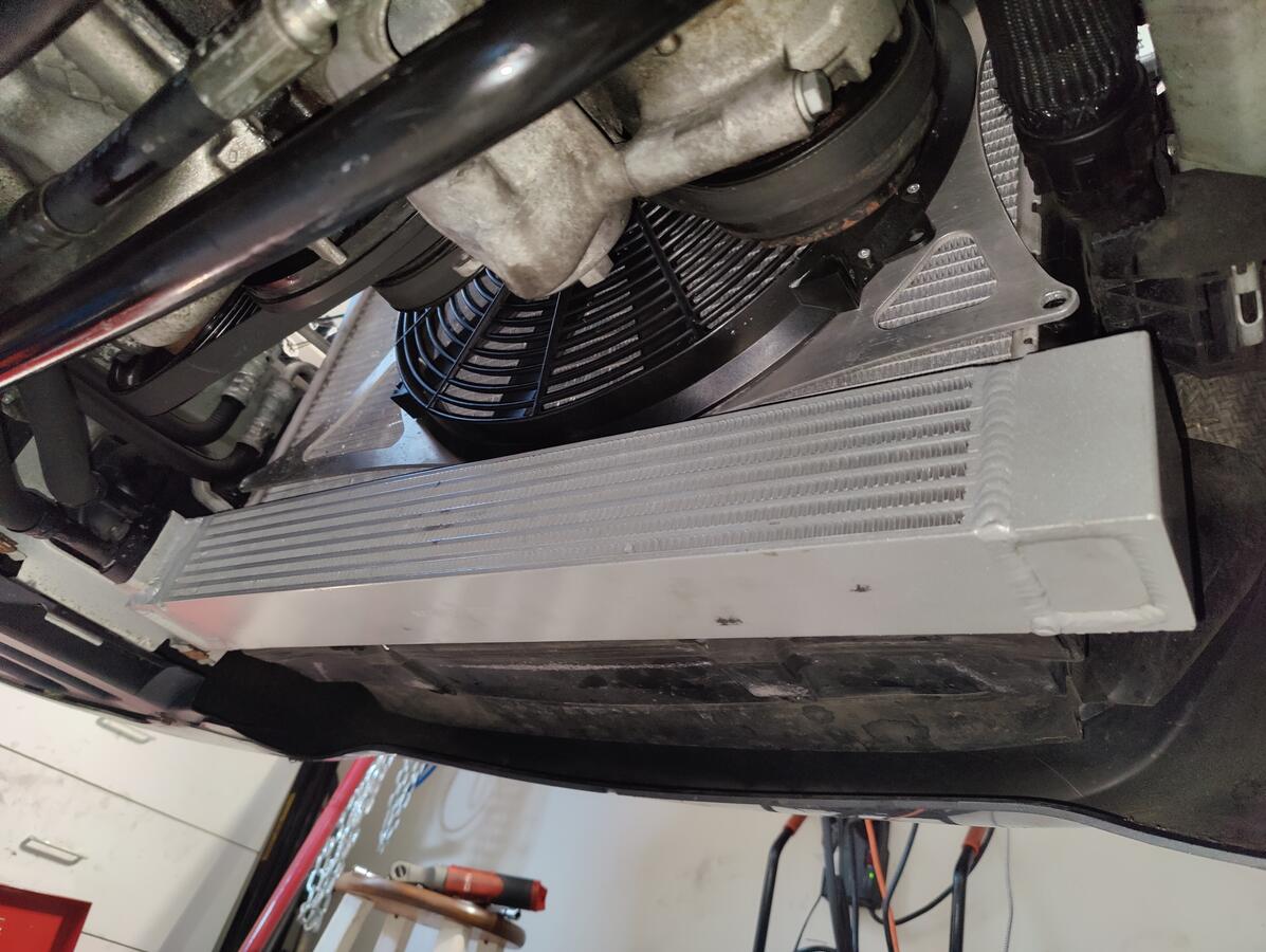

                        Also threw on a CSF oil cooler.
                        Click image for larger version  Name:	IMG_20210806_142559.jpg Views:	0 Size:	133.9 KB ID:	119415

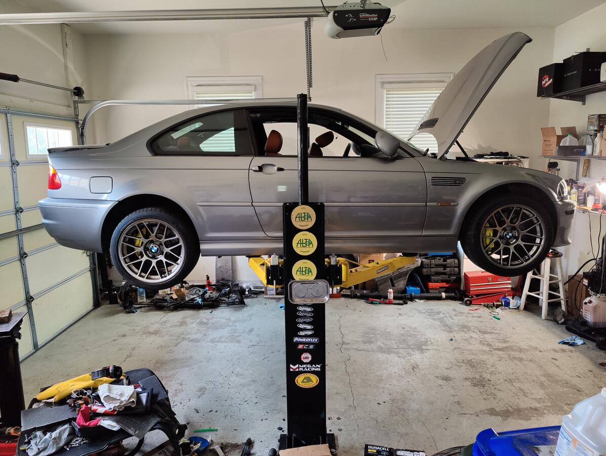

                          First time in 4 weeks with all 4 wheels on.
                          Click image for larger version  Name:	IMG_20210808_150437.jpg Views:	0 Size:	164.3 KB ID:	119667

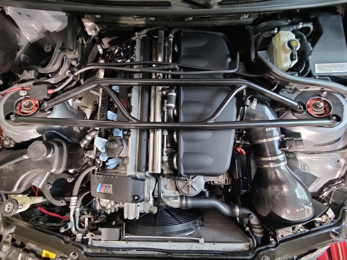

                          Got the Eventuri Intake and DMG strut bar in and started the car (after chasing a ground wire I didn't tighten all the way for 4 hours 🤦‍♂️).
                          Click image for larger version  Name:	IMG_20210808_153609.jpg Views:	0 Size:	137.4 KB ID:	119669
                          Click image for larger version  Name:	IMG_20210808_154752.jpg Views:	0 Size:	197.2 KB ID:	119670

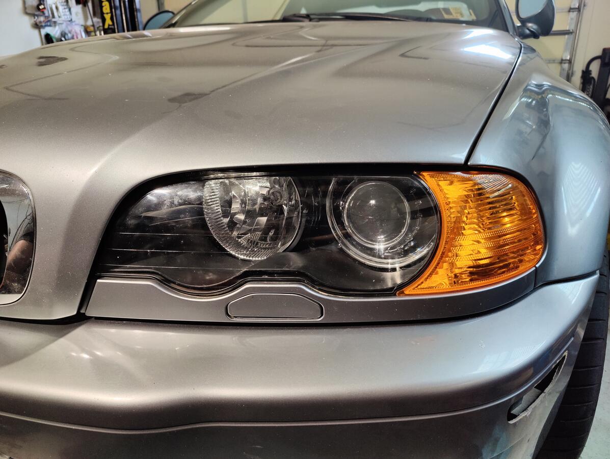

                            Swapped out the halogen lights with the bi-xenon from my CB and thew the amber corners on as well.
                            Click image for larger version  Name:	IMG_20210810_140422.jpg Views:	0 Size:	133.0 KB ID:	120157
                            Finally took a drive around my neighborhood. Need to get emissions done next and then registration.

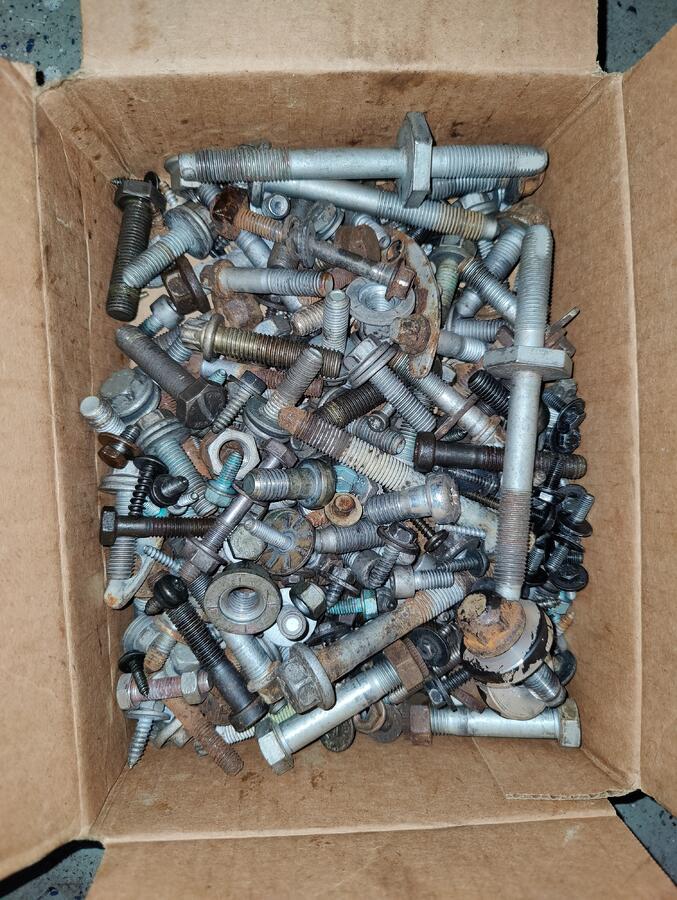

                            Guess I'll never run out of extra bolts now.

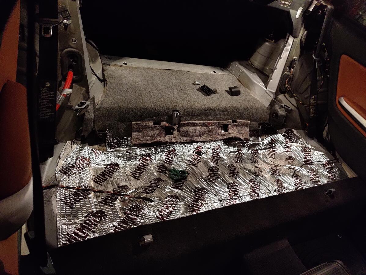

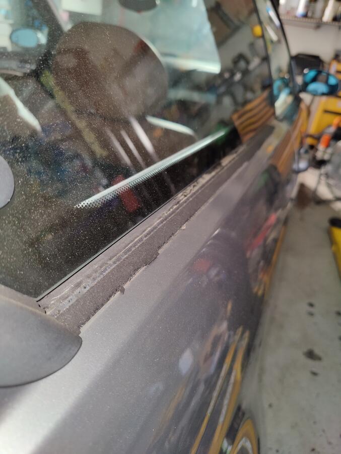

                            Removed all the brittle OE sound deadening and replaced it with some kilmat.

                              2.5" all the way with the dinan must be really tame. It was for me, and I had the louder stock sect 2 at the time (everything else the same)
                              I also, painstakingly, removed the black coating.
