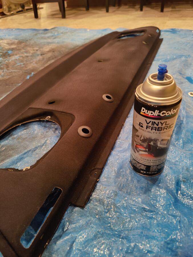

        Attempting to redye the rear deck.

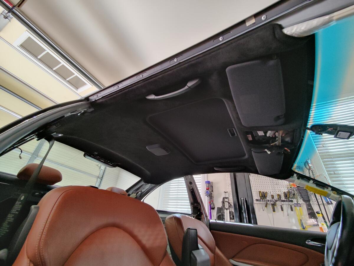

          Once I got back home, I installed a suede headliner and the redyed deck.
          Click image for larger version  Name:	IMG_20210815_172603.jpg Views:	0 Size:	127.0 KB ID:	121002

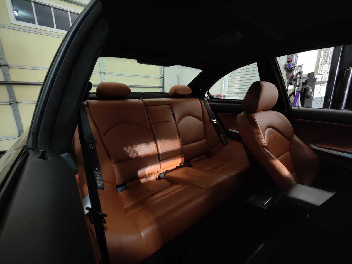

            Finished installing the suede pillars and rear seats.

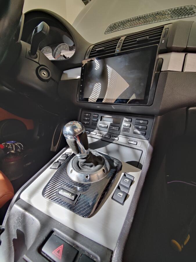

            Took out the Eonon unit to replace with my previous Avin unit.

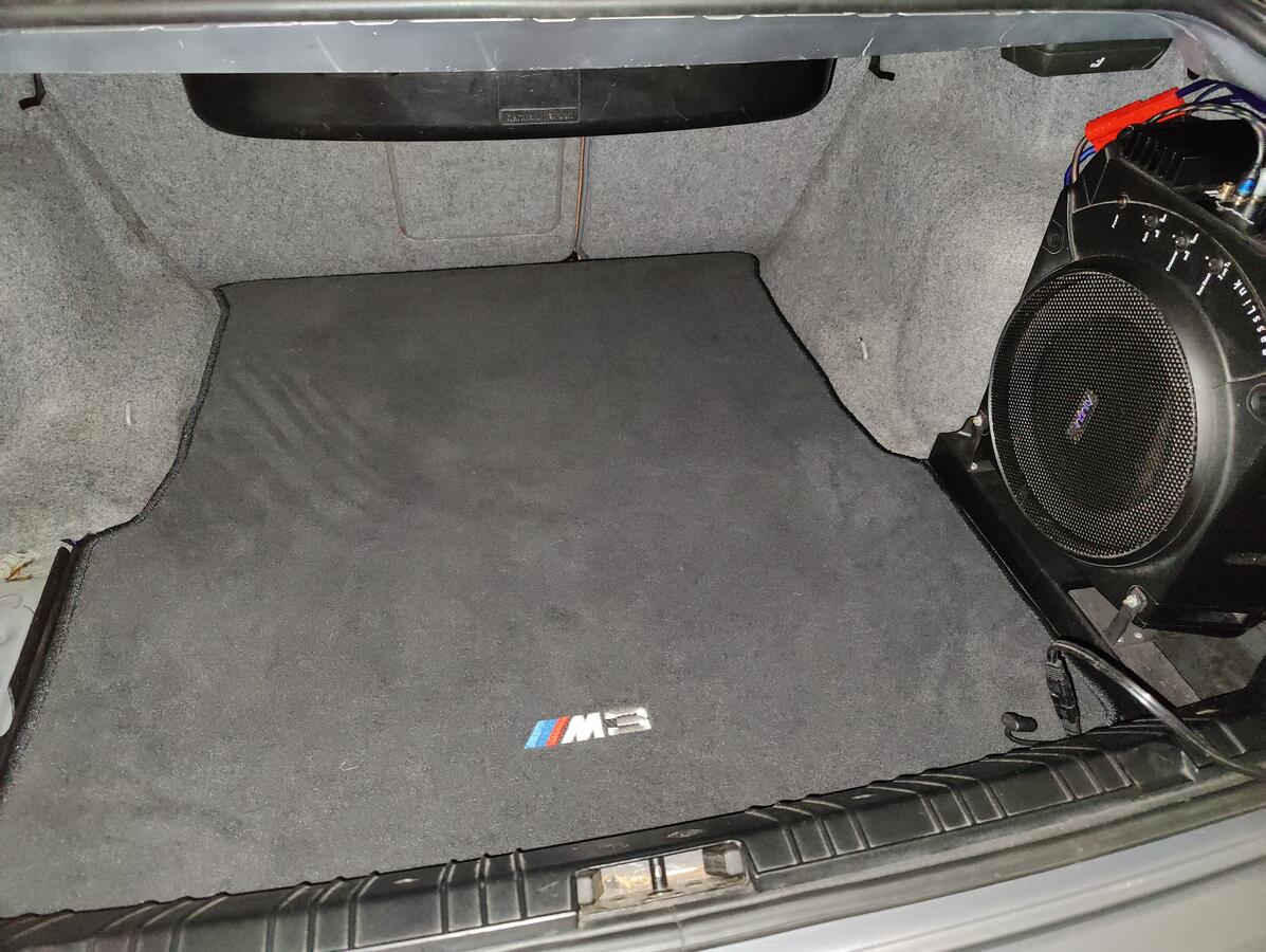

            Buttoned up the trunk area too and threw in my previous basslink. Let's see if it survived the crash impact.

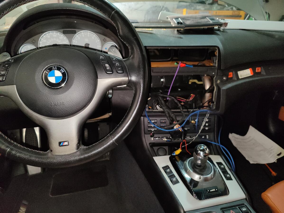

              Avin head unit and HVAC relocation bracket in.

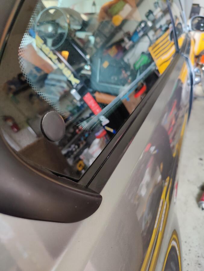

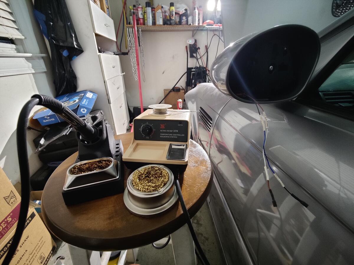

              Had to extend the mirror heater wires so they would reach the plug points on the euro blind spot mirrors.

                      The car is coming along great man. I am attempting to dye the rear deck as well over the weekend and I am trying to locate the diy. Can you share some does and don’ts like how many coats did you apply, wait time between coats etc.?
                      -Singh
                      2004 e46 ///3 | Laguna Seca Blue | Black Leather | 6MT | Coupe | OEM+​
                      BBS RC | Supersprint | Ground Control | Besian | Euro
                        It was a bit of a pain honestly, wish I just rewrapped it instead. You are supposed to brush it after spraying it so that it maintains the "cloth" like texture. If you don't, it becomes hard and rough feeling. The issue was, no matter how many coats I put on, the brush would make it a bit lighter each pass. It took more than an entire can just for the rear deck to finally be black again.
                          Got it, thanks for the tip.
