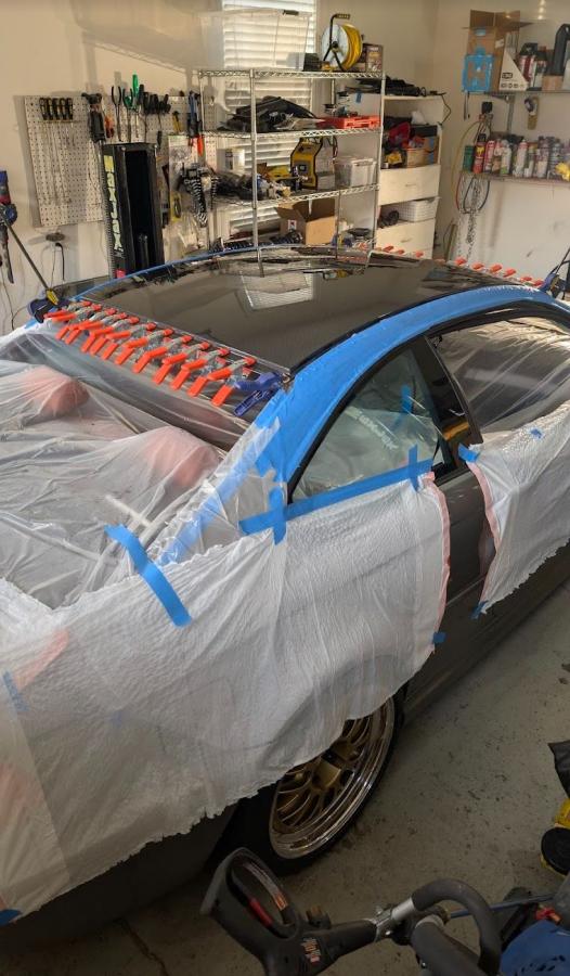

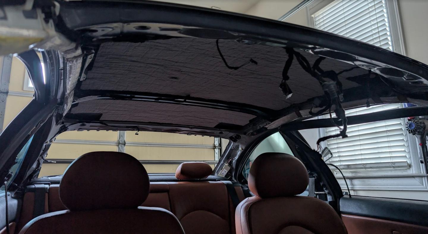

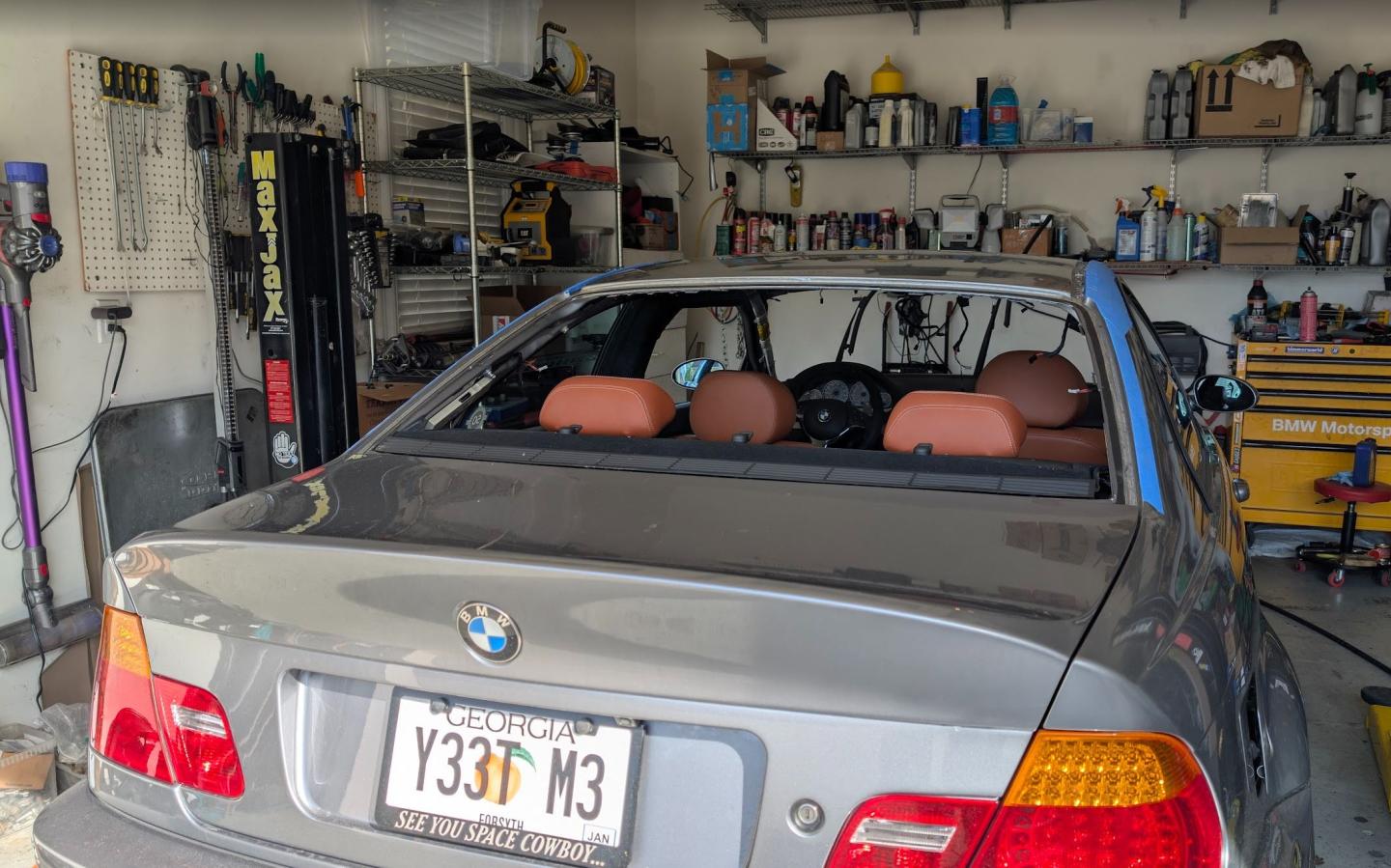

        It has been basically a year since I got the Karbonius roof but I finally decided to just do it.
        Had a local Auto glass installer come by to uninstall the windshields.
        Click image for larger version  Name:	cf roof 1.jpg Views:	30 Size:	182.3 KB ID:	286695

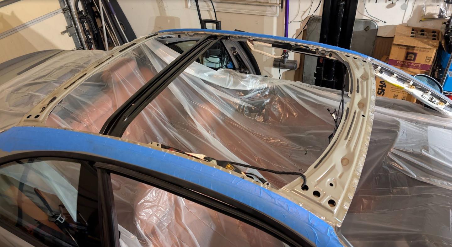

        Drilling out the spot welds was tedious but wasn't all that hard after I got a proper spot weld drill. Definitely recommend the Blair bits over anything else.
        Click image for larger version  Name:	cf roof 2.jpg Views:	28 Size:	53.5 KB ID:	286696
        Click image for larger version  Name:	cf roof 3.jpg Views:	28 Size:	58.7 KB ID:	286697
        Click image for larger version  Name:	cf roof 4.jpg Views:	28 Size:	161.2 KB ID:	286698

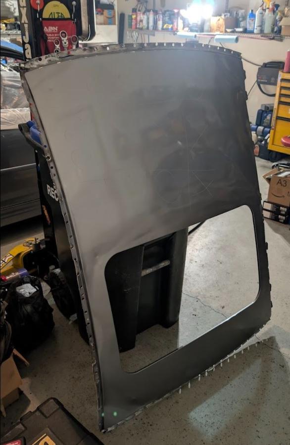

        I ended up just riveting the cross brace in.
        Click image for larger version  Name:	cf roof 5.jpg Views:	29 Size:	163.1 KB ID:	286699

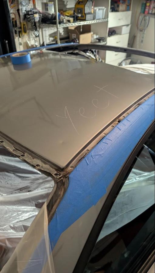

        Used some 3M panel bond and a metric ton of cheap Amazon clamps to hold it all down. Finished it with some Sikaflex on the edges.
        Click image for larger version  Name:	cf roof 6.jpg Views:	29 Size:	77.7 KB ID:	286700

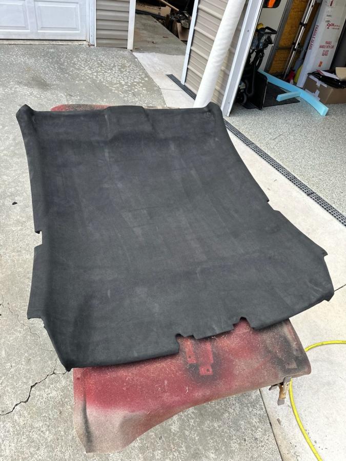

        OE slicktop sound insulation stuck on.
        Click image for larger version  Name:	cf roof 8.jpg Views:	12 Size:	133.0 KB ID:	286877

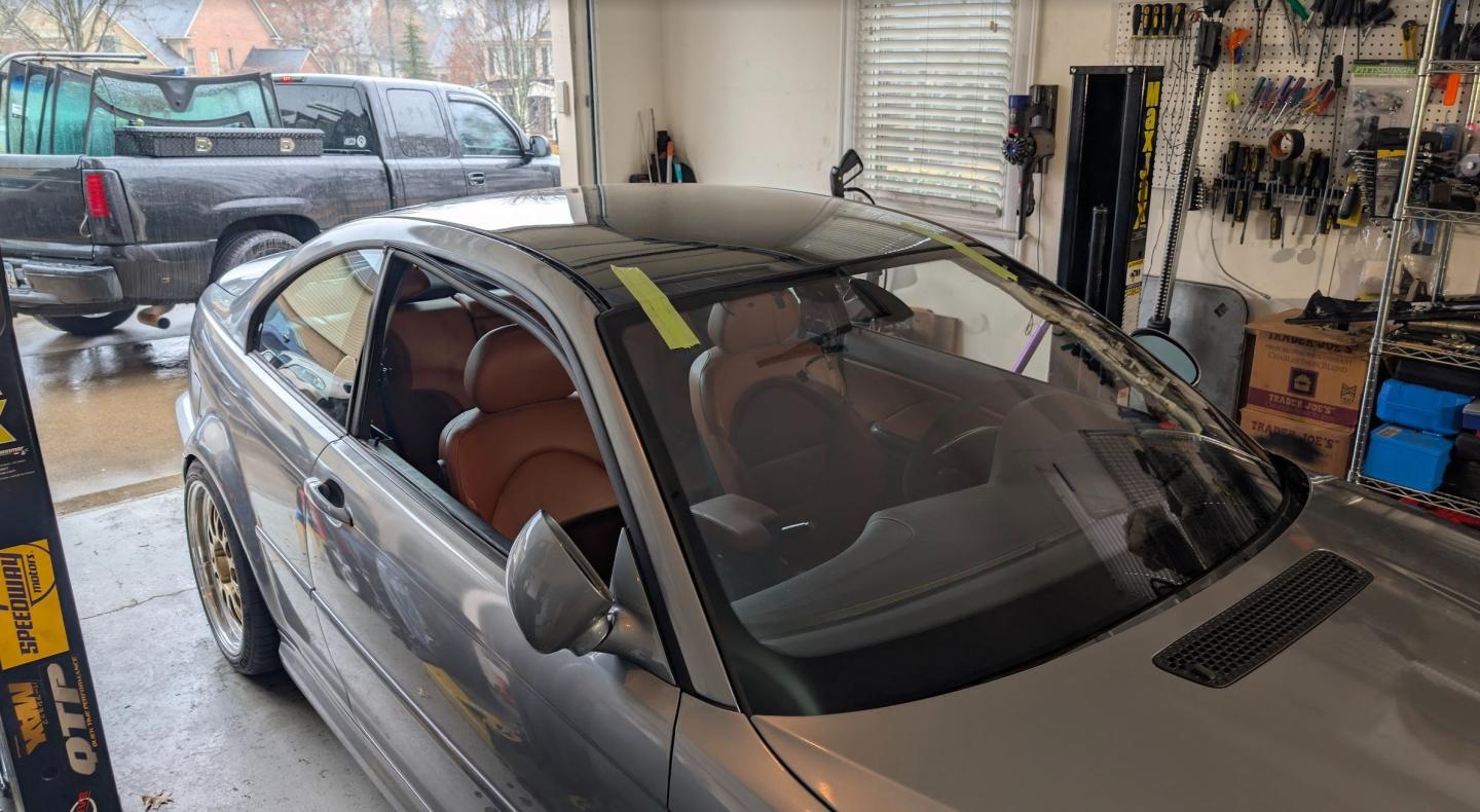

        DNA Auto Glass came by again today to install a new infrared windshield and reinstall the original rear.
        Click image for larger version  Name:	cf roof 7.jpg Views:	29 Size:	164.3 KB ID:	286701
        Just need to have the rails painted black and the new headliner installed and it should be all done. Just want to make sure the roof is water proof before all that goes in.
        Click image for larger version  Name:	IMG_20241125_123408.jpg Views:	27 Size:	100.3 KB ID:	286702

                      Car is finished up now, headliner and rails back in.
                      Click image for larger version  Name:	cf roof 9.jpg Views:	8 Size:	83.2 KB ID:	287894
                      Click image for larger version  Name:	cf roof 10.jpg Views:	8 Size:	73.4 KB ID:	287895

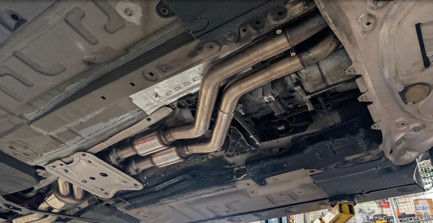

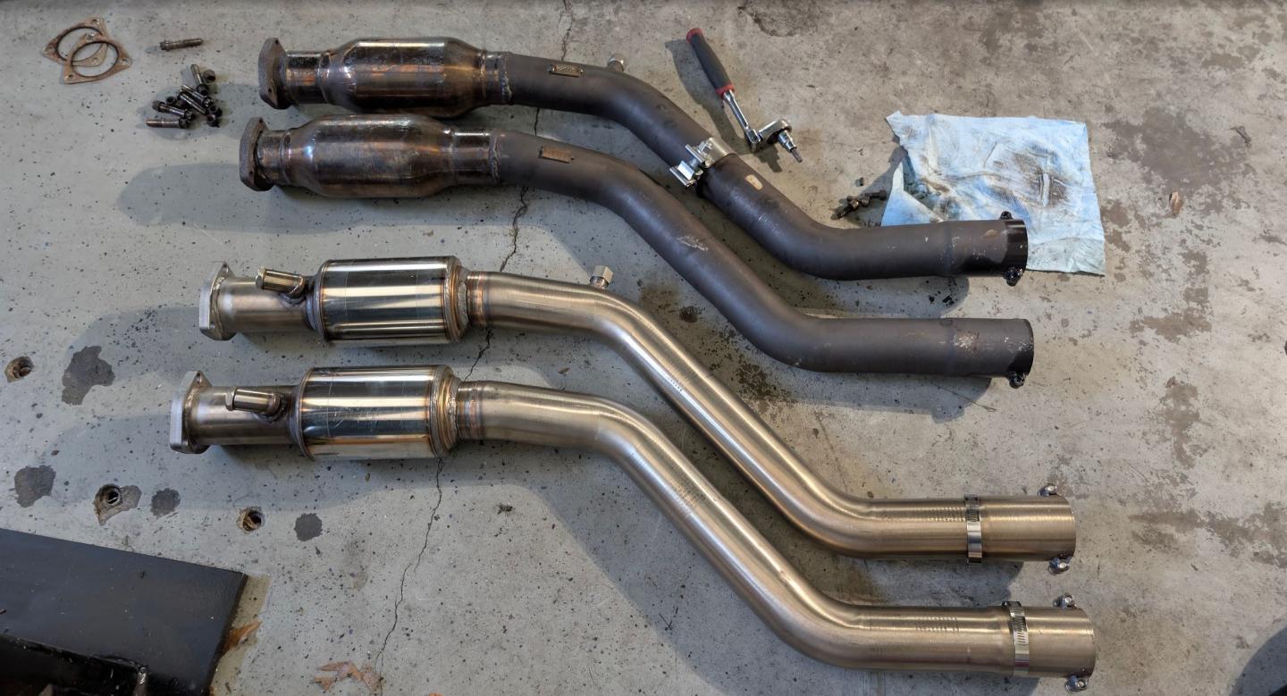

                            It has been over a year since my last update here. There hasn't been much done to the car in that span but I have replaced my old modified resonated SS section 1 with an original SS equivalent piece.
                            Sounds exactly the same but its nice to have the original SS piece. Thank you davidinnyc .

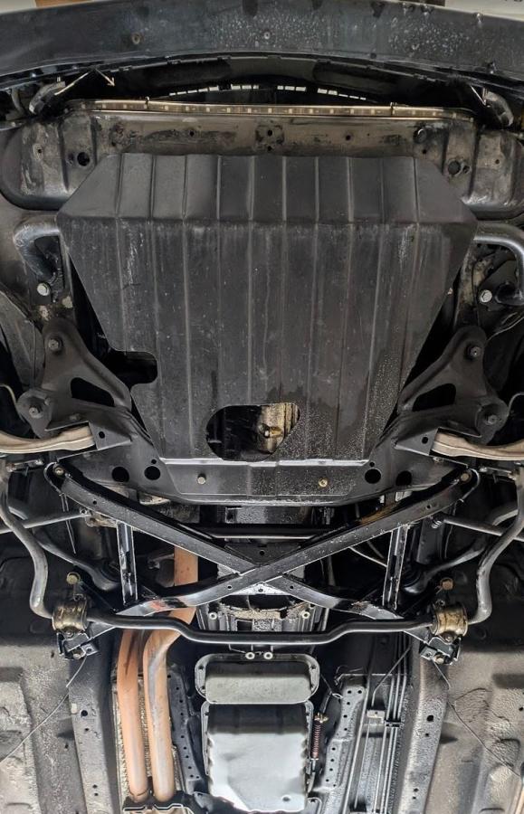

                            As for the E34, I have managed to find an OEM South African market skid plate and E31 X-brace which has really stiffened up the front of the car.
