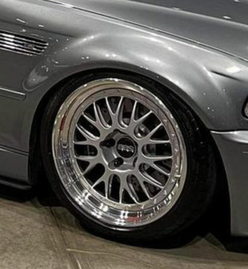

      Malloy 's car had me convinced I needed E88s....

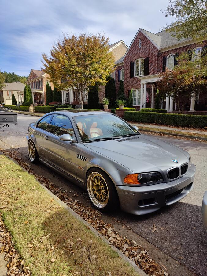

        Yes, I can't wait to see gold on your SGM! I considered gold but went with silver - it just works for my car.

          I actually had my friend edit one of your pictures to visualize what my car would look like with gold E88s.
          Click image for larger version  Name:	received_1450734975305873.jpeg Views:	0 Size:	139.6 KB ID:	127780

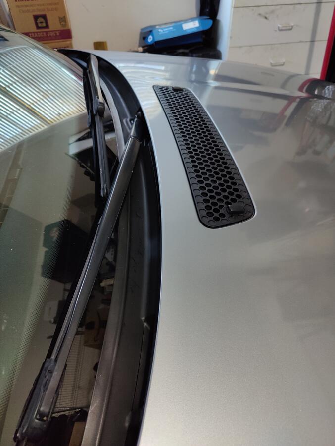

            Haven't had all that much time to work on the car since school started up again but I did replace the windshield cowl and hood vent.
            Click image for larger version  Name:	IMG_20210924_184205.jpg Views:	50 Size:	60.4 KB ID:	128531

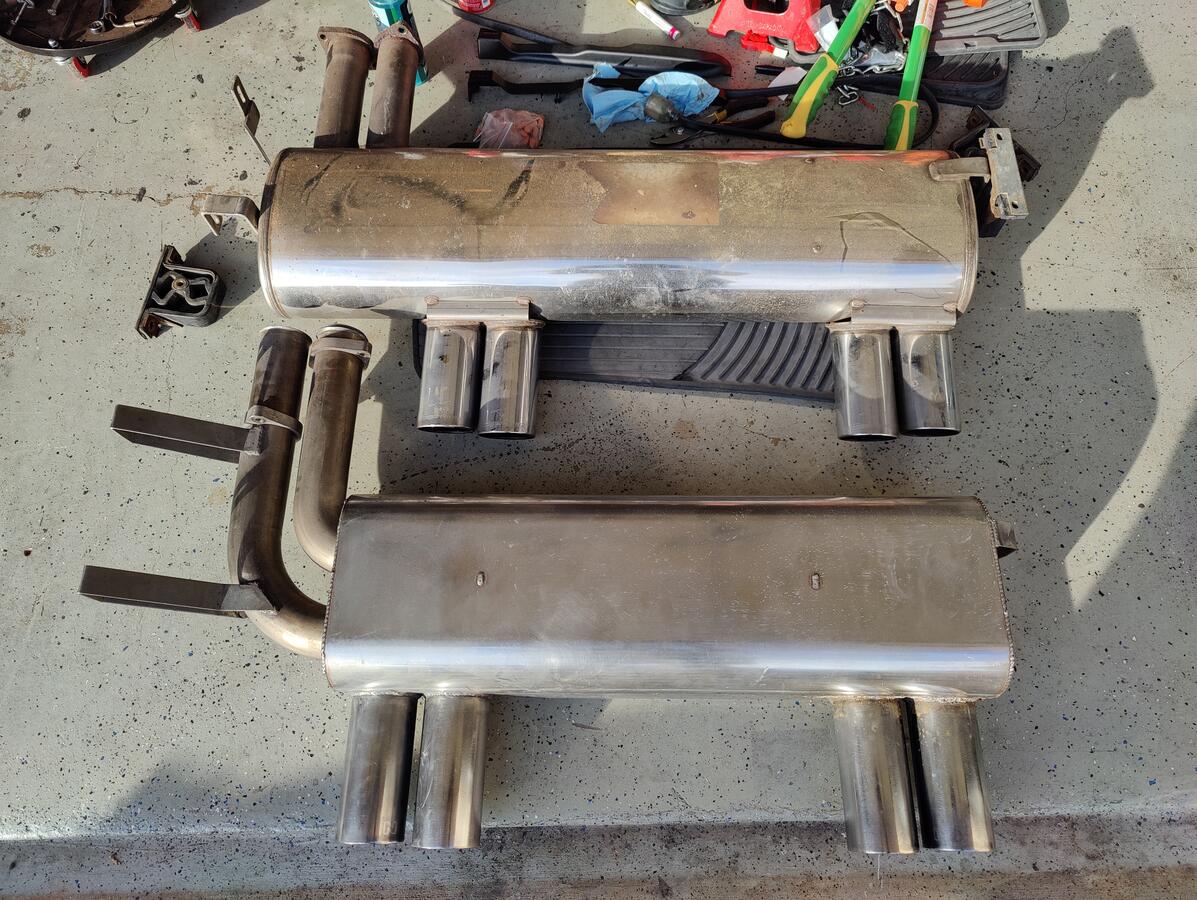

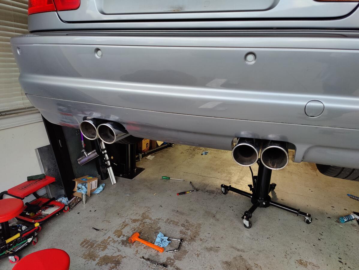

              Swapped out my Dinan muffler for a SuperSprint Street. The Dinan started to drone with my setup and I absolutely hated it.

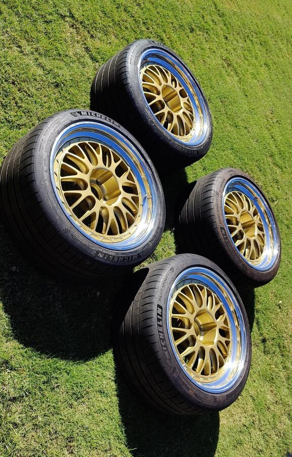

                Finally.....

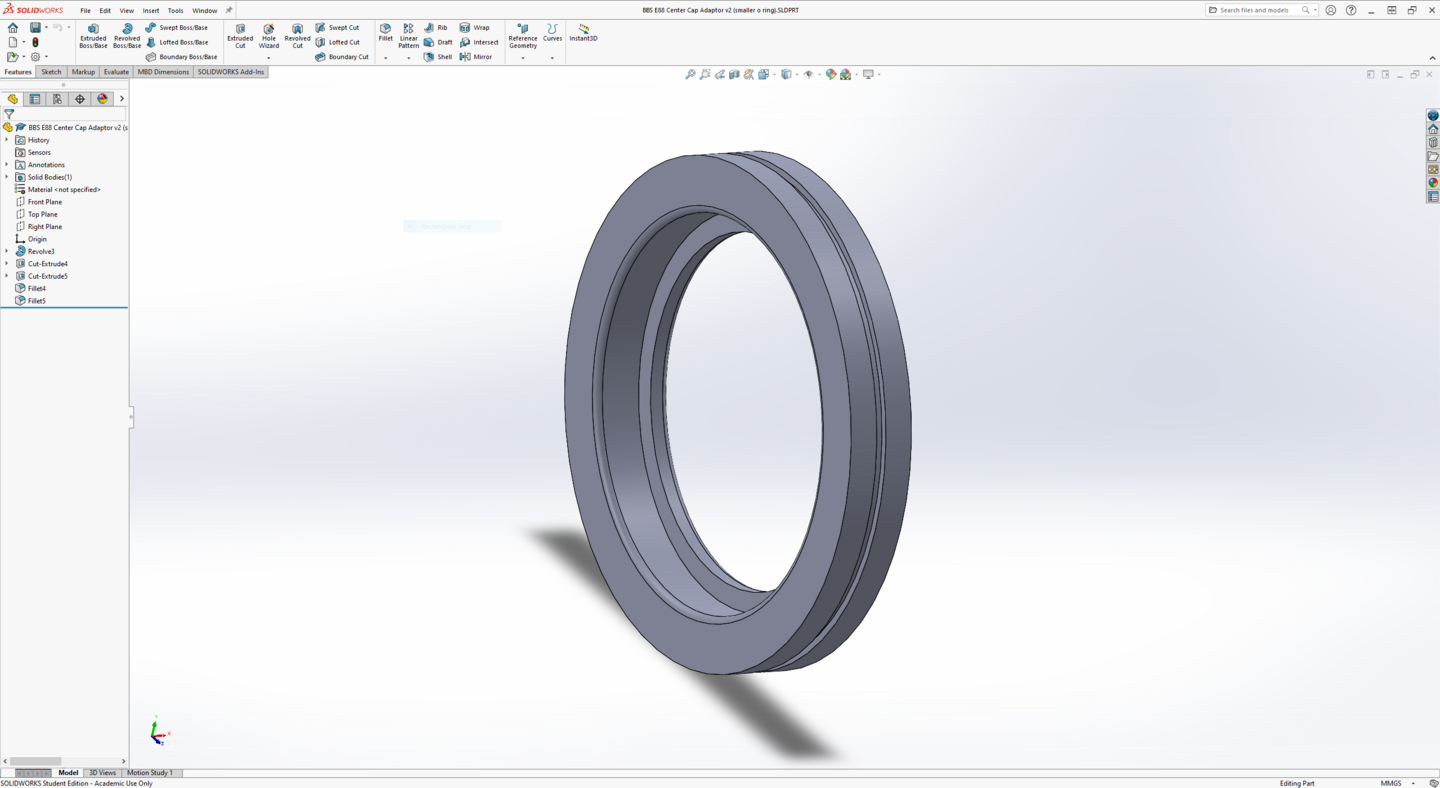

                        I have always been a huge fan of the race pocket E88s over the standard center cap versions; my only gripe was that the race pocket E88s had no provisions for center caps. I have seen some pictures of people running caps on race pocket E88s on Instagram but could never find the adaptors online, so I decided to make my own.
                        Credit: @danny332m
                        Click image for larger version  Name:	Screenshot_20211027-233246.jpg Views:	0 Size:	72.7 KB ID:	134934
                        Used Solidworks to design a 72mm to 80mm BBS cap adaptor. The groove on the outside will house an O-ring as a source of friction between the wheel bore and adaptor to hold it in. Will 3D print them soon to test.
                        Click image for larger version  Name:	image_29124.png Views:	4 Size:	360.6 KB ID:	134935
                        These should just slot into the adaptor.
                        Click image for larger version  Name:	image_29125.jpg Views:	3 Size:	81.5 KB ID:	134936

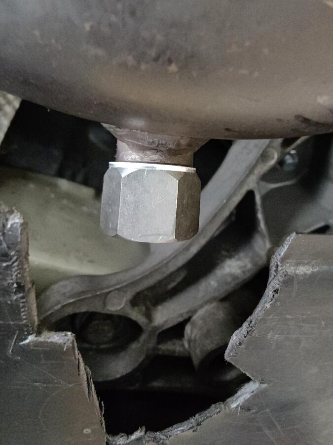

                              Also thanks jbfrancis3 for the EGT block off. If anyone has an EGT block off installed on their SS section 1, I highly suggest you throw some Loctite on it.
                              Click image for larger version  Name:	IMG_20211105_165345.jpg Views:	0 Size:	60.8 KB ID:	136152
