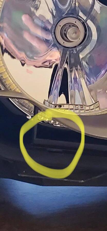

                just to jump in here...maybe not the same issue, but when i installed my angel eyes, my black cover was pinching/blocking the lower portion of the AE's. reaching out to the manufacturer, he told me to take the black housing and instead of clipping hte bottom portion where it's supposed to clip, move the clip below that...almost like stretching the black cover. that fixed the problem 100% and hte black cover went in and did not hit the AE's. i'm attaching a picture of my issue and where we had to move it. by pushing that clip down, it cleared the AE's.

                  If I remember correctly, i had to do something similar when I installed the AEs on the OEM projectors lol. I believe this may be a separate issue because when you do the retrofit and don't grind down the bosses enough, the projector sticks out another half an inch or so.
