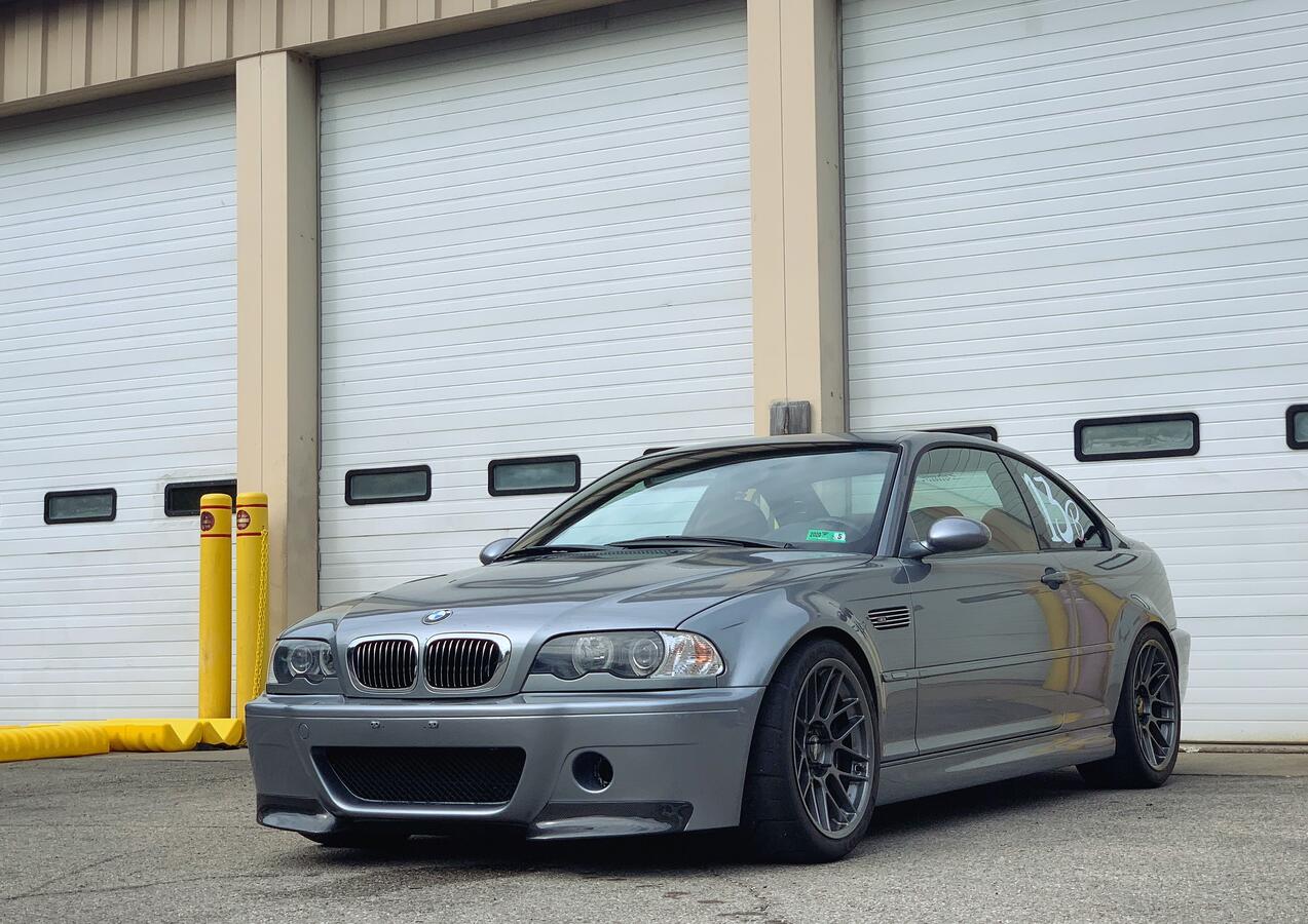

            I have swapped stock hats attached to ohlins coilovers and I'm happy enough with the resultsClick image for larger version Name:	IMG_0923.jpg Views:	70 Size:	172.3 KB ID:	145459
            Whats the spec of the wheels? Looks like youre pretty stock height for ohlins, im trying to fit 9.5 + 22
