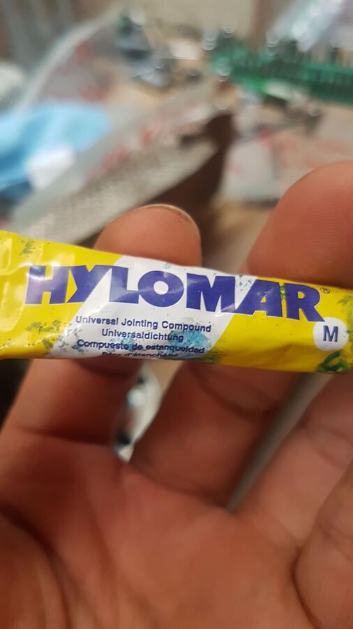

    I purchased the Inner CV boot repair kit from fcpeuro to replace the boot for my 2005 e46 M3,the kit comes with small yellow tube written on it " universal jointing compound ", where should I apply this blue sticky compound??

        I contact Fcpeuro and there is there replay
        Hylomar sealant and goes on the caps and you can also add a little bit on the boot lips too.
          Like where the metal meets I suppose
